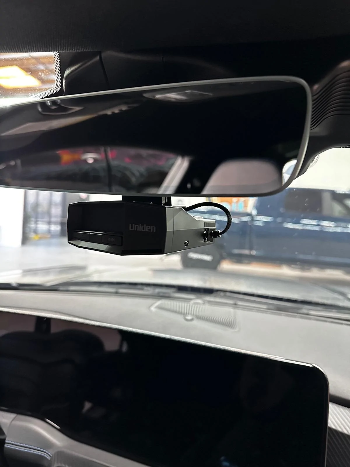

So I bought a converter for the usb Port by the mirror to hopefully power my radar detector.
it does power but it seems like it doesn’t shut off with accessory power.
does anyone have a work around? Potentially looking to hardwire it via the mirror tap
any help is appreciated!

I think someone on here timed how long there was power to the mirror USB after shutting down Accy mode and determined it to be a few min., then shut off.

I don't know what the default accessory power off is on the Mustang, but on my '21 F150, it's 4500 seconds (1 hr 15 min). I used FORSCAN to change it to 30 seconds.
@Tuxonspeed - Get the wiretap that goes into the rain sensor that's under the cover on the windshield (in the post that @nitepony linked to a couple posts ago). It shuts down as soon as you shut the ignition off. I have a Uniden R8 and I found one for like $12. Works great with my Blendmount setup.
