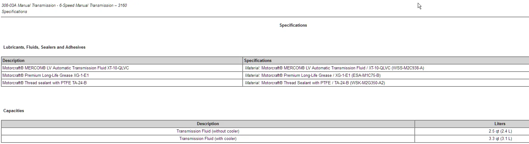

Does anyone know what fluid Ford is putting in these gearboxes at the factory? I think they are coming to Ford dry because they have to hook up the cooler lines.
68
2,085
3,071
according to Ford, it should be coming with 3.3 quarts of Mercon LV ATF
S650 Mustang Tremec Fluid 1705667663225
