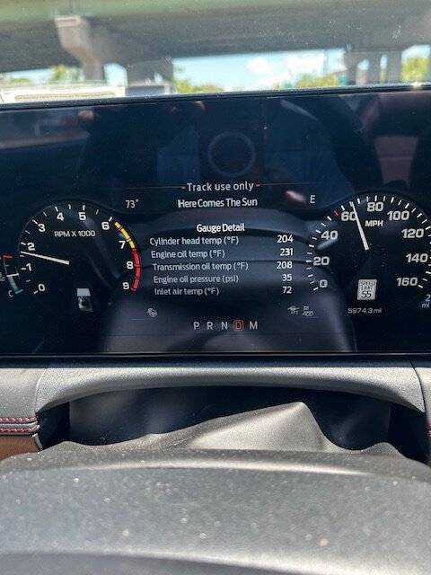

So I'm considering installing the Ford Oil Cooler kit because the Oil Temps are a bit troublesome to me. GT, Auto, 401a, Premium, cruising at 65 mph, no pulls, no A/C, ambient temperature was about 67 degrees F... This is what I'm seeing.. I'm using PUP and a Motorcraft filter and I always seems to be running 230-235. Would the Ford oil cooler help? What would be a fair price for a Mustang specialty shop to install? Thoughts? TIA...

it would help but you have to remember there is no real oil temp sensor its an algorithm
there have been some reports that adding the cooler to non oil cooler cars the temp does not lower as it does not know you added an oil cooler there maybe a way to update that in forscan or something but idk

the oil will be physically cooler but the computer won’t show the updated temps because the temps are estimated there is no oil temp sensor. I’ve added and enabled the oil cooler in forscan and still no luck getting the temps to show lower. The performance packs have a different pcm strategy. @Cool66 and I have been trying to figure this out for a little bit now but still no luck.
