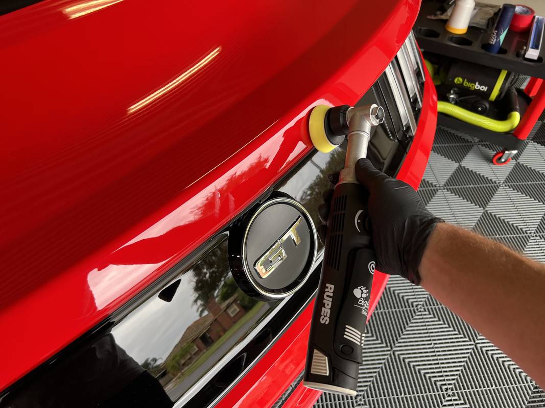

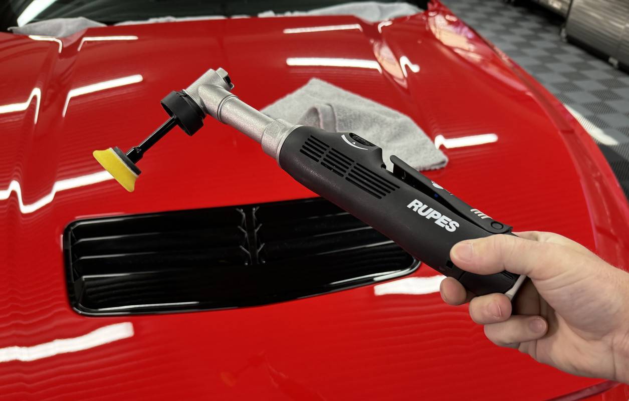

Back on the polishers today as I continue working around the car. Today, I started on the hood, in particular the gloss black hood vent. I knew this would test my patience, so starting on it while I was still fresh made the most sense. While this part of the car looked ok from a distance, it was hazed out and dull when viewed up close. I tell someone had a go at polishing it, the dried compound the giveaway.
S650 Mustang This Just Got Real! IMG-2361
I'm going to be honest here, I did my best but I just couldn't get it corrected like I wanted. First, I started with Reflect on the yellow Rupes, but the marring was still present. I then tried Perfect Finish on the same pad, again, no dice. I then tried a microfiber pad with Perfect Finish, no luck there either. So, after another pass with Reflect with barely any pressure, I concluded that I was both removing and installing the marring. In the end, I gave it one last polish by hand using Carpro Essence and walked away. The black roof in comparison was easy.
S650 Mustang This Just Got Real! IMG-2365
This hood vent reminds me of the gloss black trunk panel on my S550, which would scratch by just looking at it. Because these gloss black trims are not actually painted, I think the only real solution for this would be to have it painted and clear-coated. It's an easy removal, so I'll have to think about it. In the meantime, I'll just coat it and try to ignore it.
S650 Mustang This Just Got Real! IMG_1848
I also got the glass polished today using P&S Clarity Creme. To avoid plastering glass polish all over the rubber trims, I went around the edges with a Carpro glass hand polishing block, which uses the same rayon material as their normal glass pads. I then put a Lake Country SDO Blue pad on my 3-inch ShineMate and took care of the inner sections. I really like this product, its so easy to use and does not require micromanagement like CeriGlass does, or require a sledgehammer to remove the residue afterwards. That 473ml bottle will last you the rest of your life, negating its cost.
S650 Mustang This Just Got Real! IMG-2369
From here, I removed the tape and began cleaning up polish residue and dust out of the cracks and crevices by using compressed air, rinse-less wash and Carpro Eraser. I also had to break out the Meguiar's M39 to remove some residue from the rear GT badge and 5.0 fender badges.
S650 Mustang This Just Got Real! IMG-2375
S650 Mustang This Just Got Real! IMG-2378
S650 Mustang This Just Got Real! IMG-2385
Am I 100% happy? Probably not, mainly because of that hood vent and a couple of imperfections that I will need to address. But overall, the car has taken on a much deeper, crisper tone to its paint. This is something that was noted by the guys at the dealer last week, that despite both being Race Red, they looked different side by side. That would be down to the polishing and ceramic coating that my old car got before trade, that work bringing out a more defined glass-like depth to the paint.

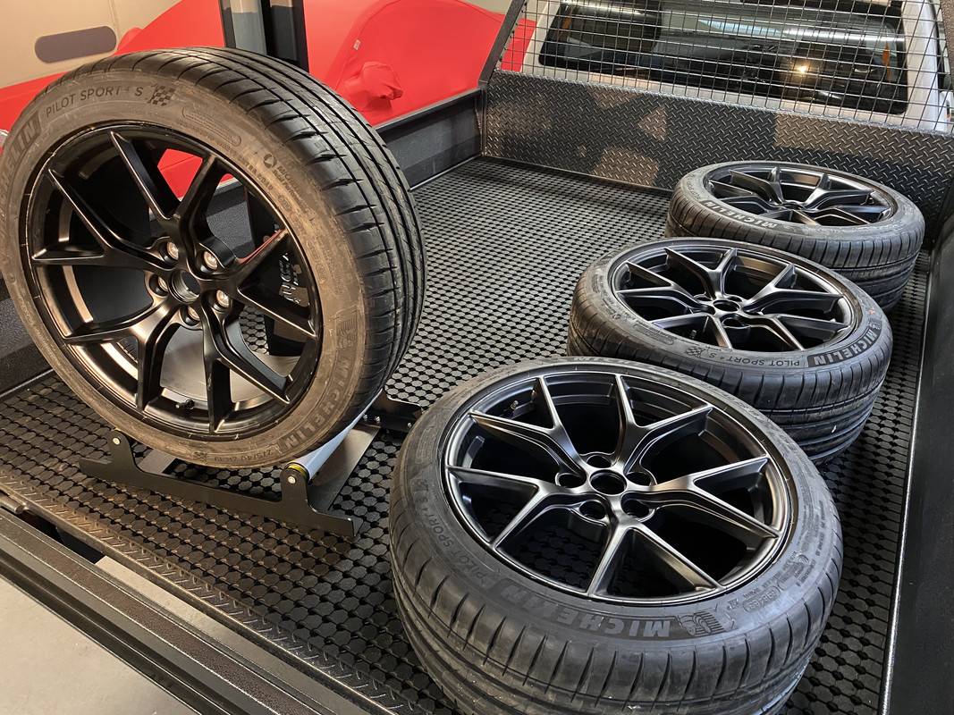

Prior to the sale of my old S550, I removed the Ford Performance HP Performance wheels from the car. I didn't necessarily do this with the intention of fitting them to the S650, rather they are worth more than the original gloss black Performance Pack items that came on the car. The same with the solid black lug nuts.
S650 Mustang This Just Got Real! IMG-1434
S650 Mustang This Just Got Real! IMG-1436
Like the S550 Performance Pack wheels, I'm not in love with the standard S650 versions. Actually, they look pretty good, especially in the graphite colouring rather than the satin black that my car came with. I have two main gripes with both S550 and S650 PP wheels, they hide the brake calipers and......................they take forever to clean.

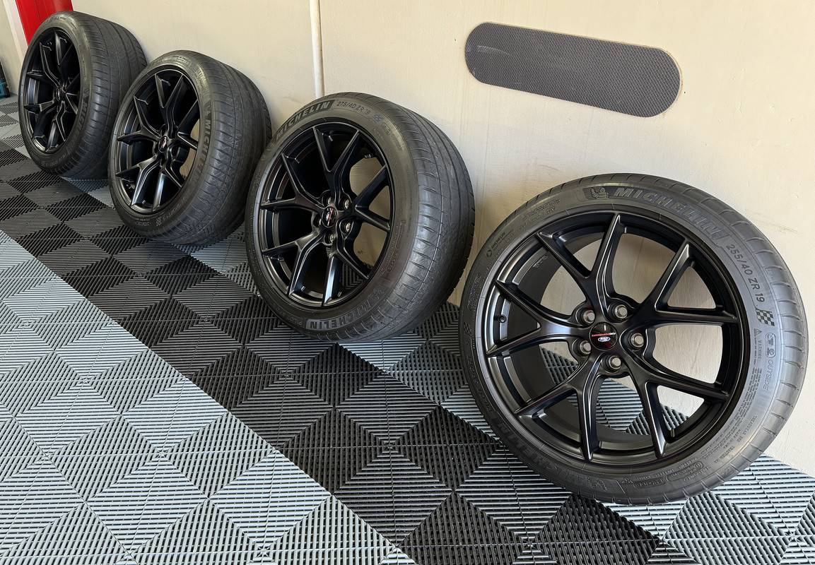

And so, curiosity has got the better of me, I've decided to trial the HP wheels on my new car. With two sets of wheels to choose from, I have effectively doubled my wheel workload. :rolleyes:
I bought these wheels new in mid 2021, effectively addressing three key factors. First and second being the above-mentioned caliper visibility and cleaning ease. The third being a functional aspect, ridding the car of the diabolically bad Pirelli P-Zero's. For a performance tyre, these couldn't have been worse if Pirelli tried. For a powerful rear drive car, the lack of traction you would understand in performance orientated driving, but not low-speed driving in residential areas. Replacing them for Michelin PS4S transformed the car. Having said that, the latest P-Zero Ford is currently using are apparently a marked improvement.
S650 Mustang This Just Got Real! IMG-9418
S650 Mustang This Just Got Real! IMG_9598
Being a brand-new set of wheels, I wanted to go all out in keeping them looking good. At the time, apart from applying DLUX to plastic trim, these wheels would be the first time I had used a ceramic coating on a painted surface. After looking at a few coatings, I settled on NV Wheel. Considering how nervous I was, the coating went down well, and I learned a new skill.
S650 Mustang This Just Got Real! IMG_9645
S650 Mustang This Just Got Real! IMG_9649
I never really loved that coating, it just didn't exhibit the sort of hydrophobic qualities I was expecting. From what I can tell, to get the durability needed on wheels, the slickness and water behavior tends to suffer on wheel-specific coatings. For me, both of those aspects matter to me just as much as the actual protection.
NV Wheel did provide decent longevity and was still mildly present when the wheels were removed, however, I wanted to start fresh with a new coating. The problem here being the satin/matte finish, you can't simply polish off the remainder of the previous coating, unless you want a gloss finish. So, I needed to do the best I could working with that constraint.

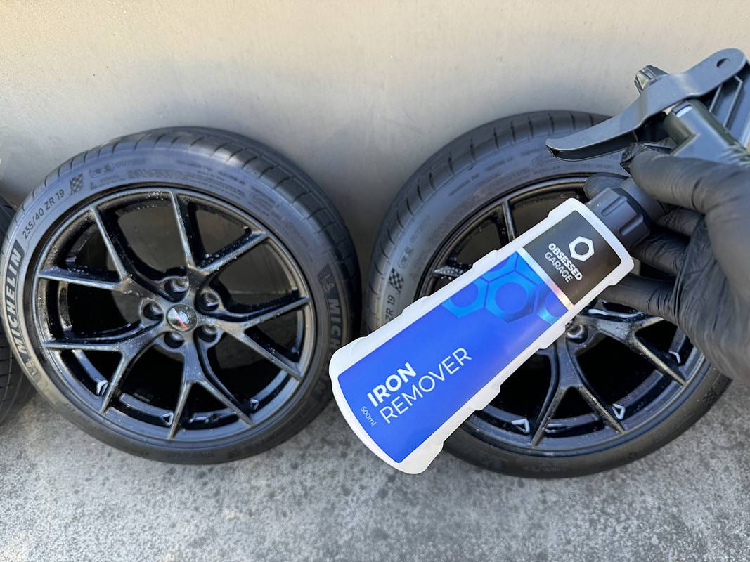

First up, I applied Gyeon Iron Remover to each wheel and left them to soak.
S650 Mustang This Just Got Real! IMG-2419
From here, I rinsed off the iron remover and used undiluted brake buster to get them clean. I then clayed using a traditional clay bar and Gyeon Clay Lube. After this, I grabbed the Big Boi to get the wheels and tyres dry.
Next, onto one of my favorite detailing tasks, refreshing tyre sidewalls with Stoners Tarminator. Both front and back sidewalls were done...................yes, I know. :crazy:
S650 Mustang This Just Got Real! IMG-2425
I then did three rounds of prep spray, starting with Carpro Eraser, then Rupes Reveal Strong, then ADS Panel Prep.
S650 Mustang This Just Got Real! IMG-2428

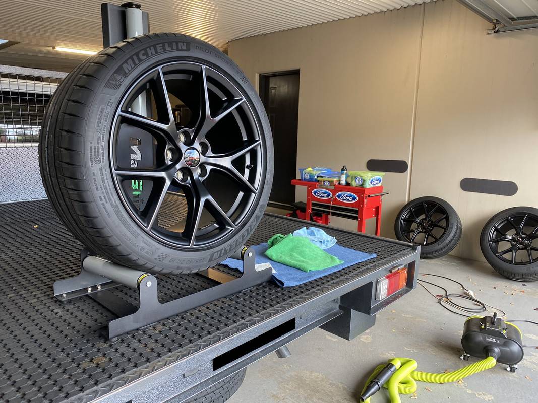

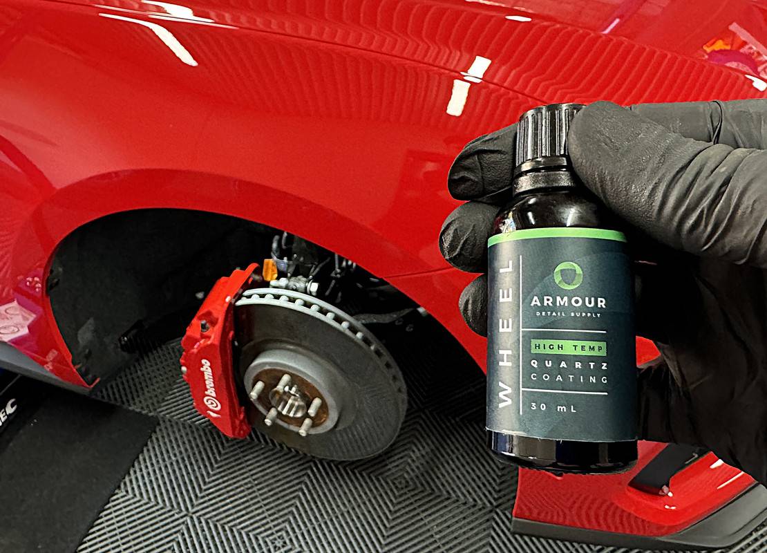

The choice of coating wasn't really a choice, rather a mere formality. After first applying ADS High Temp Wheel Coating to the XR6 this time last year, I couldn't be happier with this product. It goes on quite thick, and has some grabbiness during the first wipe off, but it transforms to a lovely slick finish. Water behavior is exceptional and cleaning stupid easy. I may not be 100% sold on paint coatings in general, but on wheels, this coating is a must.
S650 Mustang This Just Got Real! IMG-2430
The ADS wheel coating is a single layer product, but it can be layered if desired. Considering how matte wheels are somewhat porous, I decided to apply two layers. The barrels in particular soaked it up, to the point where leveling was pretty pointless. After four hours, I applied ADS Ceramic Sealant to protect the coating as it fully cures.
S650 Mustang This Just Got Real! IMG-2434
S650 Mustang This Just Got Real! IMG-2441
S650 Mustang This Just Got Real! IMG-2437
Overall, I'm very happy with how these came up, the coating has brought additional depth and richness to the finish. I'll keep you in suspense a little longer though, I'll be swapping the wheels over tomorrow, coating the calipers as I go.

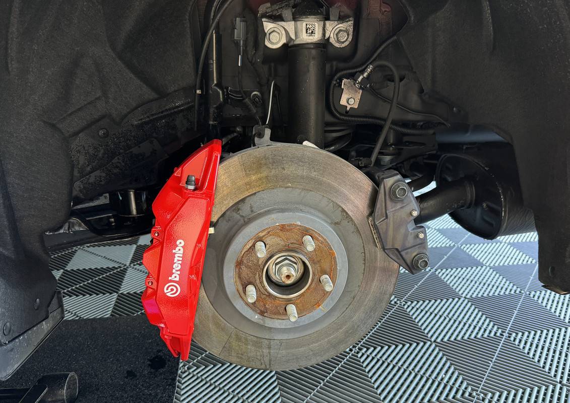

I have to confess, I'm a bit of a brake nerd! There is something about a big set of brakes that gets me fired up. Obviously, there are practical benefits to having big brakes, but I also love geeking out over how they look. On a performance car, those two things are equally important.

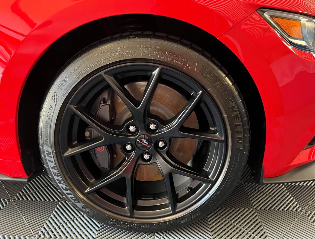

On the S550, all Australian-market Mustang GT's came with meaty 6-piston front calipers acting on 380mm vented rotors. At the rear, a single piston sliding caliper on 330mm vented rotors. I never found a situation where I felt the need for more brakes, not something I could say about my two Falcon's. The only drawback? That Ford chose not to paint the calipers, instead going for a grey anodized finish. I did ceramic coat them, but they sort of blended into the background, especially with the Performance Pack wheels.
S650 Mustang This Just Got Real! IMG-9677
S650 Mustang This Just Got Real! IMG-9680
S650 Mustang This Just Got Real! IMG-1280
S650 Mustang This Just Got Real! IMG-1480

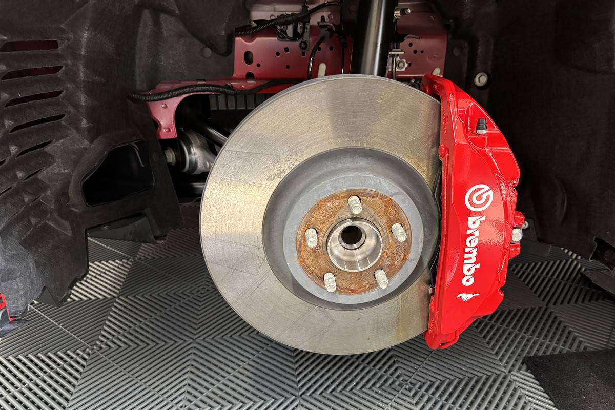

For S650, Ford made some sizable improvements to the braking package. Firstly, this helps offset the weight increase over the S550, but it also has visual benefits. The front calipers are still 6-piston Brembo's, but they are considerably larger than before and includes brake cooling ducts. At the rear, Ford ditched the single piston caliper for a 4-piston Brembo caliper. Rotor sizes have increased to 390mm front and 355mm on the rear. Also on the rear, a separate caliper for the electric handbrake, this change necessitated the inclusion of GT350/GT500 suspension components.
Aesthetically, Ford are also now painting the calipers in blue, red or black depending on model and options chosen. In the US, there are several brake colour configurations, be that bundled with an option package, or via a standalone option for $600. In Australia, it's a little more straight forward. The default colour for Mustang EcoBoost and GT is gloss black with white lettering. For Darkhorse, Ford uses Notorious Blue with Grabber Blue lettering.
There is one exception to the above, when Magneride is ordered, Ford also includes red painted calipers with white lettering. Magneride will set you back $2950, which is something I wanted regardless, so the painted calipers are a rather handy side benefit.
S650 Mustang This Just Got Real! IMG-2453
S650 Mustang This Just Got Real! IMG-2452

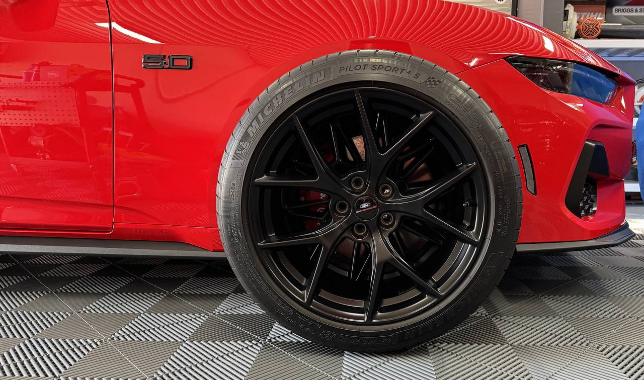

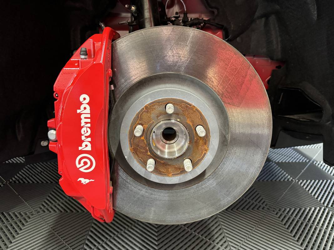

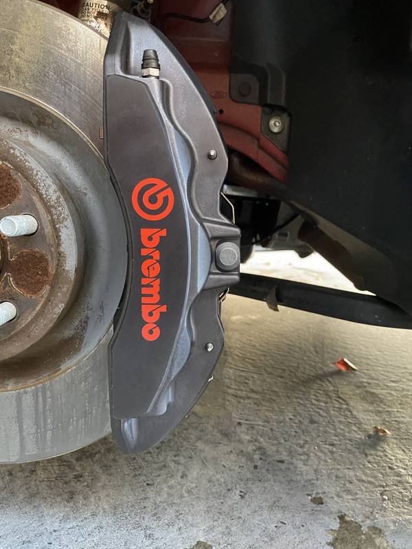

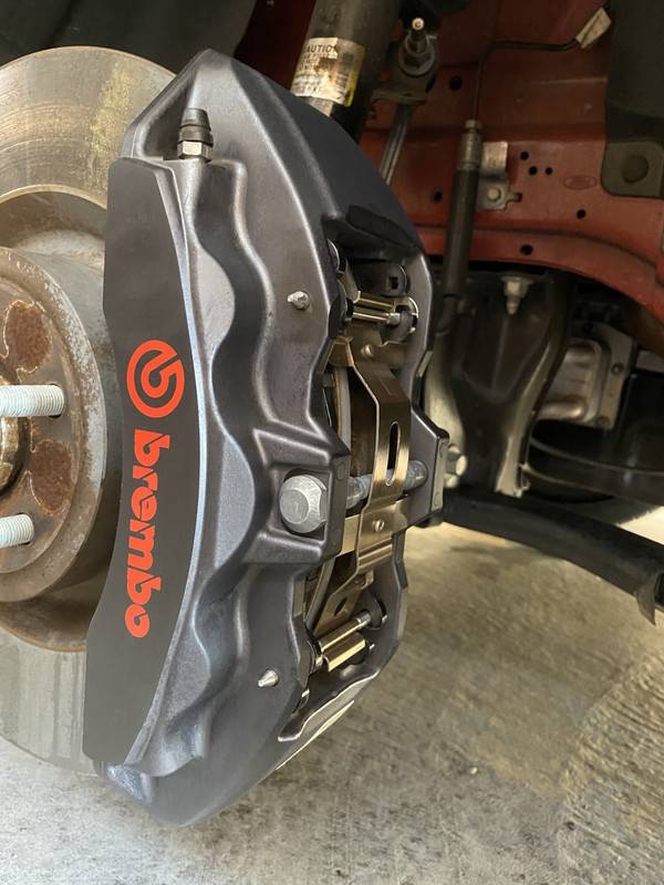

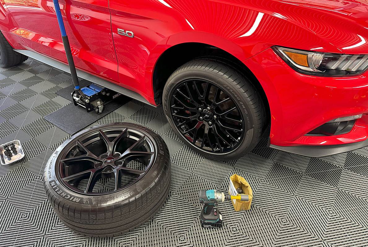

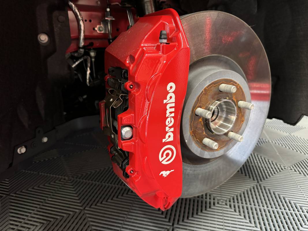

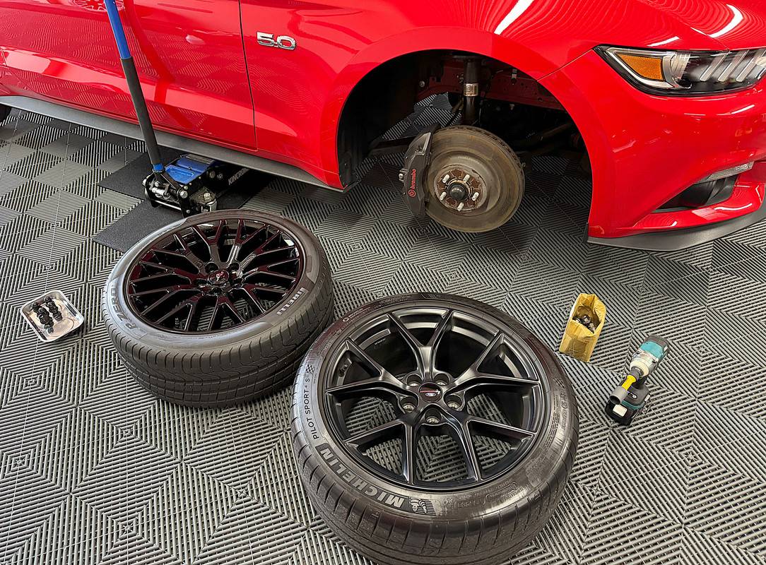

With my old HP wheels coated, today was about swapping them onto the car, while also taking the opportunity to ceramic coat the calipers while I was in there. Working corner to corner, I removed the PP wheel and cleaned the caliper using a brush and N-914. Typically, you would use an iron remover as well, but I skipped this today as they are virtually brand new, not to mention using an ADS Wheel Cleaner on them during the decon wash.
S650 Mustang This Just Got Real! IMG-2481

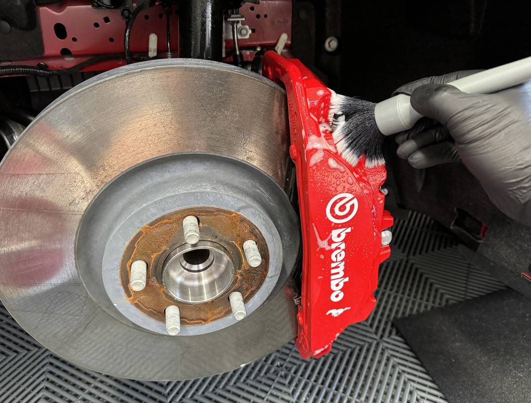

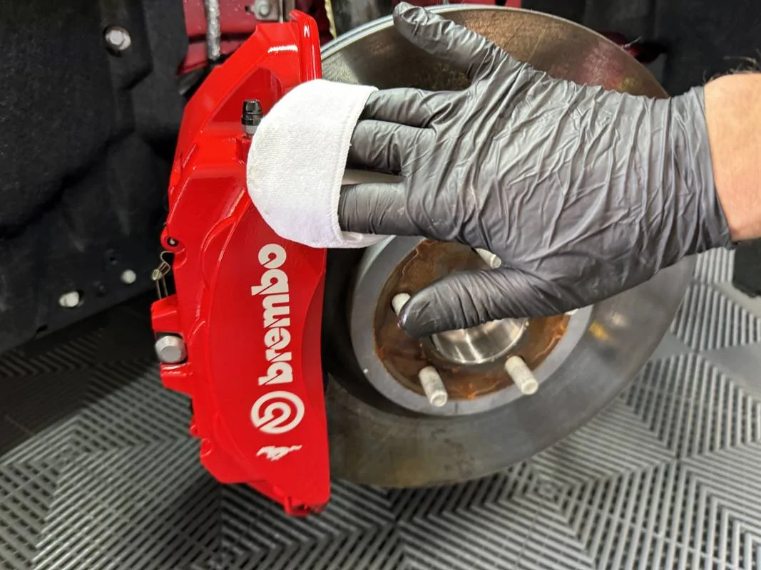

After rinsing with water, I hosed down the caliper with Carpro Eraser, wiped dry, then went over it with compressed air to remove any trapped moisture. I then followed with Rupes Reveal Strong for just before the coating went down. Coating here was again ADS High Temp Wheel Coating.
S650 Mustang This Just Got Real! IMG-2464
Coating the calipers can be a bit fiddly, but I decided to use up some Gtechniq AP2 finger applicators I had in stock, this made it really easy to apply.
S650 Mustang This Just Got Real! IMG-2466
I'm sorry, but these things are pure pornography! 🤤
S650 Mustang This Just Got Real! IMG-2486
S650 Mustang This Just Got Real! IMG-2485
Take note of the anodized hand brake caliper on the rear.
S650 Mustang This Just Got Real! IMG-2477

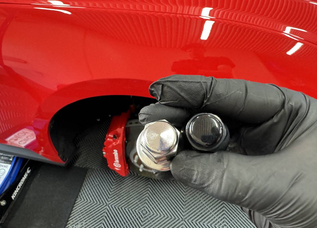

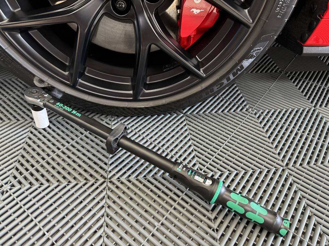

As each caliper was coated, I then offered up the HP wheels and secured them in place with the solid black lug nuts I took off the S550. Mustang's use a crazy high torque value on the lugs, 150 ft-lbs or 204 Nm. I then dressed the tyres with OG Tire Dressing, buffed down after 30-minutes.
S650 Mustang This Just Got Real! IMG-2473
S650 Mustang This Just Got Real! IMG-2501
S650 Mustang This Just Got Real! IMG-2494

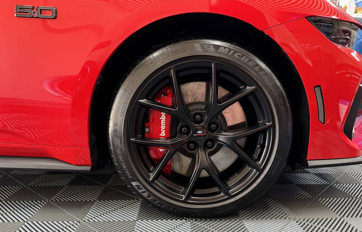

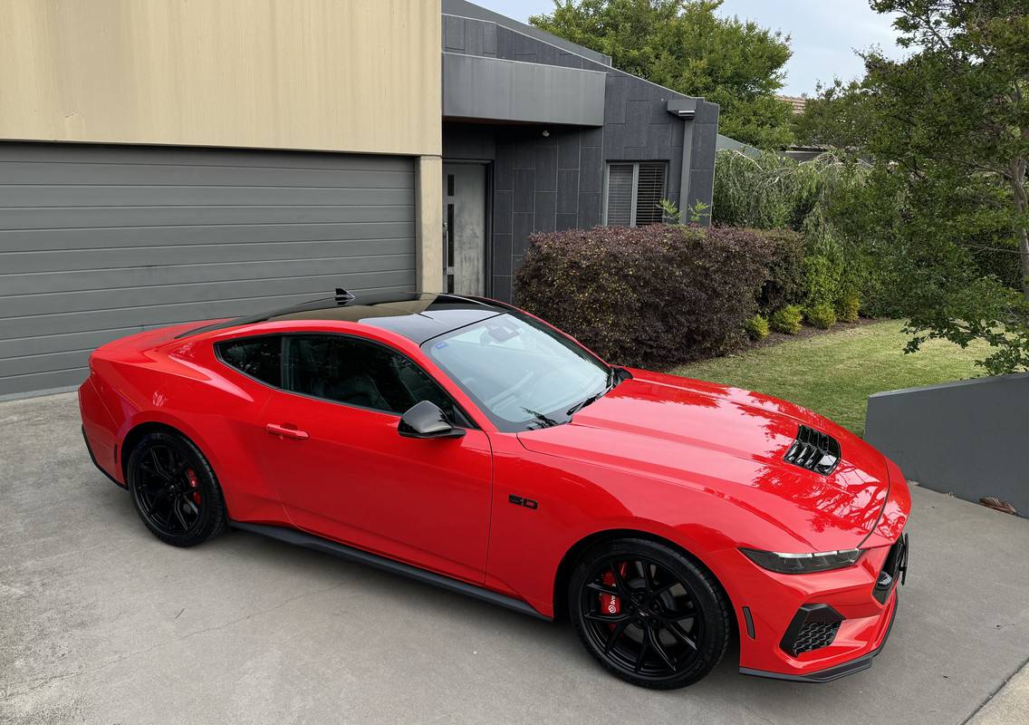

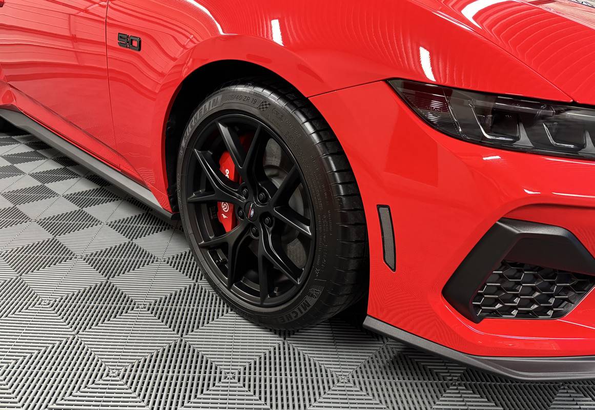

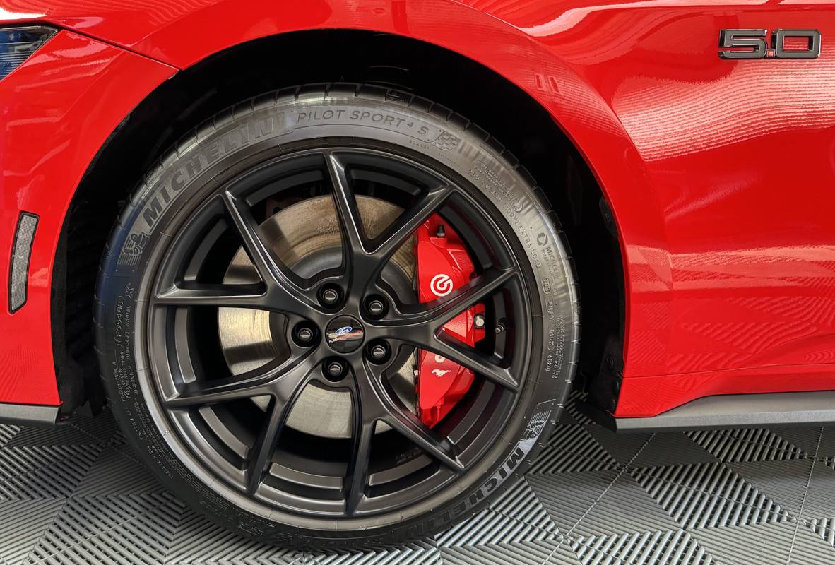

And so, here are the finished results. In some ways, these wheels make the car look like my S550. But then, they also show off those sexy calipers. Actually, I love them! :sunglasses:
S650 Mustang This Just Got Real! IMG-2513
S650 Mustang This Just Got Real! IMG-2526
S650 Mustang This Just Got Real! IMG-2514

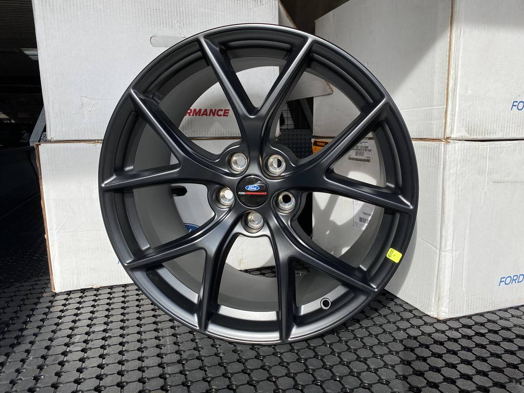

But there is a problem, one that burst my bubble. Of all the parts that Ford carried over from S550, for some unknown reason, they changed the TPMS sensors from 315 MHz to 433 MHz. This means they don't talk to the car, throwing a pressure warning. They can't be coded or reprogrammed either, so of course, the only way to fix that is to remove the tyres and replace the TPMS. Now I have yet to see the warning light, I haven't actually driven the car as I'm waiting for the caliper coating to cure. Also, the PP wheels are in the garage and still talking to the car. :facepalm:
Bugger bugger bugger! Ford kept certain highly visible parts on the new model, but decided to change something that is not seen. This will annoy a lot of people in the US where Mustang owners often have a separate set of wheels with winter tyres, probably transferred from a S550 as well. :facepalm:
I was feeling so good about this wheel change. Apparently the TPMS light doesn't flash, so its a case of just ignoring it, or pulling them back off and have them swapped. I was going to coat the PP wheels I took off the car today anyway, so they will have to go back on if I have the TPMS changed. Not the end of the world, just an unexpected roadblock. Cars!

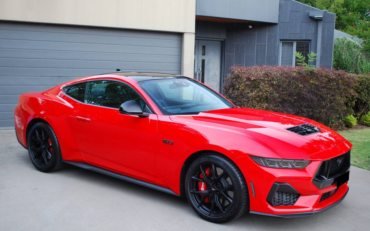

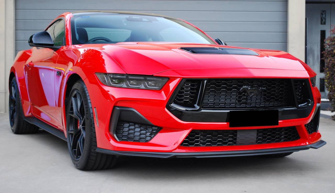

I still have a few things to do, but below is the result of countless hours work. Other than cropping, there is no editing on those images, straight off the Nikon.

I'm confused. Some say they have got them working, some say they didn't, some say they there is a programming sequence. I've also read elsewhere an Australian market S550 Mach 1 upgraded to the Handling Pack wheels that came with the early TPMS, but ended up having to fit the later TPMS to talk to the car. So maybe AU spec cars come with the newer part? No idea at this stage.

As luck would have it, I found the invoice for the TPMS kit I ordered from my ford dealer back when I got those HP wheels in 2021, so I actually have the newer 433Htz sensors fitted to those wheels.
I love those wheels, makes it look a lot "meaner".
Am definitely considering something similar for mine (if it ever arrives) from a local supplier, which could be tough to find.
You can get new TPMS from Mustang Motorsport for $230. MM are stating that the TPMS below are 433MHz but suit S550's (2015-23) as well.
https://www.mustangmotorsport.com.a...433mhz-set-of-4?_pos=1&_psq=tpms&_ss=e&_v=1.0
