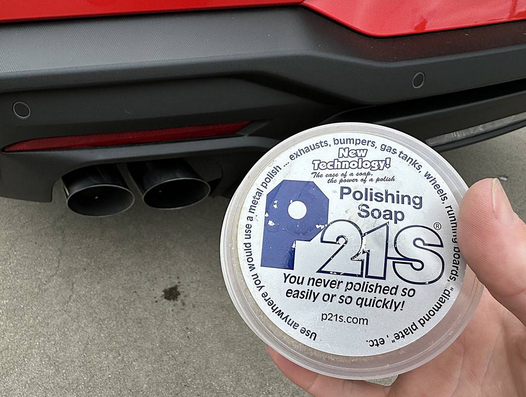

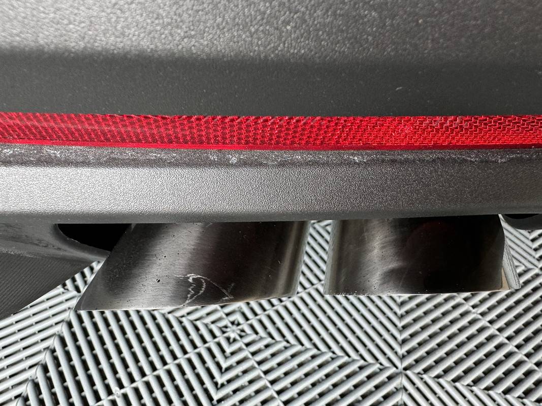

The first detailing job on the new Mustang, addressing the exhaust tips. The S650 uses carry over mufflers and exhaust tips from S550, so the pipes themselves are not sleeved with a chrome finisher. I actually quite like the crisp look they bring, even if it means they will require more ongoing maintenance. The condition of the tips at first looked fine, but under closer inspection, they needed some attention to bring to a level I'd be happy with.
Frustratingly, Ford still spray the underside of export Mustang's with horrible black paint, something that I immediately noticed when I got home from the dealer. Seeing smoke pour out from under the hood of your brand-new car is not something you want to see! A customer new to Mustang's would be extremely worried by this, but I've treaded this path before and know that the smell and smoke was from that useless paint. I mention this because that stuff was all over the exhaust tips, you can see it in the second pic above, and that was the good side, the underside was caked in it. This meant I needed to add an extra step this morning.
Before I went any further, it was time to glove up. These tips are renounced for being a finger slicer, that crisp edge is certainly sharp. I'd normally have nitrile rubber gloves on when using harsher chemicals, but they would have been useless here. A clean pair of my garden gloves worked well.
Koch Chemie Eulex is a sledgehammer, no doubt about it, and you should never use it in confined spaces as its extremely heady. It's typically used as a heavy-duty tar and adhesive remover, but this paint is like tar anyway. Turns out it worked very well at softening the paint to the point where it was removed with a towel. The problem here is working around that plastic bumper, care was needed to not get the Eulex everywhere. I worked my back to where the pipe joins the muffler, in other words, I had to know when to stop. If you end up doing this, chose your towel carefully, you will ruin it.
After the paint removal, I flushed the tips with ONR to remove the Eulex residue, which I can still smell in the garage. From here, I could start to polishing. For the inside of the pipe, I grabbed a Maxshine Polishing Cone which I had in stock and worked them over with Mothers Mag & Aluminum Polish.
At this point I want to highlight the brilliance of "disposable" microfiber towels. I've been running down a box of Repco Eclipse Microfiber Cloths, which are 200 gsm towels in 30cm x 30cm size. These are not the best towel you will ever have, but they excel in being cheap and sacrificial at 0.65c each. Their replacement I bought some time ago being the TRC Rip 'n' Rag.
I have to say, when TRC launched these, they made a huge song and dance about the concept of a microfiber dispenser pack and the disposable nature. Many companies have delivered this format in the past, long before TRC adopted it. Compared to the Repco towels, they actually have a lower 180 gsm and cost 0.87c per towel. However, with a 70/30 blend, they do seem to be softer and more absorbent, Repco don't publish the blend so I would say their cost per towel is achieved with a higher polyester count vs polyamide (polyamide is the absorbent/softness part).
The inboard right side pipe had some sort of scratch that didn't remove with polish, a light hit with some wet and dry paper sorted it easily, I also used that to round off some of the edge.
It was then time for a favorite of mine, a very obscure product that is so perfectly tailored for its role.................P21S Polishing Soap. I used this a final go-over, it actually feels grittier than the Mothers metal polish. A tub of this is going to last you for the rest of your life, its a must for those who love a clean set of pipes.
The final step was the application of Dr. Beasly's Metal Coat. I got this bottle at great expense through Obsessed Garage, but I see its now available on Amazon...................at great expense too. Like P21S, a bottle will last a very long time.
And the final result. Overall, they are a marked improvement prior to all this work, but I think I can still get a little more out of them. If I can find a tip style I like, I may end up going that route instead.

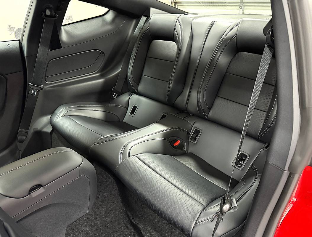

I decided to get the rear accommodation sorted first, which means moving the seat back and base all the way forward, then folding yourself into the back seat. The first thing I noticed, Ford have changed from a carpeted parcel shelf to a hard plastic. The natural reaction to that would be, wow how cheap. But actually, vacuuming that carpeted parcel shelf was difficult, so a simple wipe going forward will be much easier and convenient.

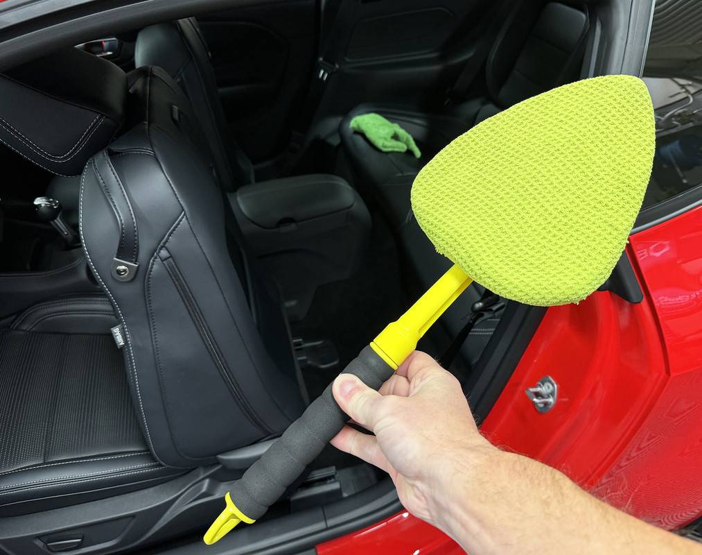

First, cleaning the rear glass. Every S550 and S650 Mustang owner needs one of these, the Stoner Reach & Clean Tool. This might seem like a gimmick, but it makes the job much easier, especially reaching right down to the very base of the screen that would ordinarily be missed. This applies to the front screen as well. I teamed this with the classic Invisible Glass.

I then used Griot's Interior Cleaner to wipe down the leather seats and plastics. Why Griot's? Because it's not scented..................you only get that new car scent for so long. :wink: Because the rear seats will never have been used, I didn't feel the need for a more intensive leather cleaning back there. After the wipe down with Griot's, I applied ColourLock Leather Shield, including the back of the front seats. A quick vacuum on the carpet, it was time to move to the front row seats.
S650 Mustang This Just Got Real! IMG-2153
Again, the Griots was used for a quick wipe down of the console, dashboard and door trims. The front screen and door glass given the same treatment as the rear. For the seats and steering wheel, I used the ColourLock brush and Mild Leather Cleaner. Again, this was more of a reset procedure, so only light pressure was used.
S650 Mustang This Just Got Real! IMG-2156
S650 Mustang This Just Got Real! IMG-2157
S650 Mustang This Just Got Real! IMG-2161
Now clean and allowed to dry, I then applied ColourLock Leather Shield. For brand new leather, ColourLock recommend using Leather Shield up to the 3-year mark, from there you switch to Leather Protector. Leather Shield is an abrasion, discoloration and dye transfer blocker that also allows it breath. ColourLock suggest that signs of wear are most pronounced over the first three years, so Leather Shield was designed to prevent that. For best results, the driver's seat should have this applied every six months, once a year for rest of the interior.
S650 Mustang This Just Got Real! IMG-2170
In my case, I applied Leather Shield to the aforementioned rear seats, the front seats, steering wheel, door trims, gear shifter and boot, drift brake, the center console and console lid. Yes, most of that is not real leather, but there is no harm applying it to artificial leather. Like the Leather Cleaner, Shield is unscented.
S650 Mustang This Just Got Real! IMG-2165
S650 Mustang This Just Got Real! IMG-2166
Leather Shield goes on quite shiny, but as it flashes away, the finished result is a soft, natural, matte finish. No greasiness, no shine. I have to say, afterwards, the leather took on a new dimension, it feeling softer and smoother than before.

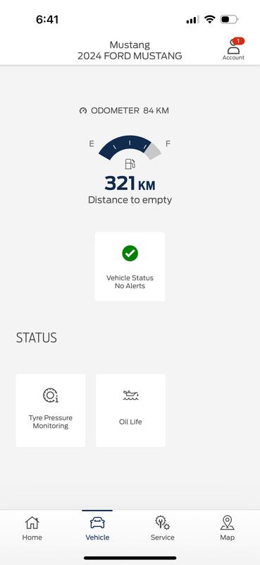

Actually, you can also remote start and stop the car with the Ford Pass App. This allows you to start or stop the vehicle remotely, handy if you want to warm the car up before taking off or making sure the battery is charged while you are away on holiday. The App also allows you to lock and unlock the vehicle, provides a distance to empty estimate, tyre pressure monitoring, oil life, vehicle tracking and current location, the ability to book scheduled services or contact roadside assistance.
Ford All-New FordPass App | Ford Australia
S650 Mustang This Just Got Real! IMG-2176
S650 Mustang This Just Got Real! IMG-2175
S650 Mustang This Just Got Real! IMG-2174
At the end of the day, this is probably more about Ford collecting vehicle usage data and research than it is of convenience, but it's an interesting feature of the car and worth highlighting.
Also, think about the fun you could have ransoming starting up a car while you watch on in amusement. Or maybe freaking out a family member while you are at work. Not that I would ever do such a thing.......................................... :giggle:

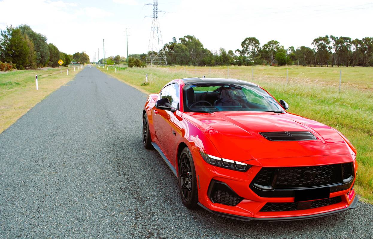

I'm probably spamming the internet with my car at the moment, but I've been waiting to show it off for two years, so sue me! :giggle:
When Ford unveiled the S650, I have to say the rear end did not grab me. Strangely, I now absolutely love the rear styling.
