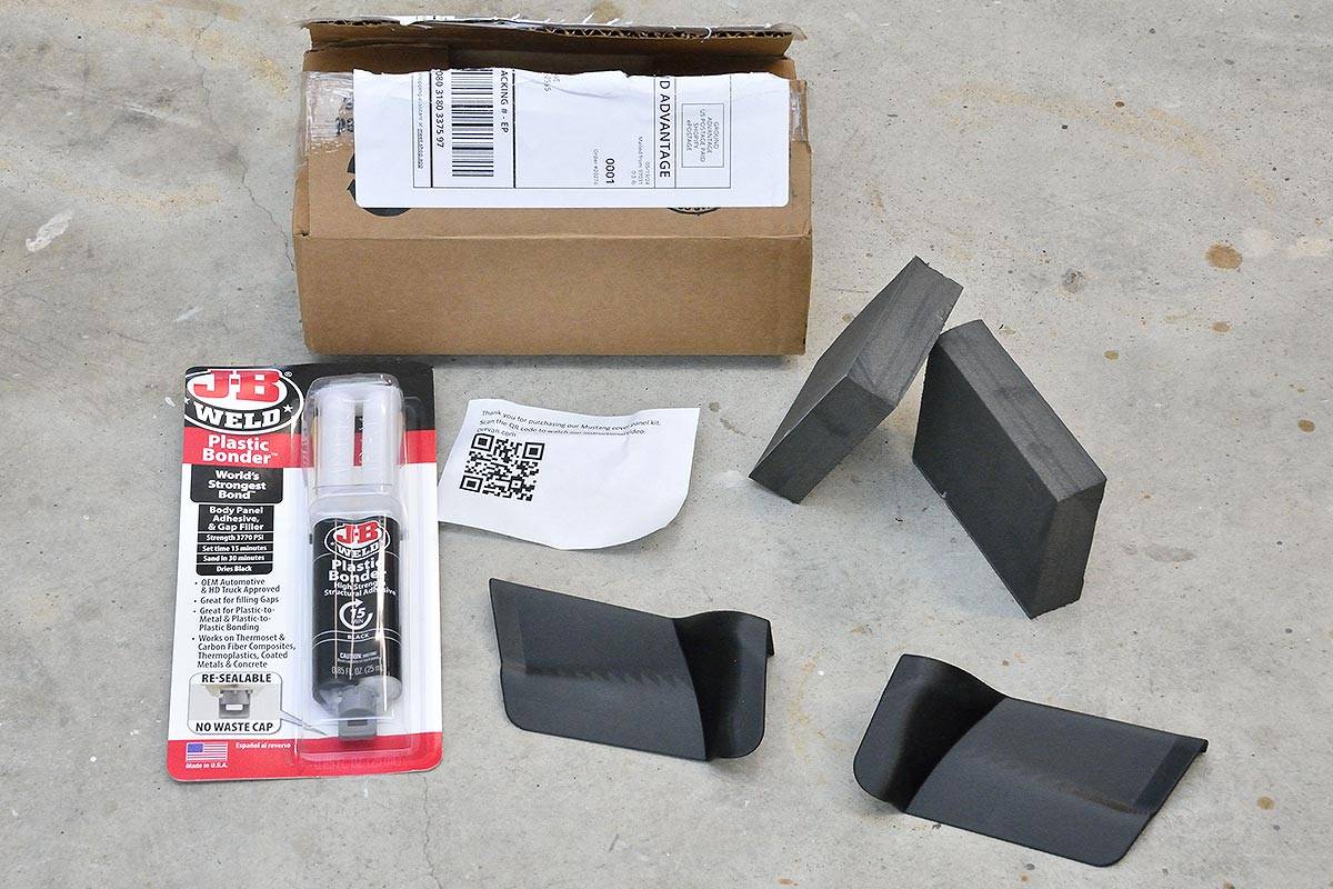

I'm glad I took advantage of getting a set whilst I was in the US a few months ago.
FWIW, looking at my Visa statement it cost me AUD$142.55 including international transaction fee.
(USD$94 with the free domestic delivery)
S650 Mustang Patching Fender Holes on S650 this will be a real issue for Australian Owners _DSC1597_1200
It looks like you'd be paying ~AUD$187 via the ebay store.

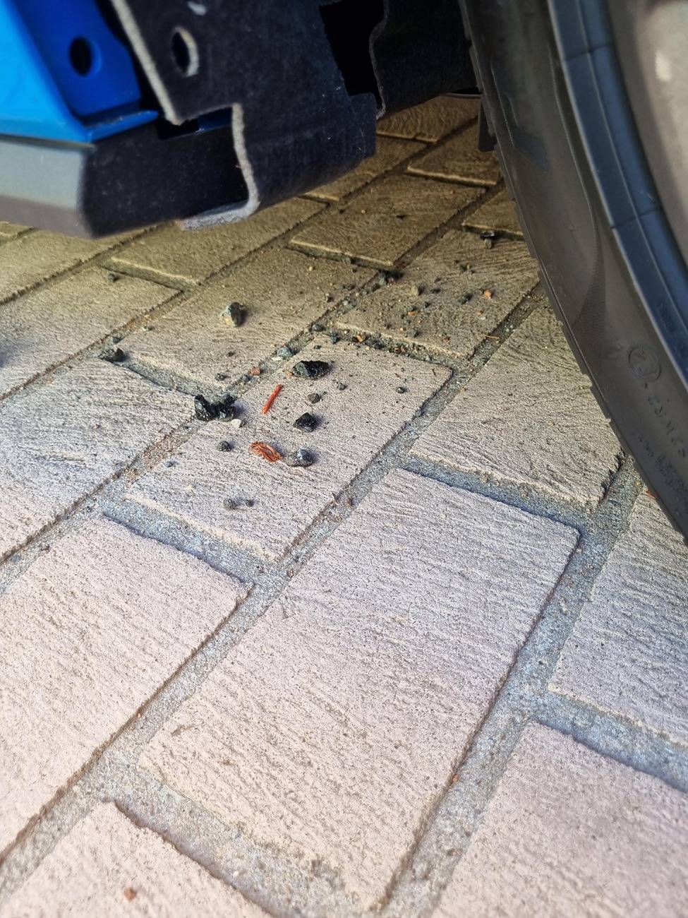

Patches added this is how much I got out on the driver's side only, passenger side was fine after 1000km
S650 Mustang Patching Fender Holes on S650 this will be a real issue for Australian Owners pro-dKHakePy

Are those holes for water to drain out? I am not going to cover them
xrs
xrs
Jul 7, 2024
193
247
Canberra
71 XY 393 Resto Mod, 2024 Mustang GT
Too big for drainage, but is ok not to cover just be prepared to drop your side skirts every 5000km to clean them out so your under body doesn't rust with wet rocks wedged against them
