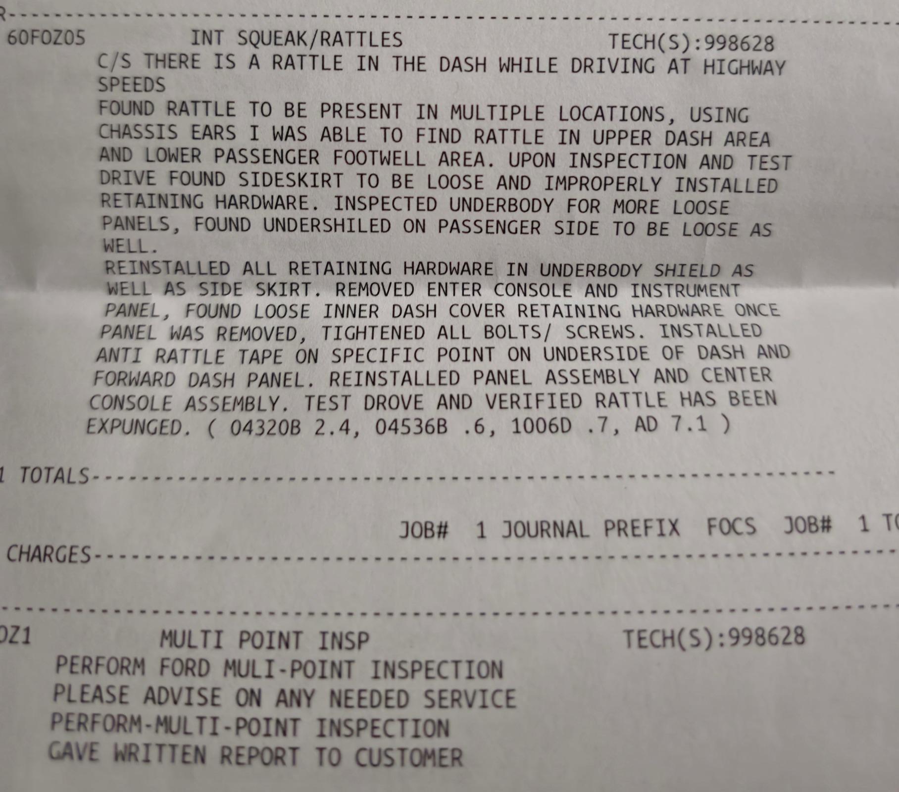

Just got to reading the techs final notes. Turns out my wind shutter noise was a loose sideskirt and underbody panel as it wasn't installed properly, which makes sense of why it was a shuttering noise with the wind and got louder with speed. Going to attach an image of the notes. Drove it about 70 Miles just now, all is nice and quiet!
You've got a gem of a dealer.
Glad you have it fixed.

Excellent documentation of complaint cause andcorrection, that would warm any warranty administrators heart. He flagged almost 11 hours and that's how you get paid by documenting everything correctly.
that is a wonderful story the tech wrote out! almost no misspellings, proper grammar (for a tech story), and bonus points for using "expunged". maybe i should show this to some of the techs i work with lol. based on the SLTS operation numbers, looks like he accessed items behind the dash, accessed items under the center console, and used wireless electronic chassis ears to diagnose a non-rotational noise, like the story says. as steveo1960 said, you found a gem of a dealer there
