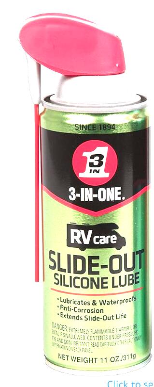

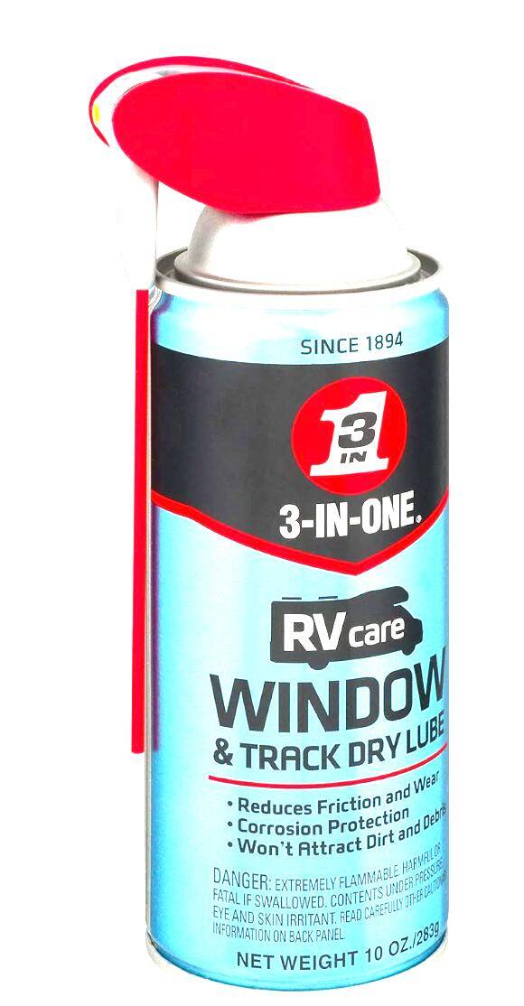

Lastly, I busted out my RV conditioning tools (anyone with an RV knows the rubber and seals are a absolute bitch). I started with window lube and it seemed to have worked, for now, but I think this would have been better. Slide out lube.
I agree this is not optimum but if it works, it works.
