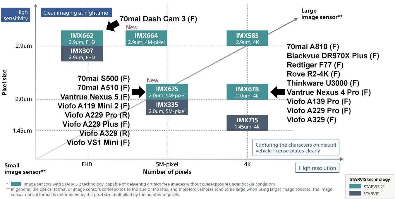

Dash cams, I know many are considering this as the first "mod" they do for their S650.
"You get what you pay for" - remember this.
From late 2023 we started seeing dash cams appear on the market that utilise the Sony Starvis 2 sensor, which is far superior to anything else, including the previous generation Starvis sensor.
EDIT: 23-MAR-25
Updated info graphic. Added:
70mai S500
70mai A510
70mai Dash Cam 3
Redtiger F77
Rove R2-4K
S650 Mustang The Dash cam thread Dash-Cams
Note: Viofo A229 Pro and Viofo A329 have Starvis 2 sensors for both front and rear cameras.

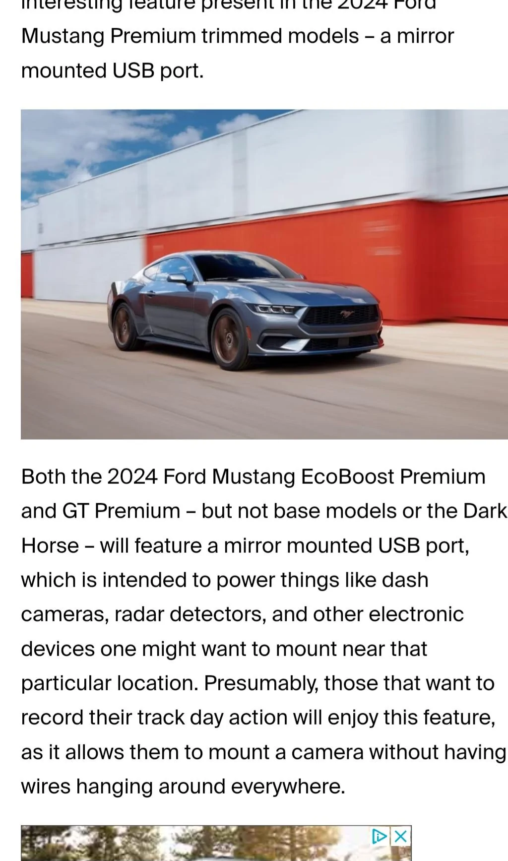

I can't find it, but a while ago I thought I read that there is a power port up by the mirror now to plug in Dash cams. Then we won't need to run the wire to the fuse box. Can anyone confirm this? If true it would be really nice.

Stange no dark horse as that is designed for track use so I would have thought a dash cam would make total sense.

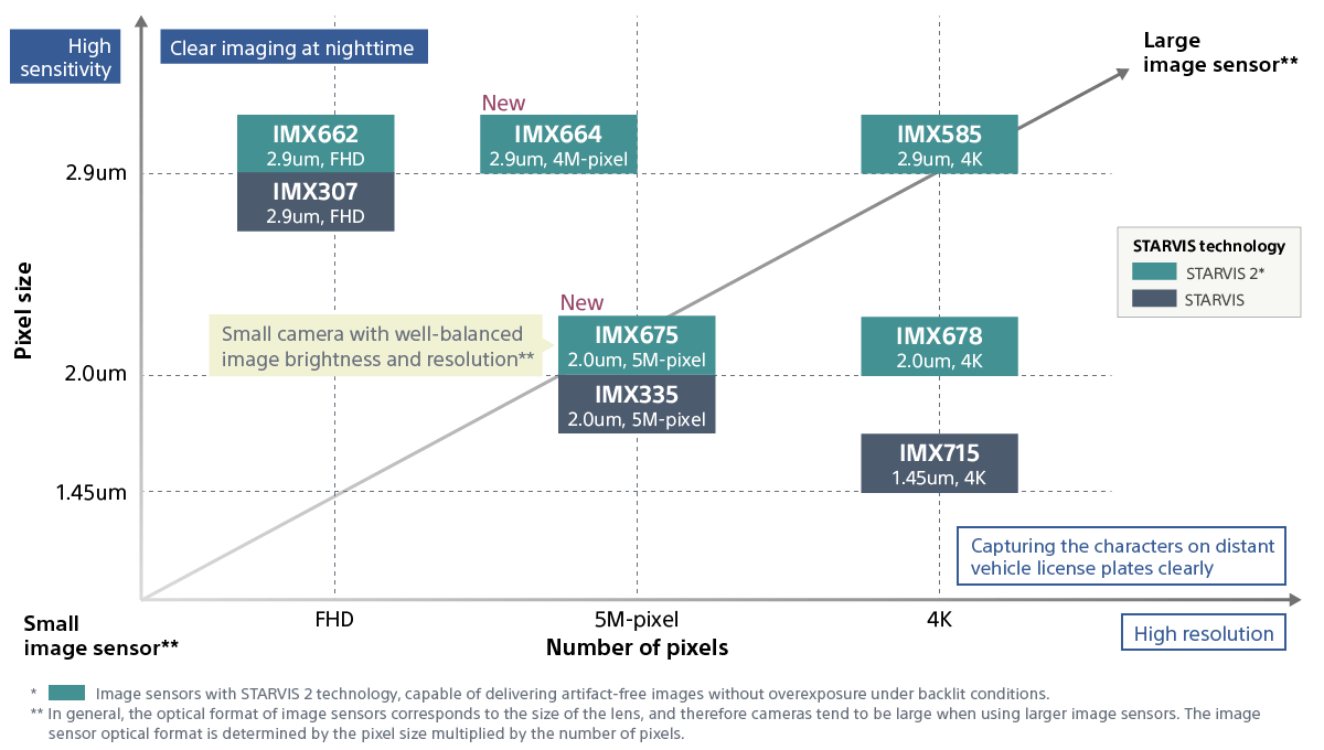

There is no doubt the new Sony Starvis 2 sensor is the best out there... right now.
For my fellow nerds and those who like to know how stuff works:
Sony - Dash cams
Sony - Security Camera Image Sensor Technology STARVIS™ / STARVIS 2
Sony also have another 4K Starvis 2 sensor IMX585, but with larger pixels.
The 585 has a Quantum Efficiency of 91% vs 83% with the 678)
(Simply, a larger sensor allows more light to be captured and converted into electronic signals for processing)
S650 Mustang The Dash cam thread application_its_drive-recorder__img_10_e
This is where we need to wait a little bit to see what other dash cam manufacturers will be offering with sensors and functionality.
Interesting times ahead!
If you need a dash cam right now, the Viofo A139 Pro should be on your short-list to consider.

Found it!
You will not find a single radar detector in Virginia and they, also, have a law about things hanging from your rearview mirror. So, the whole concept having an USB port on your mirror is quite ludicrous.
