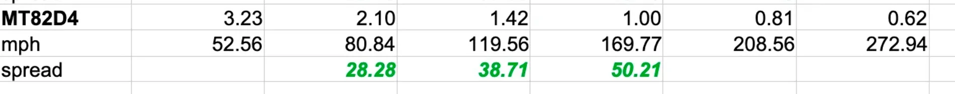

Look how long the gears are stock...
You only have four non-overdrive gears compared to seven in the auto or five in the old MT82

Yikes. Thanks for the info. Might consider that anyway based on that info. 💪
Holy cow. It is an extremely wide ratio four speed. with two overdrive gears.
For comparison's sake, my 4 speed in my 66 GTO had a 2.2 first gear, almost the same as the second gear in that MT82D4. Wow.
The wide ratio Muncie in GM cars had a 2.52 or 2.56 first gear. 3.23 is like some Rock Crawler granny gear.
