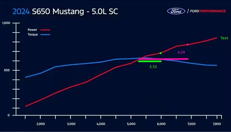

Common 'drag racing wisdom' says you want to cross the 1/4 mile in your 1:1 gear (4th in this case) nearing redline. You can't always do this, especially with how high redlines are these days, tires have gotten taller, and you might not need to since you have 6, 8, or 10 gears in today's transmissions.
For example, let's use a naturally aspirated S650 Mustang with a couple bolt-ons, you might trap 120mph, which means you will be hitting redline as you cross the end of the 1/4 mile in 3rd gear. Not the end of the world. If you switched to 4.09's, it might be a little faster, but you now have to cross the line in 4th, and you've introduced an extra shift. You're getting off the power for a little bit, and that might cancel out any gains you make by changing the gearing. So it's a draw between 3.55 and 4.09's. Unless you're banging gears and launch on slicks at 6k rpm to get the holeshot.
You can notice a similar thing in some cars (again depending on the gears) if you do a 60-130, where you might as well just start in 3rd, because starting in 2nd keeps you there for just a short while and doesn't make any sense because you have to shift right away.
Enter the Whipple.
You're now going to be trapping higher than 120mph. So you have to shift to 4th gear no matter what, so you need to make the most of it. The problem now becomes that you hit 4th gear at 120mph, and you're at 5200rpm And then you cross the finish line at say, 135mph, and you've only gotten up to 6000rpm, because you're geared to go 170mph in 4th gear with 3.55's.
Let's look at a dyno chart of a Whipple S650 for a minute.
So from 5200 to 6000rpm you are only making ~550hp when you shift and 700hp when you are at 6000rpm (these are 'crank' numbers not wheel so they sound better than they are). You're just using the middle of the engine's powerband.
S650 Mustang Supercharger Coming in Spring- What Supporting Mods am I missing? whipples650dyno
Let's switch the 3.55's to 4.09's. You shift into 4th gear and you land at the same 5200rpm. However, when you reach 135mph (and you'll probably make it higher than that because you're making more power this time around), you're now going to be at 6900rpm (136mph). And at 6900rpm, your engine is making right about 800hp. Plus, the power is moving the car with more energy in every gear because of the 'mechanical advantage' of shorter gears.
Using the higher part of the power band with the shorter gears is a huge deal.
Hellcat guys only spin their engines to a little over 6000rpm so they don't want to go over 3.09 or whatever they are because they will run out of gear in the 1/4 mile. When you have 75-8000rpm to play with you can use more gear.
