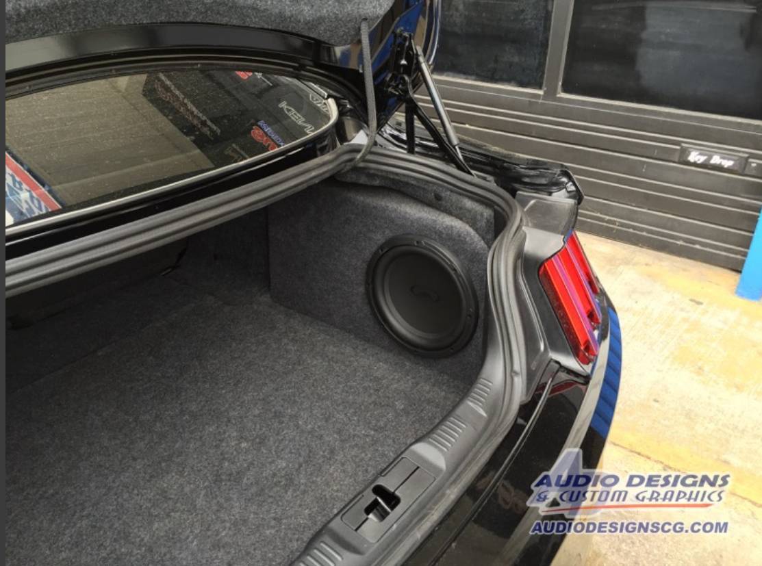

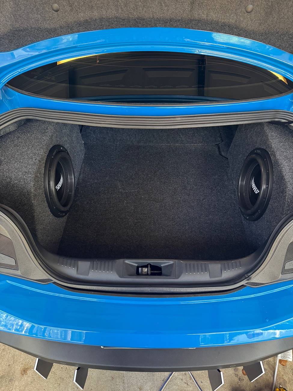

Audio Designs and custom graphics over in Florida made my box that fits in that area. They make it with a couple different subs or with it unloaded and they’ll add the faceplates if you have a different sub in mind. I did sundowns SAv2 subs for mine.
320 for it unloaded
+249 audio dynamic sub
They have hertz and morel if you prefer either of those for a higher upcharge
First pic is theirs in a 2020 mustang.
second pic is my 24 jeep in mind they had to add 5 faceplates to allow the magnet to clear the back of the box. Otherwise should resemble the first pic
https://store.audiodesignscg.com/product/2015-2019-mustang-subwoofer-box/
