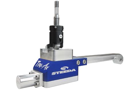

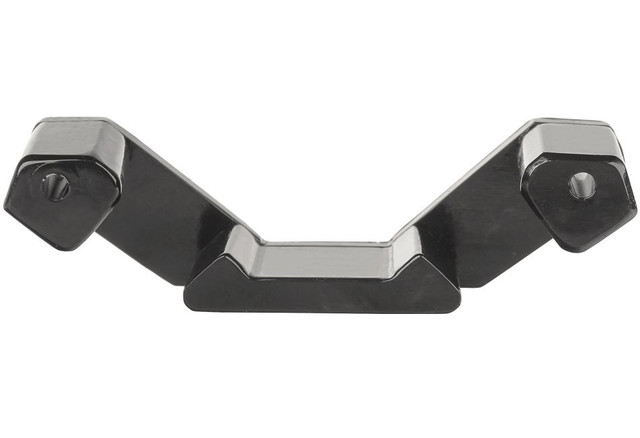

Has anyone had experience with Steeda's Tri-Ax Short Throw Race Shifter for MT-82, and the transmission mount bushing insert? Just would like to hear pros and cons on these performance parts. I've had nothing but good luck with Steeda Products.

Positves- replaces top and bottom shift assemblies.
Con- rear still mounts to body while front attaches to trans. Relative motion between both can cause shifting problems.
On my 2013, I tried several fixes and ended up with not only replacing upper and lower shift mechanism, but one that mounts directly to the transmission.

My opinion, the shifter is way too much work for the gains. The bushing well worth the time and cost, super easy to install, lube is your friend. Upgrade to Amsoil DCT transmission fluid, and go have fun.

This is good to know. I've use their standard street Tri-Ax for Tremec , which I believe is the same as Ford's, with great results in Mach 1s, DHs, and GTs. No problems, but those are chassis mount. This model I'd call a hybrid Chassis/Transmission mount. I should investigate others. Plus this one the the most expensive at $629.

We have had a lot of success with the Steeda Tri-Ax, happy to put you in contact with our team that uses it on the street/on the track:
- The front of the shifter is rigidly mounted, while the rear uses Steeda’s high-performance poly bushing, virtually eliminating any deflection or slop.
- The combination of transmission and chassis mounting gives you a solid feel without the annoying “walking” sensation of fully transmission-mounted shifters.
You won't be disappointed - we use the same shifter on our Steeda Performance Vehicles.
