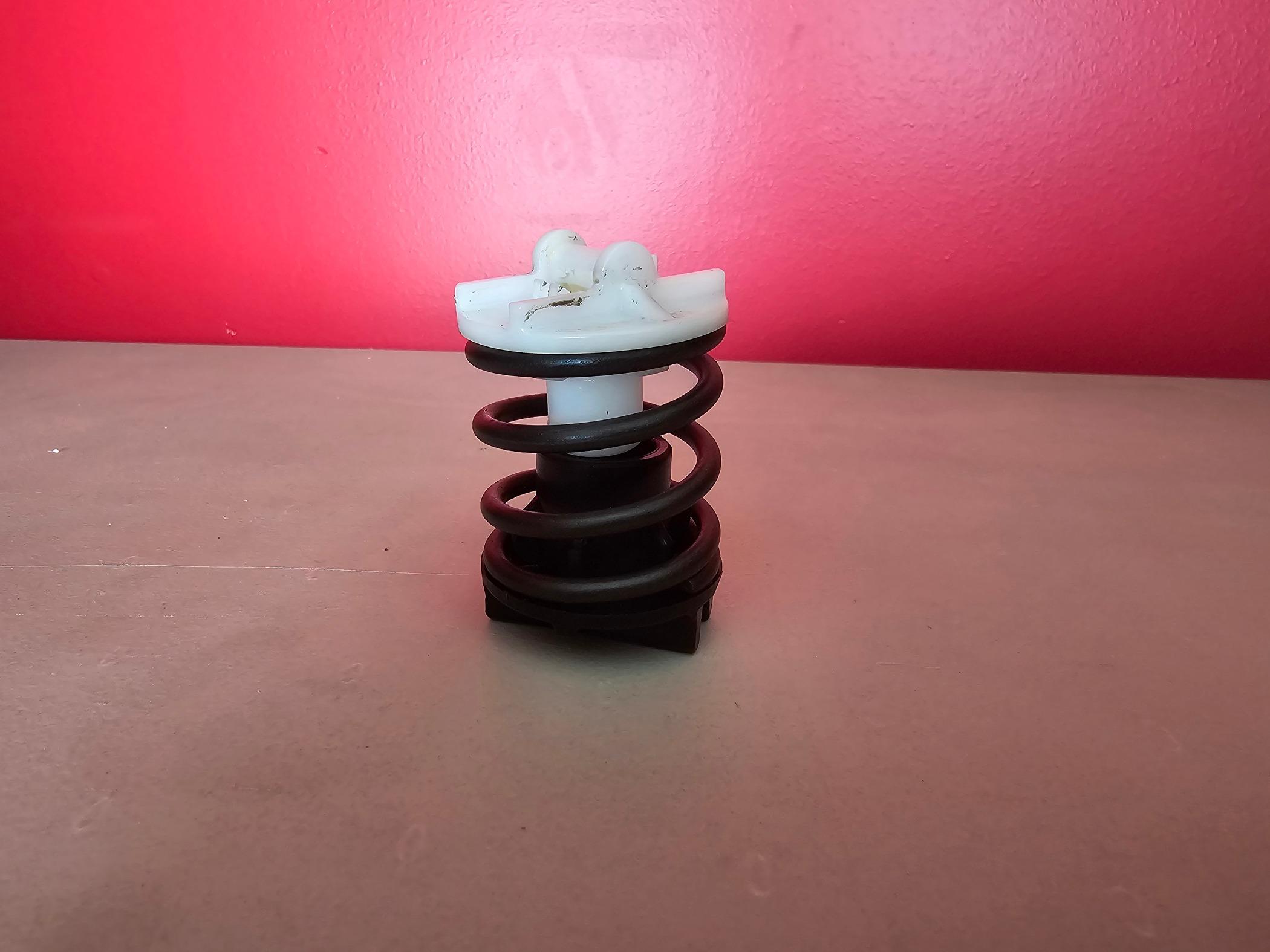

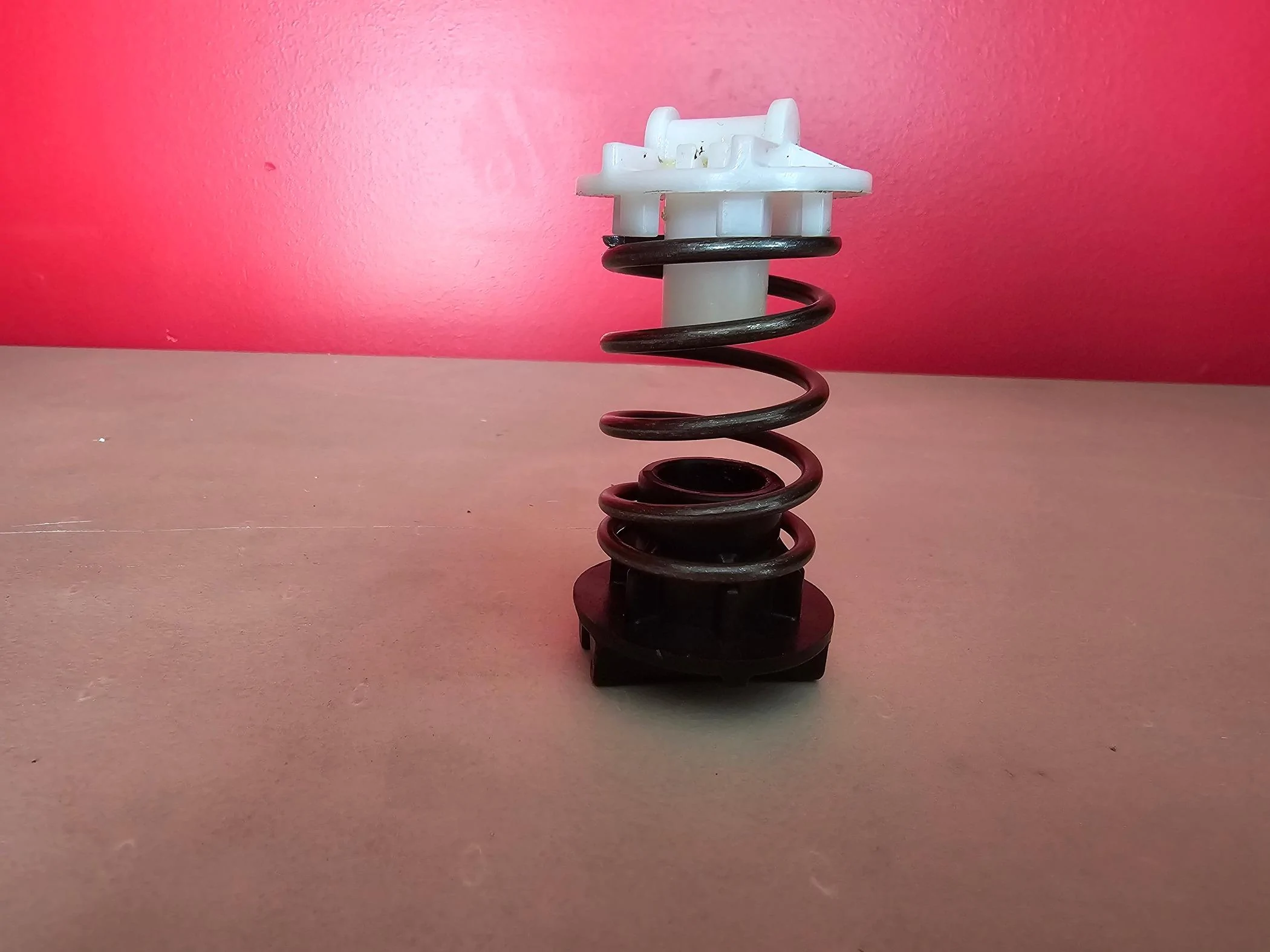

Did your steeda spring look like this? Top is factory, bottom is steeda. I did not attempt to put it in since it doesn't sit correct. Contacted steeda and sent them these photos. I've got to say, driving without that 135 lb spring does make a difference, and for the better. Engages sooner I feel
Yes but it’s compresses easier than the previous one. It’ll all be kosher when she’s in there.
