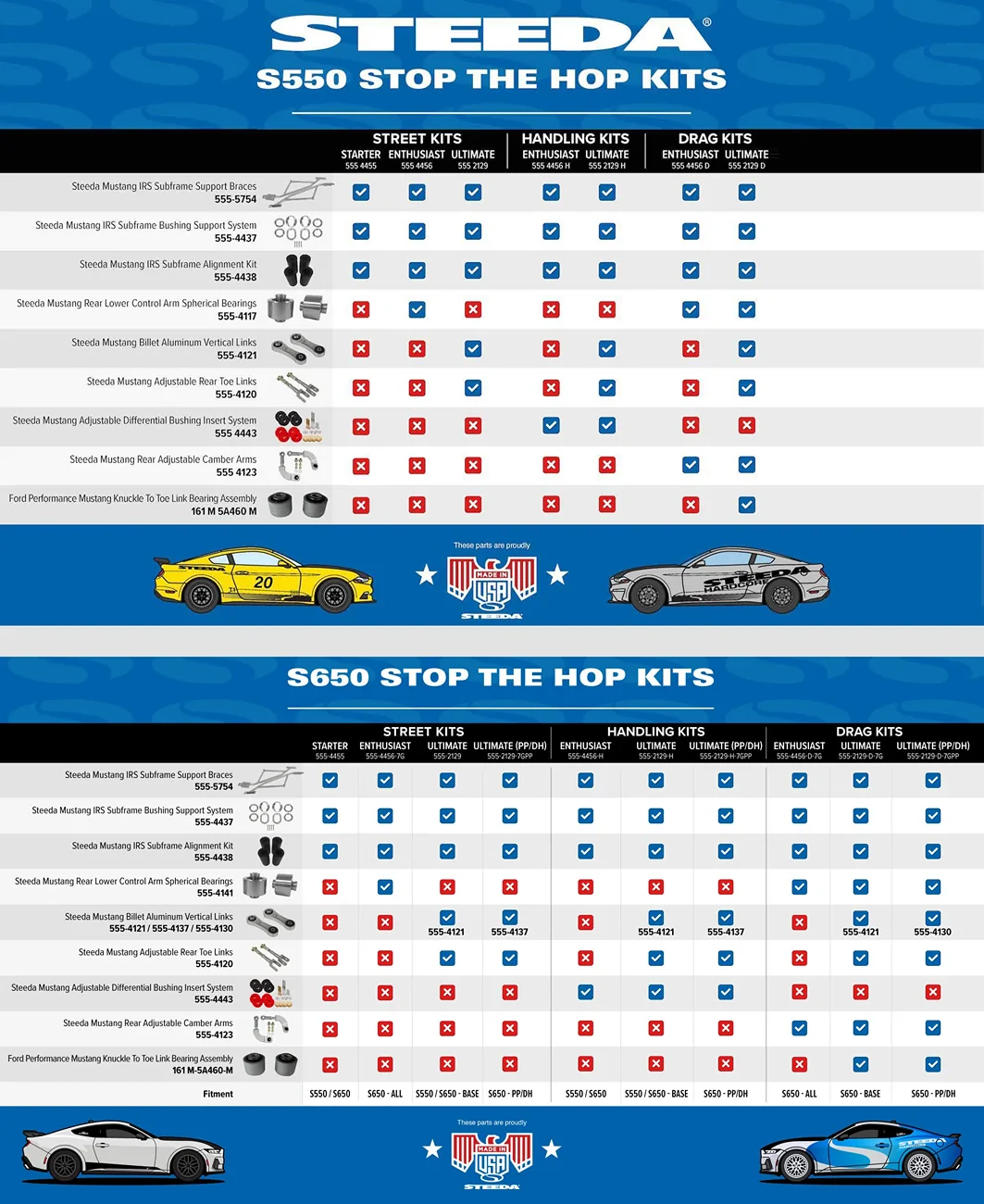

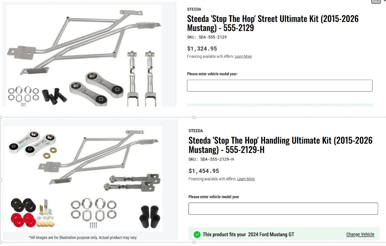

Thinking a about get the kit, but not sure which one: Street Ultimate or Handling Ultimate. There is only about a $75 difference. I plan on doing some track time and probably less drag strip time. This is also a daily driver. Can I get some suggestions, thanks in advance. Also how difficult are these kits to install under jack stands?

I did the street enthusiast... go for that or street ultimate... some have said that the diff bushing kit (red and black things) cause a lot of NVH.
Did mine on jackstands... just need them placed strategically out of the way.

The red bushings in the Ultimate Kit are the softer option and won’t introduce any additional NVH. The black bushings are firmer and geared more toward a race‑inspired feel.
For the $75 difference, it may make sense to go with the kit that includes our bushings. After you get some track time, you can always add the stiffer set later and feel the difference in IRS stability. These bushings were one of the very first upgrades we developed to lock down the IRS when the S550 originally launched.
