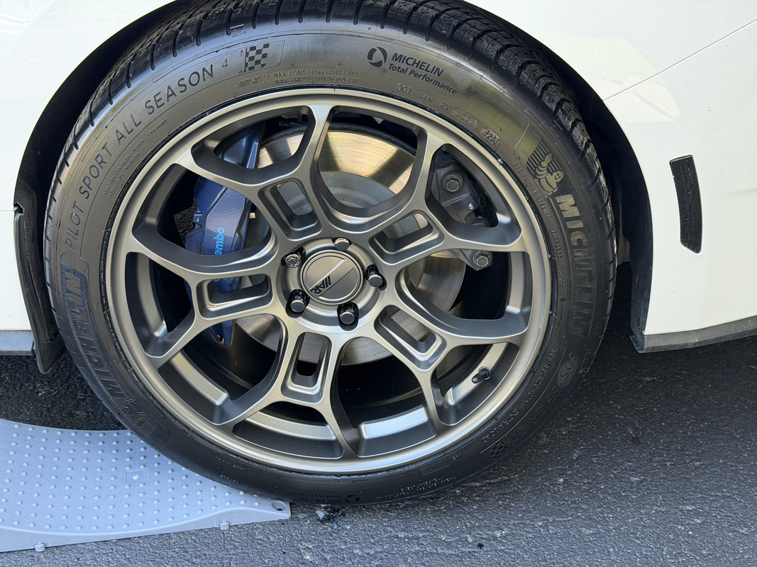

the OEM are a bulge cone seat so they are a little wider, I just bought a set of the bulge black lugs from cj pont parts i think, but then my new AR wheels needed the spline style the holes were so small
S650 Mustang Spline Lug Nuts - What are your thoughts IMG_0143
