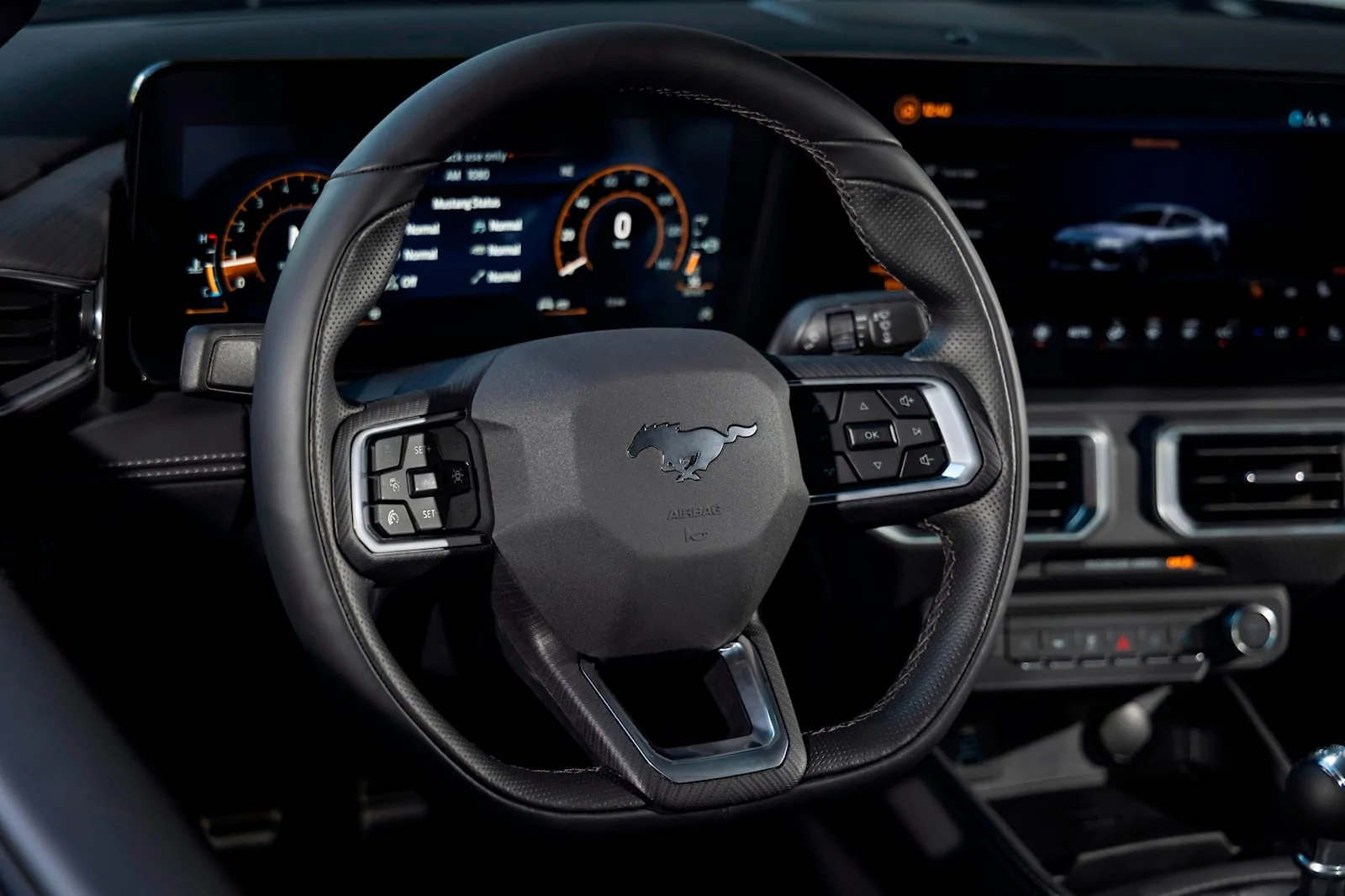

Is there a way to disable the speed limit signs that show on my dash when driving? I've looked in the menus but I cant find a way to turn it off? I saw in the manual there is supposed to be a way to turn the feature off but I don't see it. Speed limit sign recognition is think it's called.
Press the cruise control button on the steering wheel twice, this will turn off the warning bleeps, but will still show the signs on the display. Will need to do this again if you turn the system off, its not permanant, hope this helps.
Its the one on the bottom far left

I admit it's a neat feature. I just wondered if it can be disabled or turn it off. 🤔
Press the cruise control on/off button twice, bottom row far right on steering wheel, will have to do this each time the engine switched off, hope this helps.
Far bottom right is the volume down button
The bottom left button is the speed limiter button not cruise control. Press and hold to disable the speed limit audible warning but the screen display will always remain.
