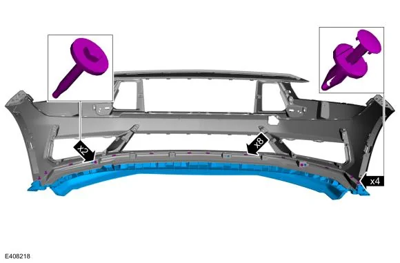

so, i may have been wrong on the "DH splitter does not fit the GT/EB" thing, i noticed something when looking at the workshop manual diagrams
S650 Mustang s650 Front splitter. 1706785173715
the DH splitter is held on with 2 bolts, 4 push pins, and 8 little clips

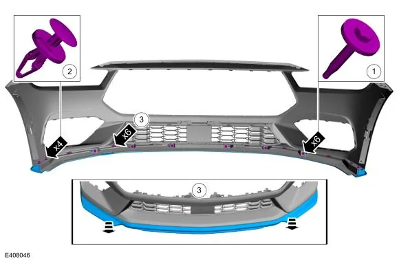

the GT/EB splitter is held on with 6 bolts, 4 push pins, and 6 little clips
the notable thing is it looks like the GT/EB front bumper might have the extra places for the middle 2 clips, and it uses the same 2 outer bolt placements and 4 push pin placements. i'm not 100% sure it will work, but it seems like it could

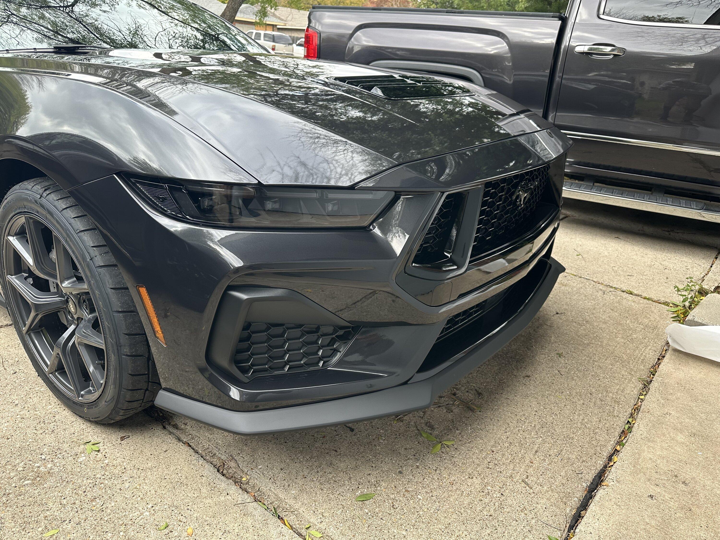

Is this the same size of the performance pack splitter? I like it but can't tell If it's much of a size up. Maybe @roket knows?
In comparing them to the PP splitter, I don't think it's an exact match. This one installs on TOP of the original lip spoiler, while the PP splitter seems to REPLACE the front lip. Look how little it protrudes in the center section. The one I linked definitely extends a little further along the front (and I think it looks more aggressive).
