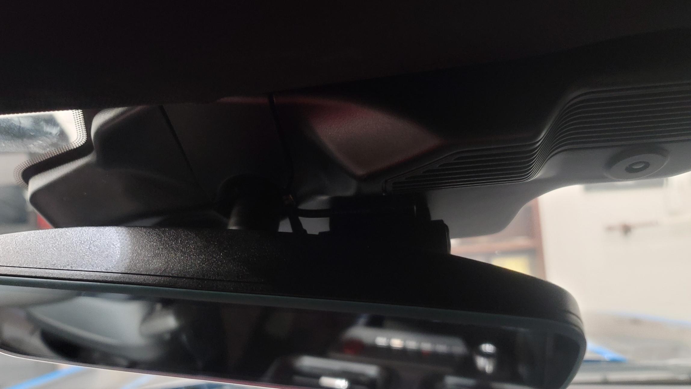

finally got my Mustang back, its been long enough that i have to get used to driving it again. also, installed my dash cam and its a pretty clean looking installation. this is probably the messiest visible part
S650 Mustang roket's Dark Horse - "Azureus" Project 1709712991912
not gonna count the couple feet of wire stuffed in the headliner in the back for the rear camera

Which system did you go with?

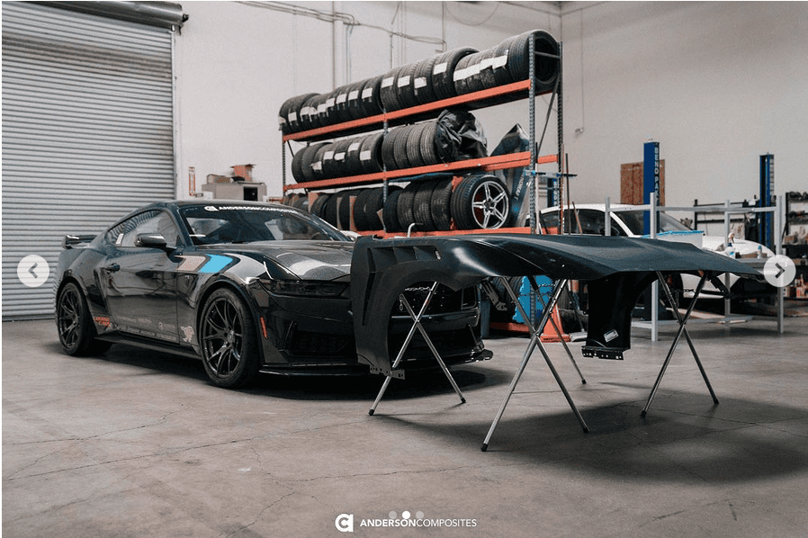

V1 of the fender idea, pretty heavily inspired by the GTD
Can’t imagine rocks and pebbles flying out through that thing??? Can you actually see the tires through that thing?

Viofo 229A Pro
I've been running the Viofo A129 Pro in my F150 for the last 1.5 years. It's been flawless. I also plan on going with the Viofo A229 Pro 3 channel in my future Mustang.
that was an idea i had before i even got the car, not doing that now. it would've been like the GTD where there is a wire mesh preventing rocks flying out
I'm pretty sure there is a mesh on the inside to stop that from happening.

Sigh of relief hearing you say that!
the GTD has a wire mesh in the vents too

also, apparently Anderson Composites is making a GTD-style fender, so now im not 100% sure i will abandon the idea
