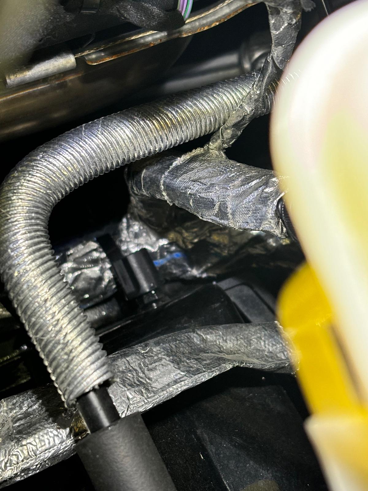

+1 to the design being questionable tbh. If you look at it closely, the clip is held to the tubes by plastic - even though the tube is insulated / the plastic is not. Excessive temperatures could cause the plastic to melt and eventually get dislodged from the clip and voila - we have the same problem of the tubes hanging out from the studs and causing the same issue. The recall service is actually half baked I reckon. They should have told all of us to replace those plastic bands with metal. That would have made more sense and also future proof.
100%. Gonna be dealing with it all morning tomorrow. I hope to get em as insulated as possible. But, for others that want to just nit bother with it, i would definitely keep an eye on it like a hawk.
Nice! I’m thinking about sticking some heat barrier tape around the plastic sleeve and the clip and cover them up. Just to be on the safer side. Close to headers and plastic clips is just scary tbh.
One track session of 20 min and the headers will be cooking.

Correct! That was my understanding. At the dealership currently… They just came back and told me yours is “Solid”. Nothing to worry about. I will still work on getting all the lines anywhere near the headers secured and insulated. Better safe than sorry.
