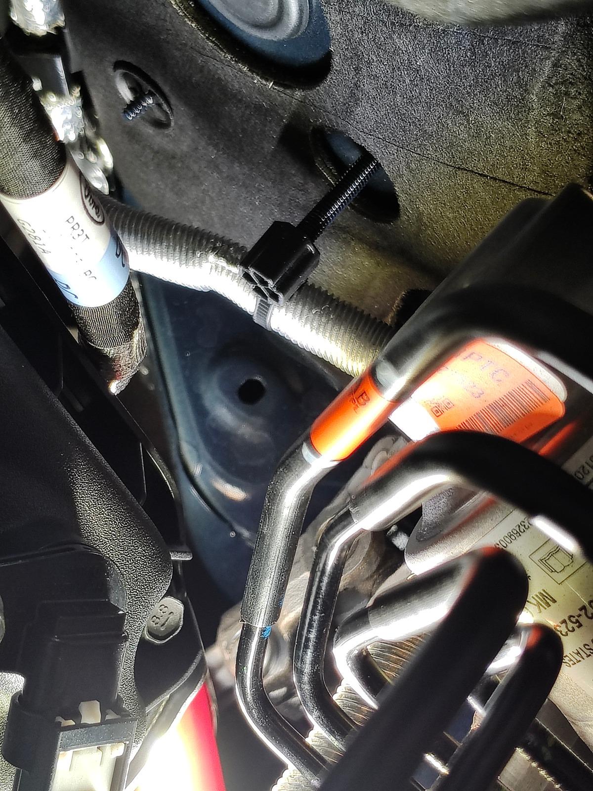

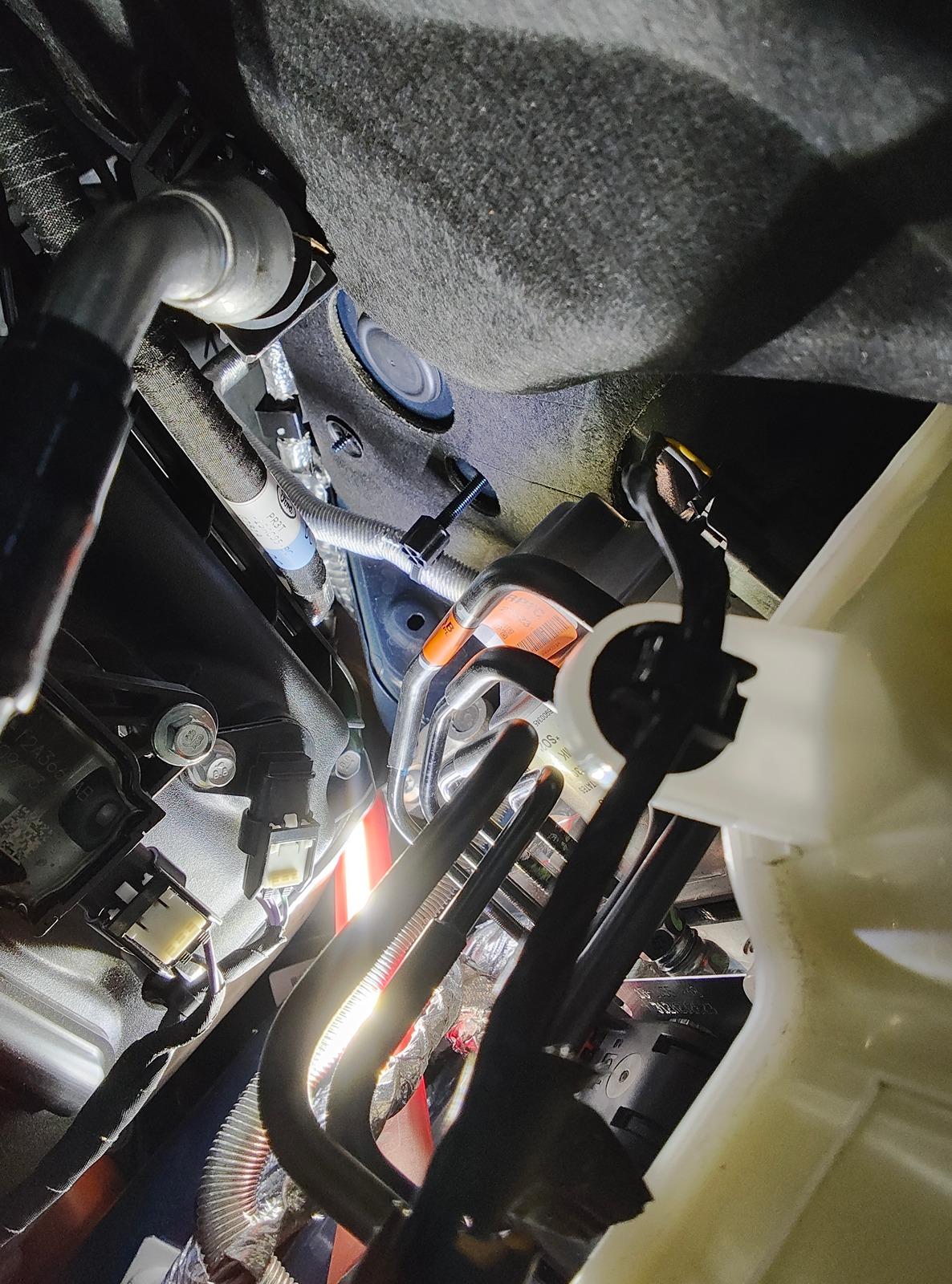

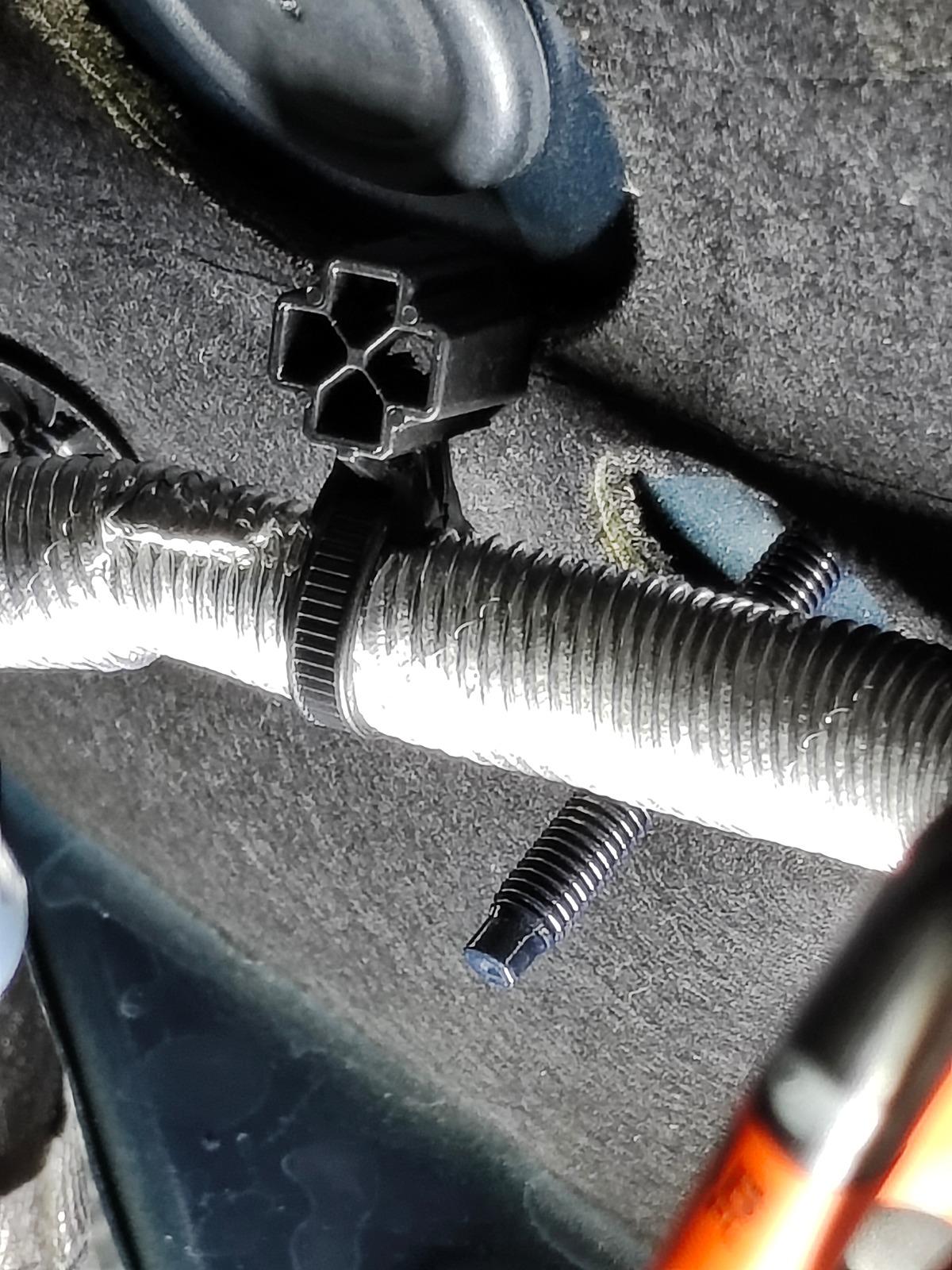

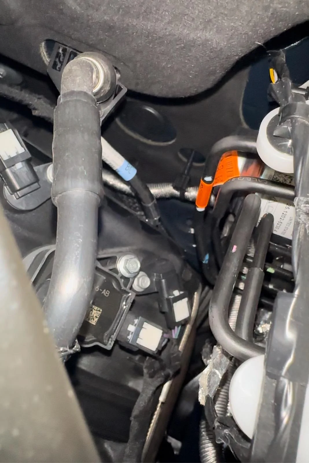

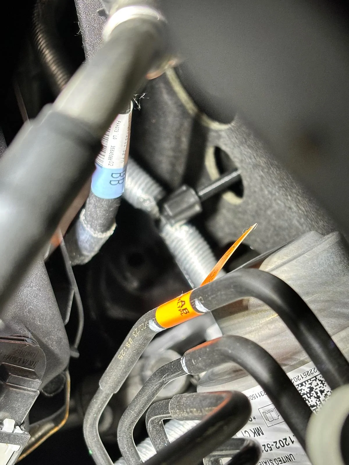

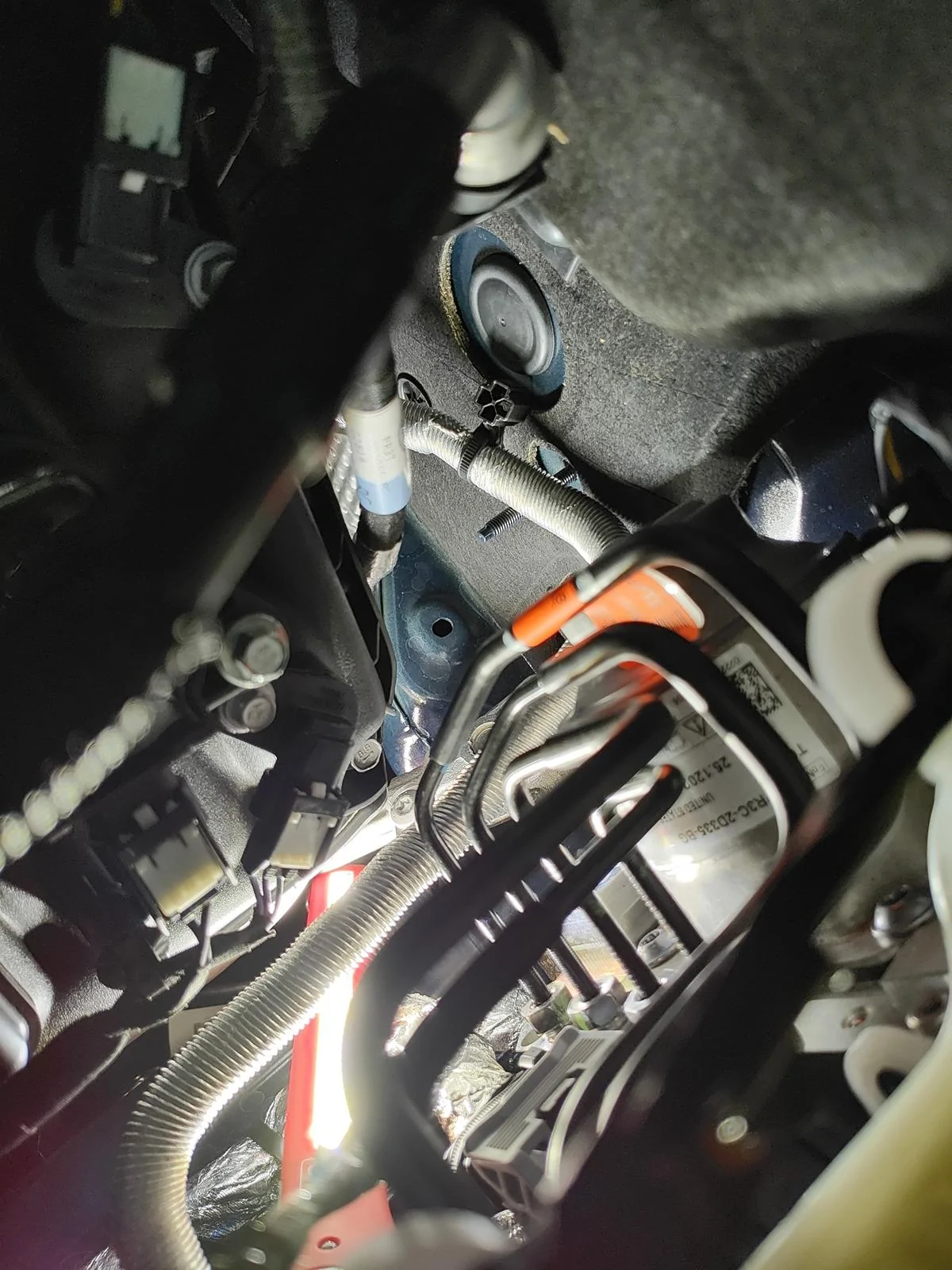

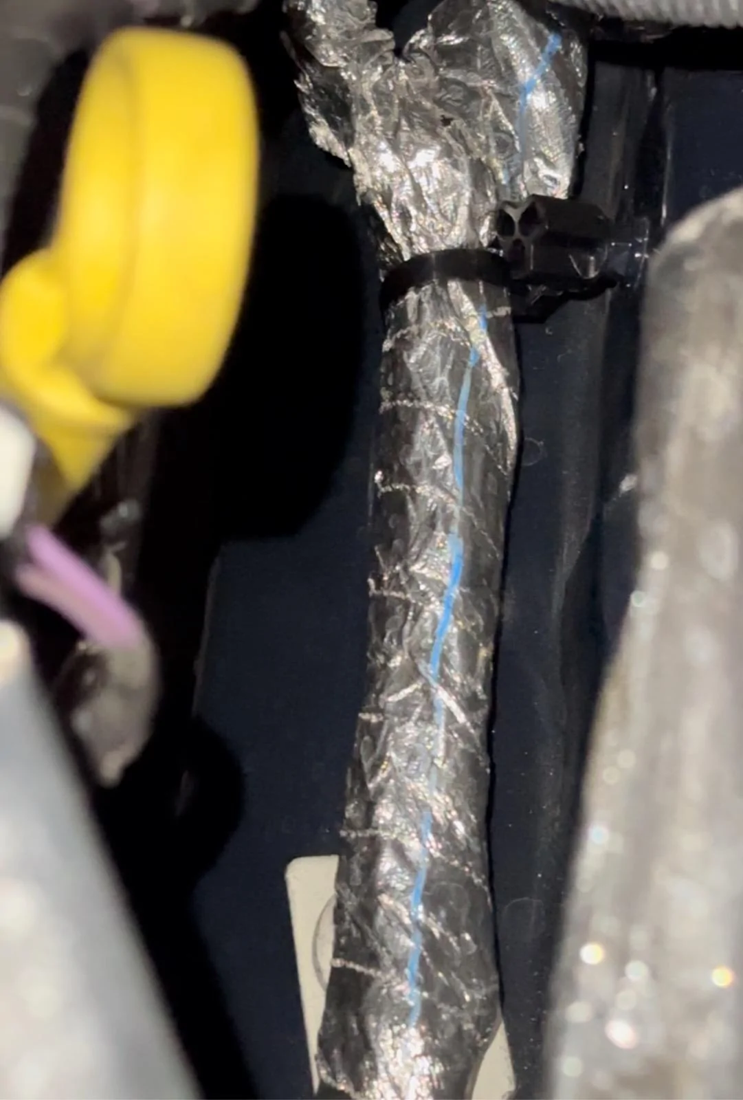

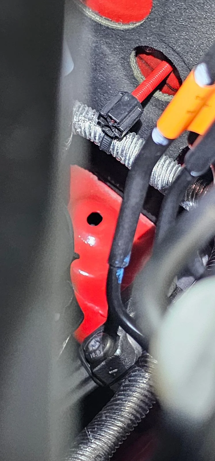

Mine was attatched on firewall but off on what looks like a wiring harness about a foot prior to that towards front.
Clutch cable is on header side of that clip
S650 Mustang Recall 24S36 - Leaking Hydraulic Clutch Pressure Line 20240606_174746
S650 Mustang Recall 24S36 - Leaking Hydraulic Clutch Pressure Line 20240606_174619
S650 Mustang Recall 24S36 - Leaking Hydraulic Clutch Pressure Line 20240606_174935

Thanks for sharing - Foot prior more towards the front has no exhaust tubes running there. Did you mean closer to the brake fluid reservoir?

Yes ... you can see header in backround of third pic

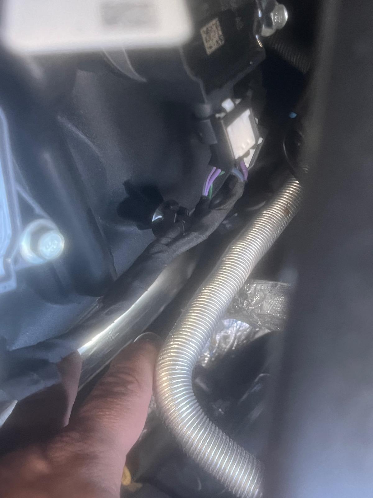

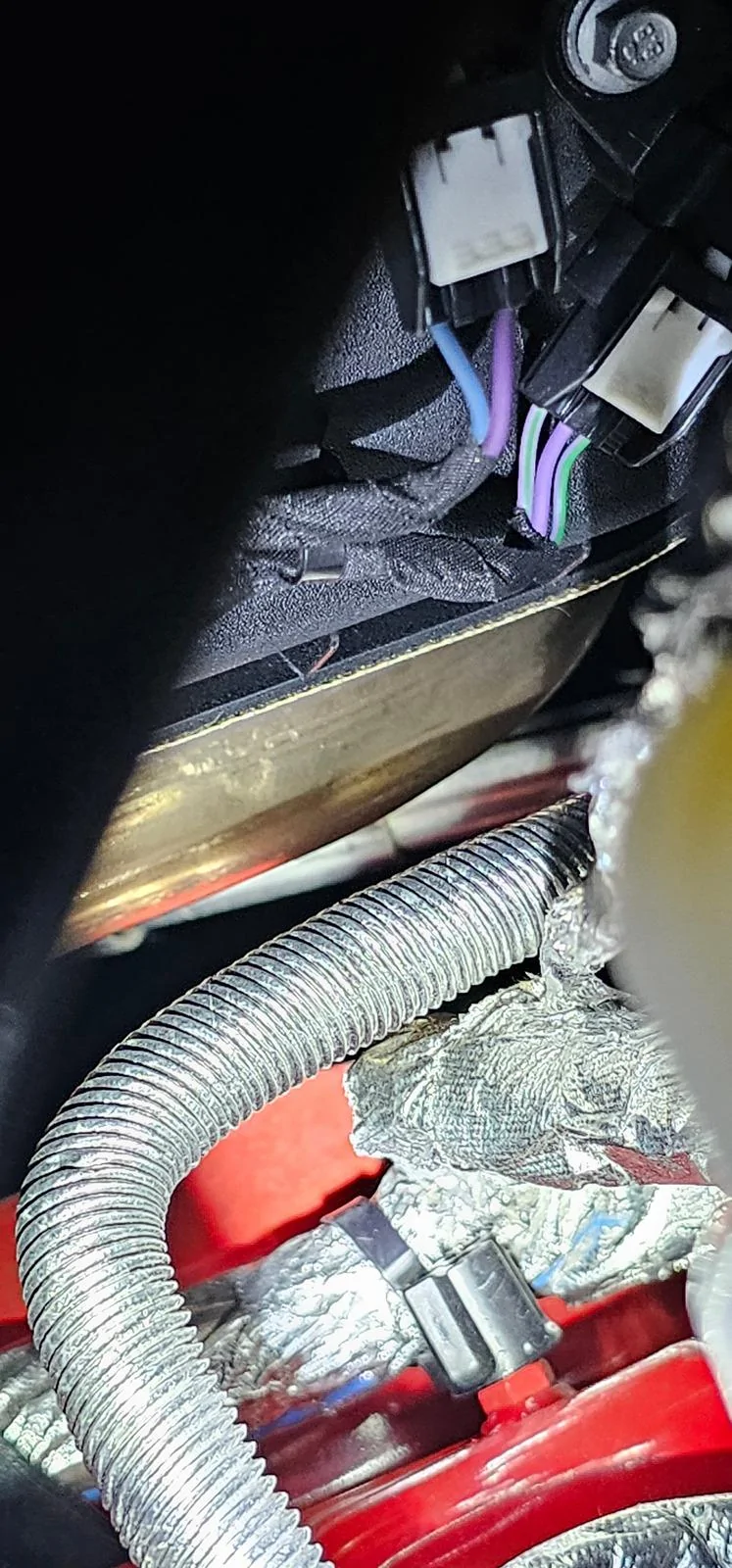

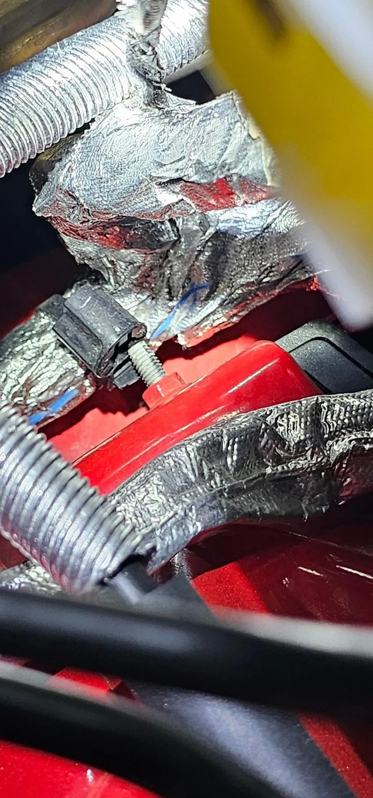

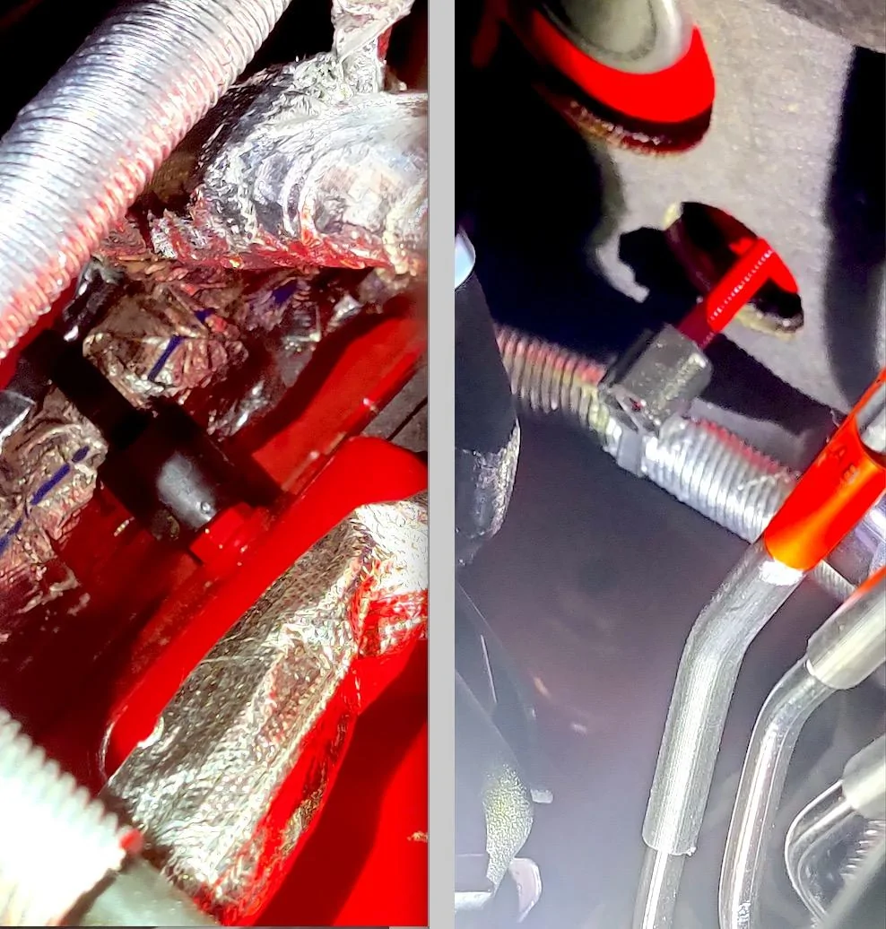

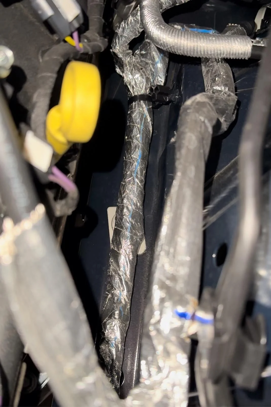

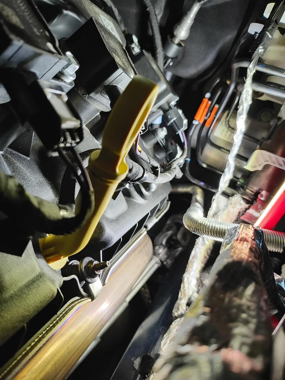

I checked this morning on my Dark Horse and mine was not installed correctly. Over the years owning Fords I have found many wiring harness supports and hose supports that were not installed at the factory. Mine was clear of the header so it should be all good now. I will email my service guy and send the pics and get the recall completed.
S650 Mustang Recall 24S36 - Leaking Hydraulic Clutch Pressure Line IMG_20240607_074516063
S650 Mustang Recall 24S36 - Leaking Hydraulic Clutch Pressure Line IMG_20240607_074919601
S650 Mustang Recall 24S36 - Leaking Hydraulic Clutch Pressure Line IMG_20240607_074933869_HDR
S650 Mustang Recall 24S36 - Leaking Hydraulic Clutch Pressure Line IMG_20240607_074545903_HDR
S650 Mustang Recall 24S36 - Leaking Hydraulic Clutch Pressure Line IMG_20240607_075004236_HDR
RiksDH
Nov 8, 2023
48
New Jersey
2024 Dark Horse, 2023 Cadillac Escalade Sport.
I'm of two minds on that...
Mind 1: The tech that sees it off the post may be more inclined to do more inspection down the line if they see that I'm in the "affected" group vs just a "thumbs up". Good news is the dealership is like 8 mi away from me so it won't be cherry red by then (and it's been plenty warm enough before now to cause issues, so I'm just lucky at this point too).
Mind 2: On the other hand I also know it's an easy "fix" and I know I'm now in an "At Risk" group...
If my appointment wasn't first thing tomorrow without me having to drive till then I'd fix it immediately. (Edit: Oh and... the fire extinguisher's going along for that ride too... if the clutch gives the entire area's getting doused, lol)
I agree with his down the line Point.

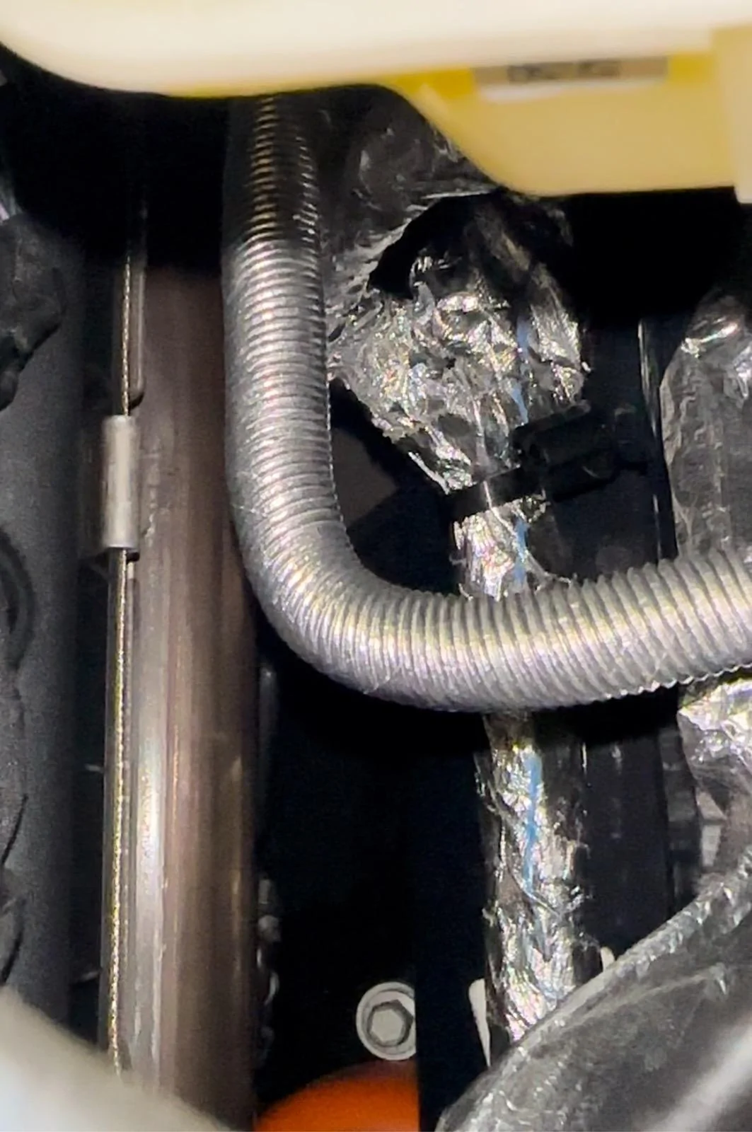

This is my index finger between that very line and my Long Tube Kooks Headers. 3/4 of an inch cleaance.. 🤷‍♂️
I just wish the clip would slide all the way onto the threaded stud.

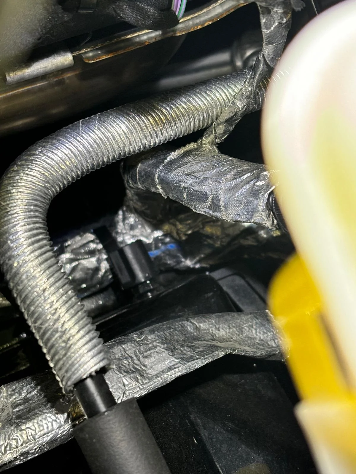

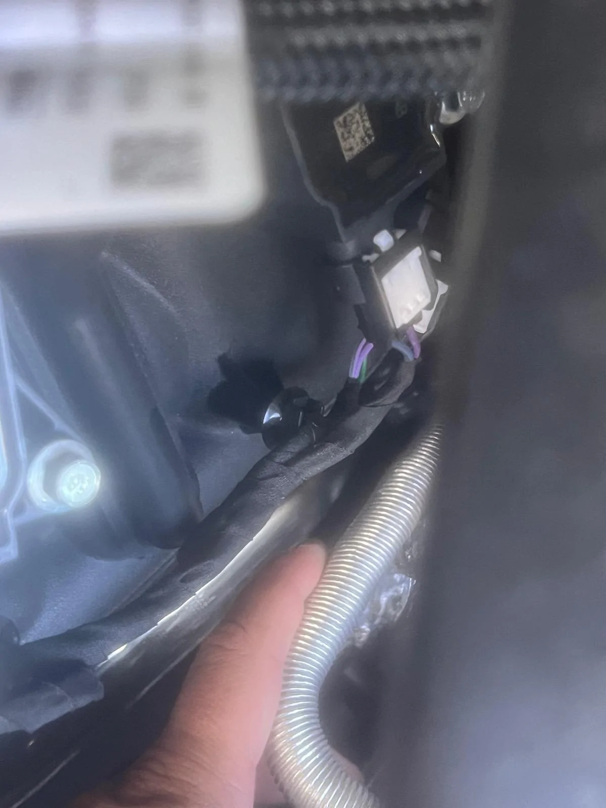

Thanks for all the inputs - mine looks good from the get go.
There is more than an index finger clearance for me from the headers, zero wiggle/play in each of the studs too.
