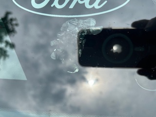

So here are a couple of pics. I'm terrible at pics as you can tell. The black stuff is the epoxy which is also on the metal mount. The clear stuff seems like clear epoxy of some sorts and it's not evenly applied but very bumpy. I was thinking of scraping just enough of the clear stuff off to allow for clean glass for the steel mount, gluing it back on with 3M adhesive which I have used in the past and is very strong, and putting it back together?

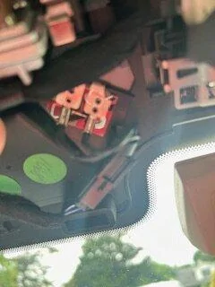

One last question, in the pic with the 2 wires. They were both disconnected so I put them back as they were laced (shorter on nearer terminal, longer on farther terminal ) Anyone know what they are for? Grounds maybe? TIA.

So local dealer asked me to stop by tomorrow so the techs could take a look and see if any parts need to be ordered. Honestly I have never experienced anything like this before. I've reattached many a mirror mount but this one is quite different as the pics show. Seems to be a combination of black epoxy on top of clear 'epoxy' . So I will update after dealer techs look at it. I'm hoping the entire windshield doesn't need to be replaced. I'm not seeing anything in the Ford Factory Shop Manual about replacing just the mount but I'm just learning how to navigate that so I might be missing it.

So I stopped by the dealer this morning to have them take a look. Apparently Skye was correct in that the glass itself is damaged hence the wavy feeling clear epoxy or whatever it is. So the dealer took pictures to send to Ford to see if they will cover it.
Huh?
A $50k car and Ford won't cover an obvious glass manufacturing defect? There is no damage on the outside of the glass so I asked the service manager exactly how else this could have happened other than a defect? He had no answer but said if Ford refuses to cover it, your insurance will.
