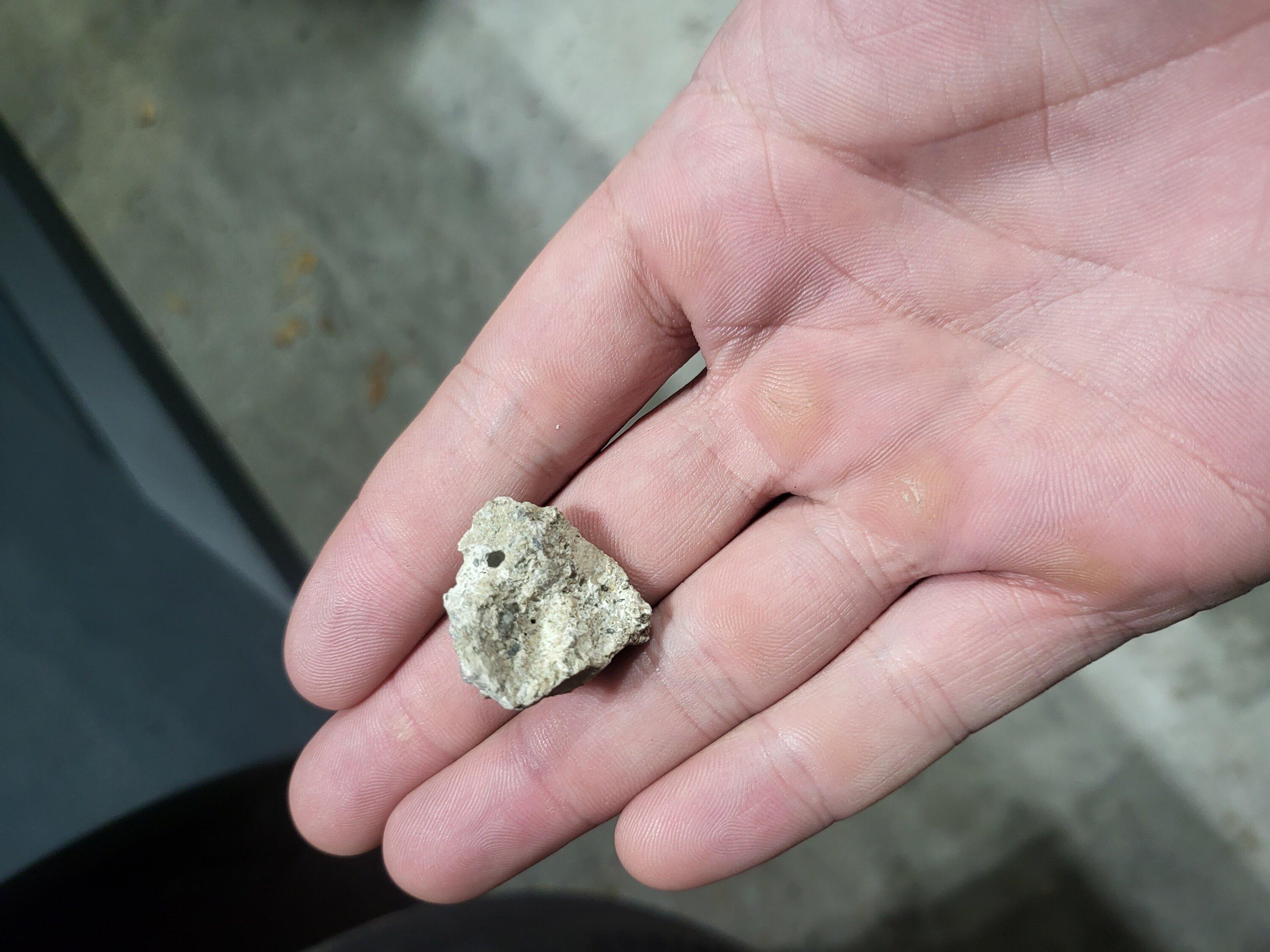

I had a similar issue the other day driving home from work. I absolutely hate rattles and unwanted noise. My car, a base vapor blue DH, was perfect for the first 500 miles. So good that I mentioned it to my wife. Later that day after work I thought I willed it into existence as the car suddenly had a very hard to pin down driver side rattle. After another 300 miles I was ready to tear the car apart. My wife actually looked on this forum and found something about the rocker pannel clips. I checked mine and that was not it but I noticed they were hollow so I started tapping on them. Sure enough I hit the right spot and heard the rattle. There was a fairly large rock inside that had got trapped. I was able to get it out and the rattle is gone. There is a large gap in the wheel well where it meets the rocker pannel. This may not be the exact location of your rattle but do to all of the trays under the car it may not hurt to start knocking on them and see if you find any foreign debris that has become traped. I would have sworn mine was in the driver a or b pillar or was trim related. Good luck in your hunt!

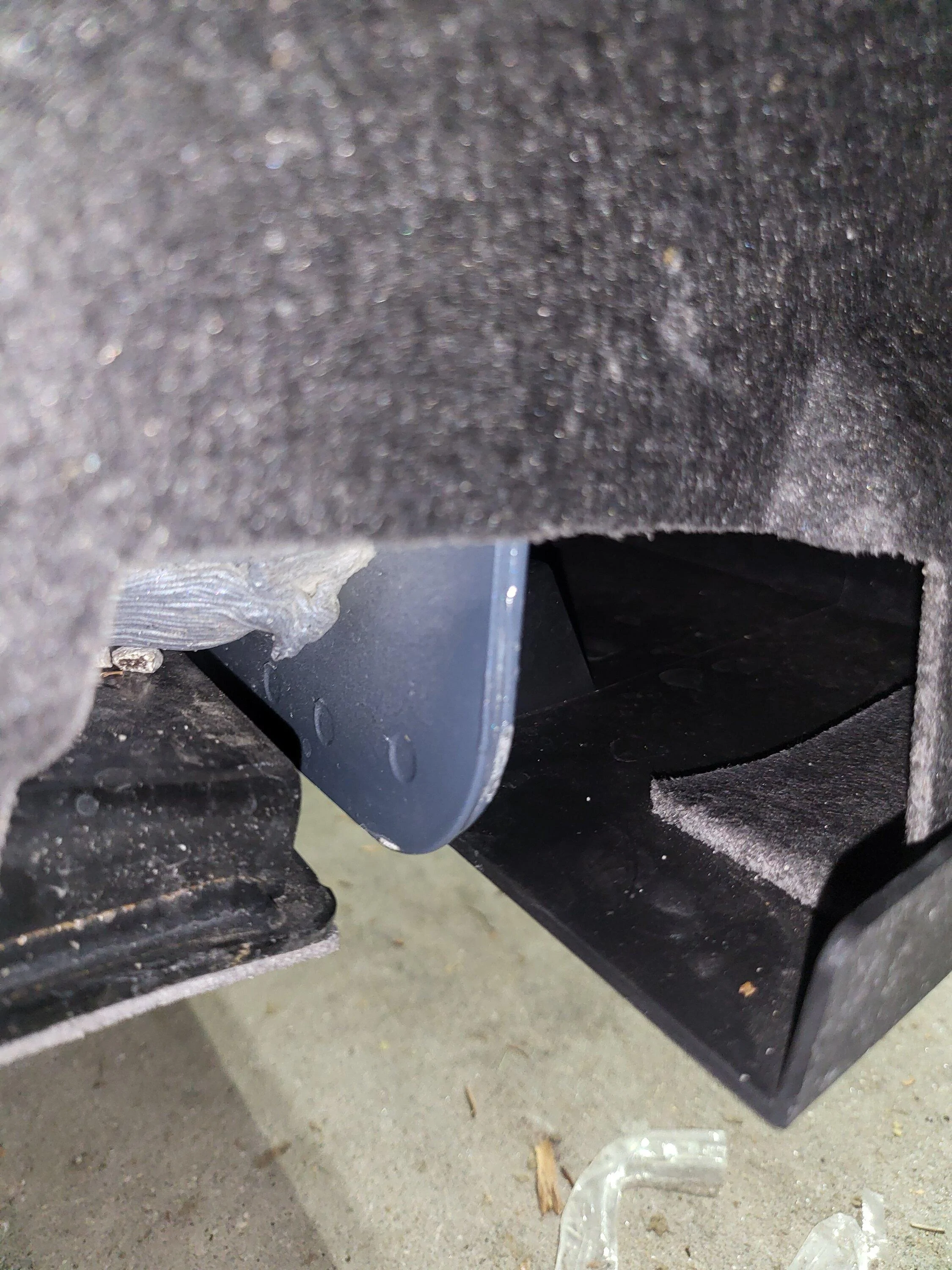

Anyone else experiencing a rattling noise from the rear passenger area? It’s only if I hit a bump only on that side, if the entire car or the driver side hits a bump I don’t hear it. It kind of sounds like hard plastic on metal, not quite metal on metal but I could be wrong.
I initially thought it may be coming from that C pillar but after taking it a part and adding some insulation and electrical tape I’m not so sure now. Not really seeing many reports of others having this problem so figured I’d reach out before I start tearing the trunk apart next.
After ripping the inside apart and securing down things that could make noise and adding sound dreading stuff. i finally took it in for this. Been there a week. told them to look at shock hopefully they do.
