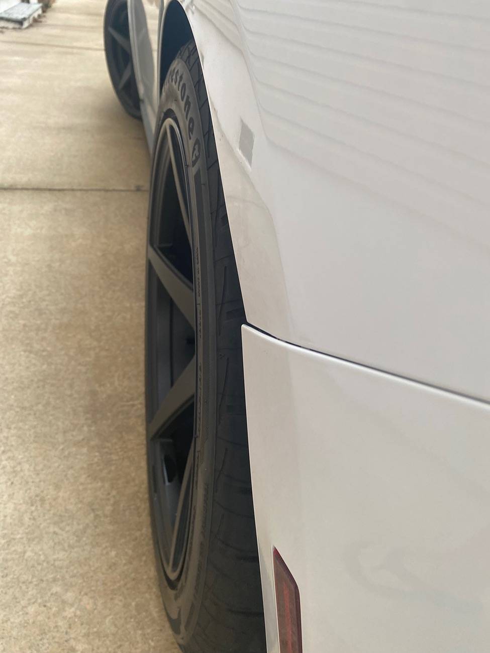

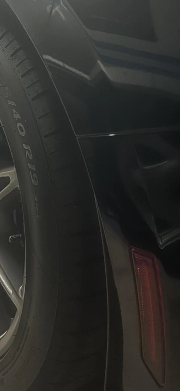

I just installed mine today and backing out those screws were a little troublesome but for me it was getting the ratchet positioned correctly between the fender well. It was a tight squeeze and took some time backing them out.
The problem I had was putting the bolt back in and getting the bumper aligned. I did what I could but now there are gaps on both sides where the screws are located.
In hindsight I should have taken off the back wheels. It definitely would have made things easier.

Is this the end result? Does this mean you have to accept this bad panel alignment like this after the install? Oh my, I will not touch any screws from the bumpers after seeing this.

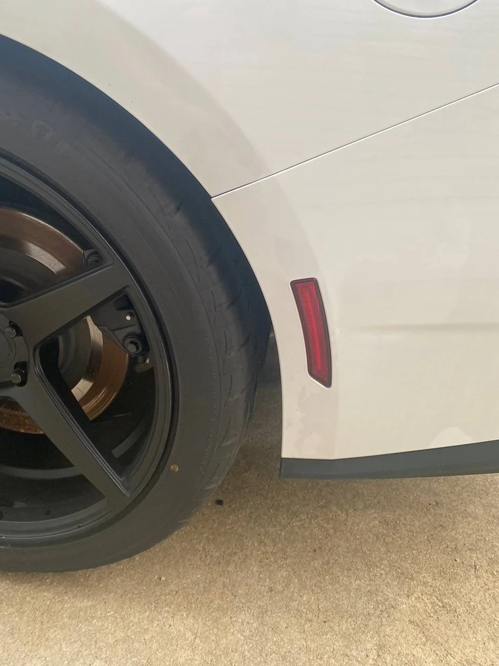

If I would have known that I would create that gap, I wouldn’t have worried about the side markers because it’s driving me nuts. The hole on the bumper tab isn’t exact and there’s some play in it so I’ll have to readjust the bolt to get the bumper more flush.

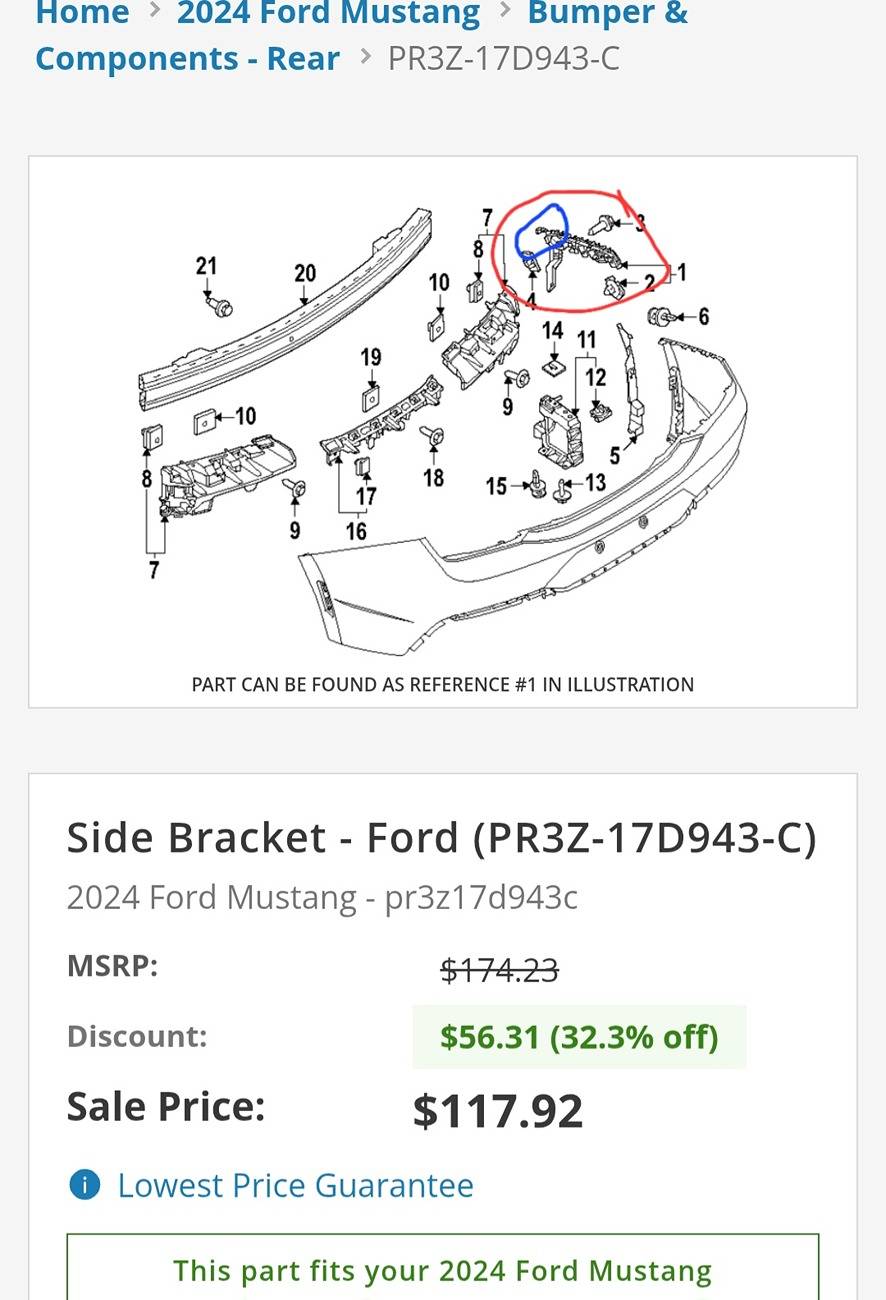

The plastic scew nuts, if over tighten at the factory will need new ones. It will never get tight again. I haven't taken off a rear cover on these yet. If it's incorporated at the the end of the bumper stay, might need a new one. Another option is get a bigger threaded screw so you can actually tighten it.

Looks like is part of the side bracket, which isn't cheap and you would have to pop the cover off to replace it. If you try a slightly bigger screw go easy, use some lithium grease. Otherwise you will brake the side bracket. Unfortunately plastic covers are meant go on once, we replace the side brackets every time. Nothing is easy anymore.

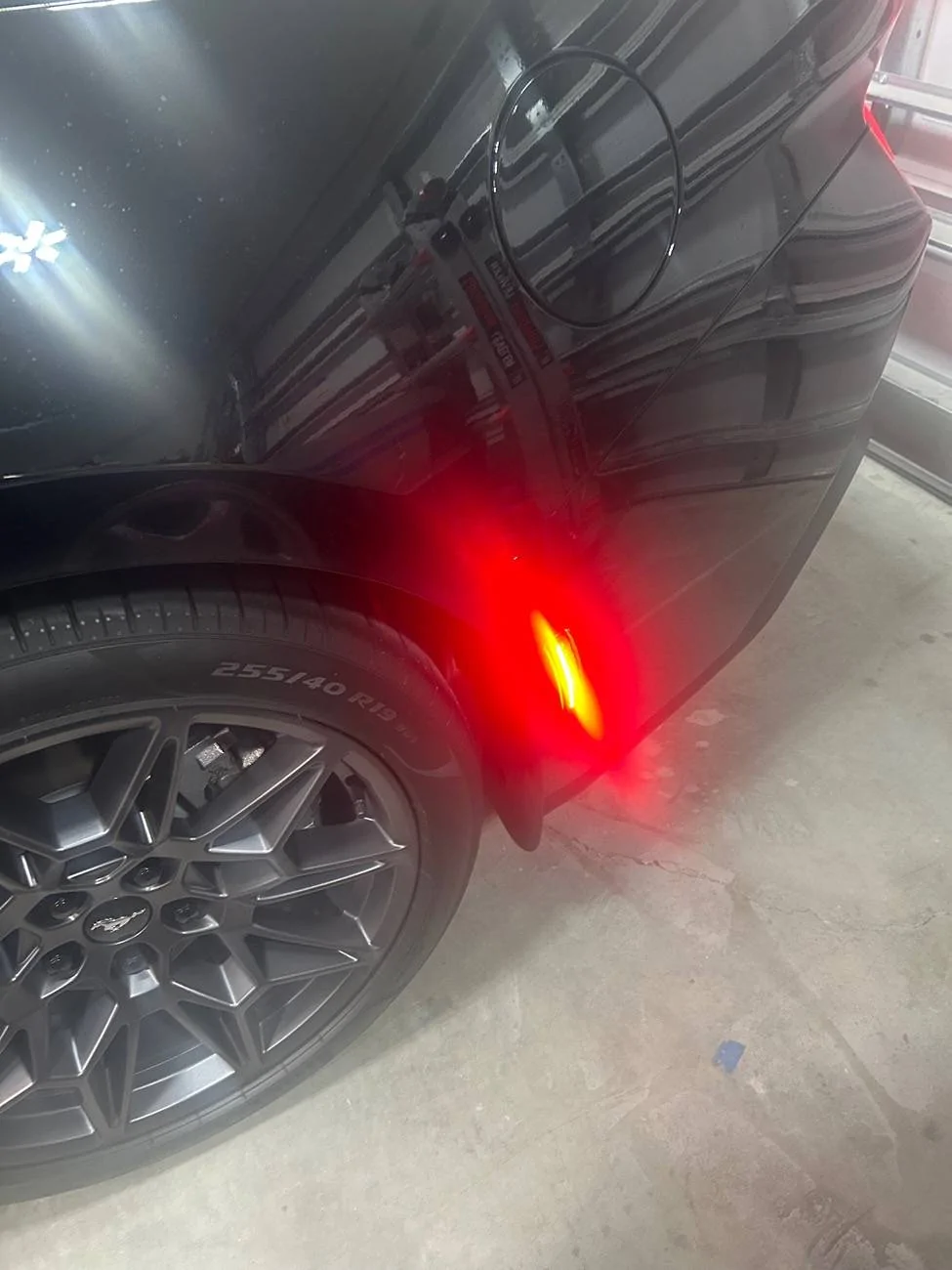

I did this mod with no issues. The screw came out easily… but it goes into a white retaining piece that might spin. Hold it with a needle nose and you should be good.
I pulled the bumper out all the way - didn’t mean to, but it separated all the way to the back. That made access to the stock side marker very easy. You just need a long screwdriver to help push the tab out.
The new side markers just snap in.
When pushing the bumper back into place, I started at the back and worked my way toward the wheel well and it went back in easily.
Important: the very front of the bumper, by the tire, has a tab that goes in between two other pieces. If you put it under the two pieces, it may cause that gap. Then screw back in the 7mm screw, holding the white insert with a needle nose.
I would not do this with the tire on. Worth the time to remove it.
A bad pic, but at night the entire side marker lit up looks great!
S650 Mustang Rear fascia screw issues. IMG_7509
Best pic I can get to show the bumper back in place after the install:
