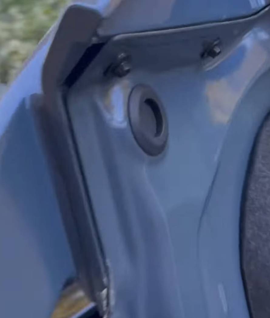

Bought and replaced the spoiler delete on my '24 ecoboost with a wing take off from a '24 GT. Only issue I ran into is that the screws seem to be a different size for the 4 smaller screws that hold the spoiler panel to the trunk lid. Picture included, does anyone know where I can find the information on the makeup of these screws so I could get a facsimile, or maybe A GT owner who could send me a high res photo with sizes?
Thanks.

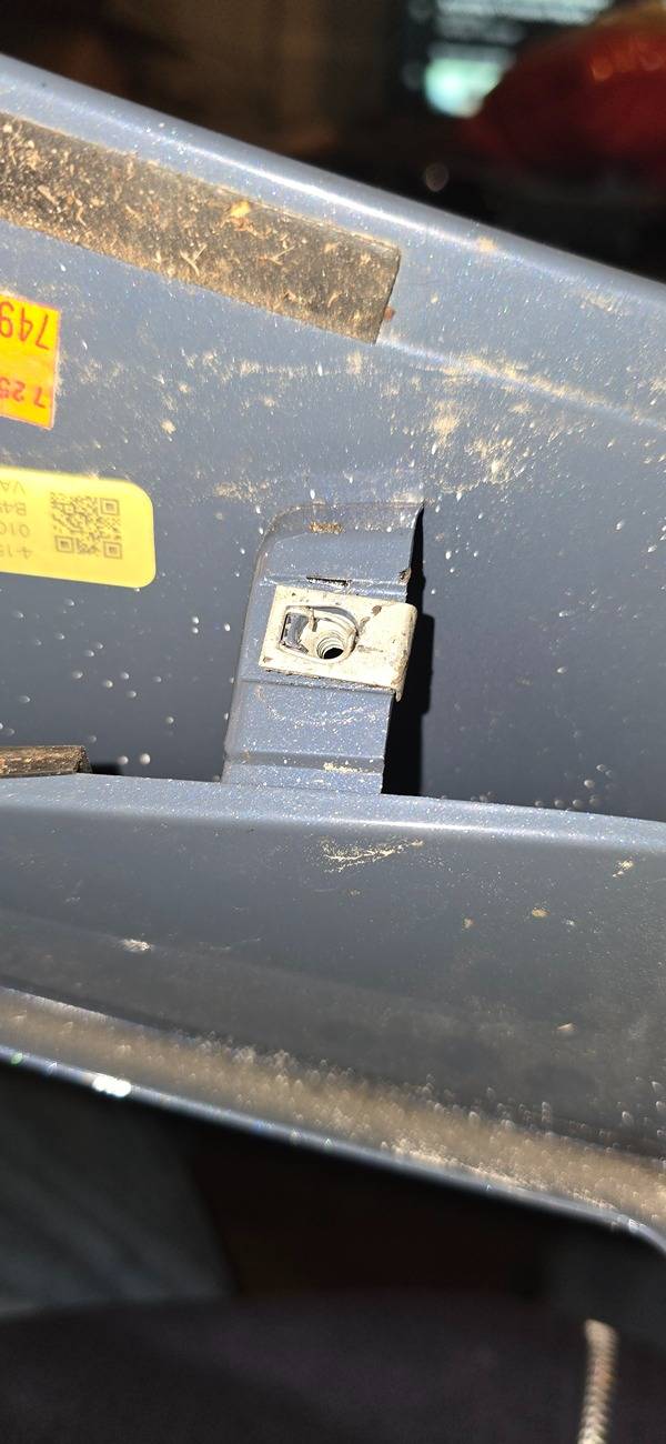

Welp. Took a look at the old spoiler delete module. Found the issue. Looks like the guy that sold me the wing took these tabs off that had the screw receivers in them. I'll have to take the wing off and put the copies I thankfully have from my old spoiler in their place.

Yea those are necessary theres a few that need to be transfered over. I have a module with the air design wing but i find it too flat compared to the s550 ducktails so i have my dh replica spoiler on my other blank. The bolts are either 7 mm or 10 mm i believe its 10mm though.

Hi, i had the same issue, go to auto zone get m6 10mm or 16mm, they are like 3$. i used 16mm fits perfectly, but u can also use 10mm and it will fit to
