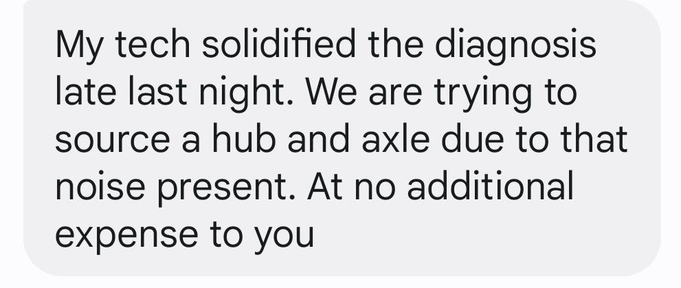

I just got an update from the Ford dealership working on my car and they've identified the source of the noise as the hub and axle assembly. They are in the process of sourcing the parts under warranty. My car sounds identical to the video posted by @Stang24

So they’re going to be replacing the hub and axle assembly then?
