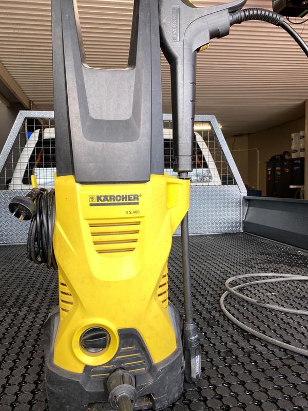

A basic Karcher K2 running 1800 psi and 1.6 gpm (6 lpm) from the stock gun. I used this for many years and while it delivered decent foam, the flow rate is just too lean for it to be efficient, in fact a garden hose will rinse a car faster than this will. When combined with the set up / pack up time and low flow rate, you may as well stick with a garden hose.

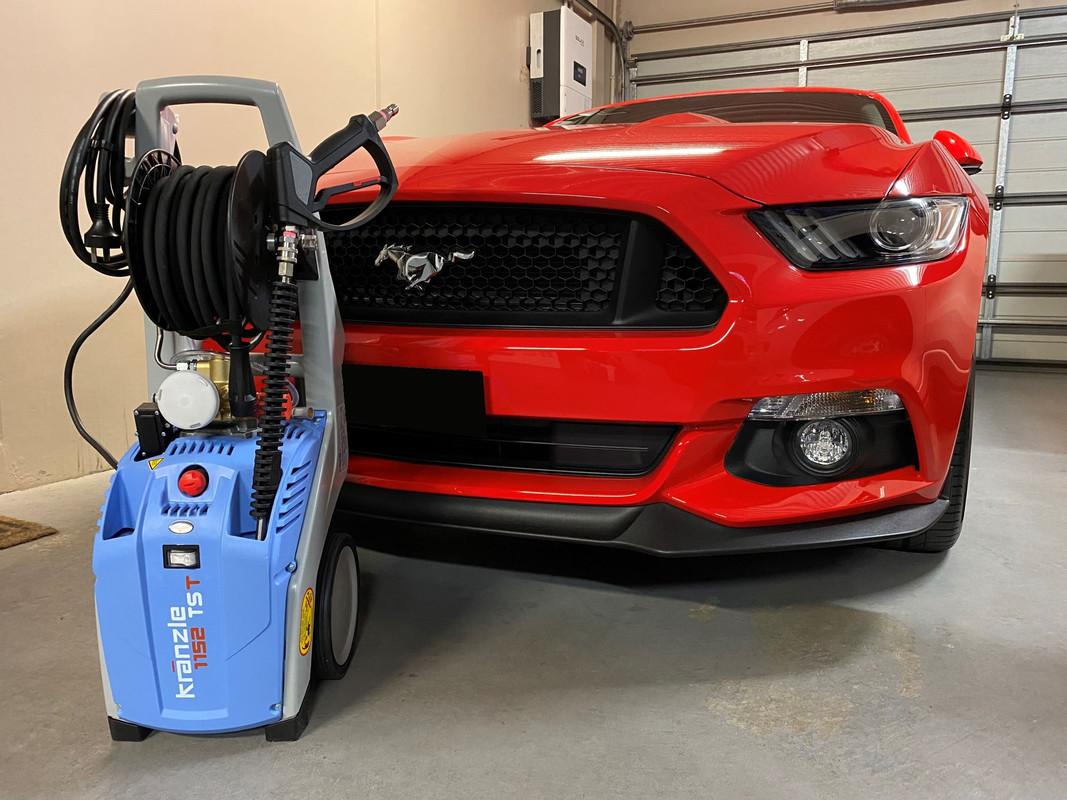

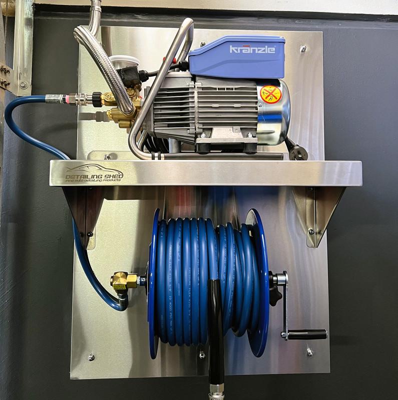

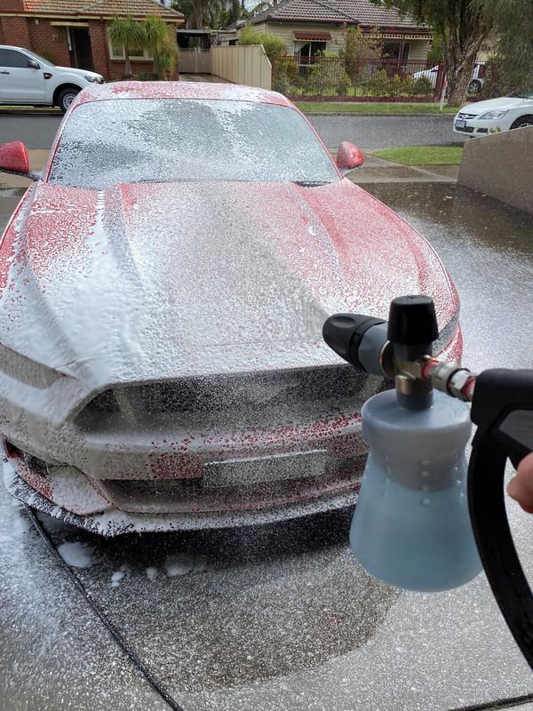

A Kranzle K1122 (K1152) will do 1000 to 1400 psi with 2.0 gpm (10 lpm). While that might seem low on the pressure side, its more than enough to generate great foam, but the flow rate is so much better that it eclipses what a garden hose can achieve. I've ran one of these, then a KHD-10 for 4 years now and its well worth the money.
S650 Mustang Pressure Washer Recommendations jun1
S650 Mustang Pressure Washer Recommendations IMG_5966
S650 Mustang Pressure Washer Recommendations IMG_5971
S650 Mustang Pressure Washer Recommendations Final_Result_1

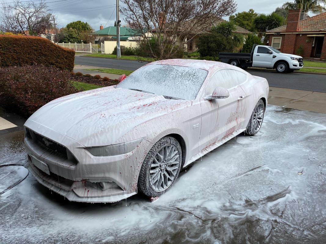

This is 2.6 gpm at work.......................
If you don't want to spend that kind of money, I could name countless others to look at, but the Active 2.0 is the one to buy. This machine was specifically designed for car washing, as such its 2.0 gpm flow rate is unbelievably good at the price point, nothing gets close in terms of flow vs cash spent. Naturally, it won't have the lifespan or serviceability of the Kranzle units, but run it until it dies, then transfer the aftermarket upgrades to a new machine.
Addressing the safety of using a pressure washer on cars, I think there is a line where it is considered safe and where its considered dicey. For me, that line is anywhere between 1000 to 1500 psi, which can easily be adjusted using different nozzle orifices. Doing that, you can make the unit flow as much as possible, balanced against a pressure within that 1000 to 1500 psi range. Put it this way, on my KHD-10 which is flowing 2.64 gpm (10 lpm) and 1400 psi, I can hold my hand in front of the nozzle with the machine running and not hurt my skin..................that's good enough for me.
