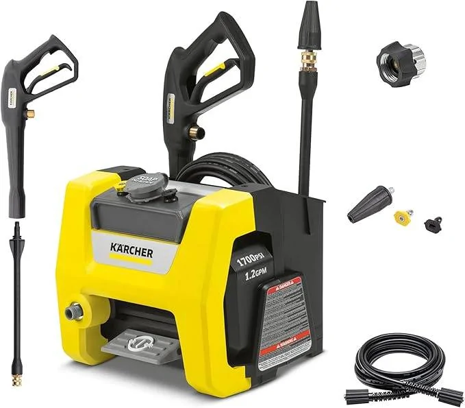

Staying close to the price point of the Greenworks, I would look at the Karcher Cube 1700 or 1800 instead. These two produce similar numbers but are far superior machines. You can get these in static or mobile forms. For the slightly higher price, you get a better machine all round.

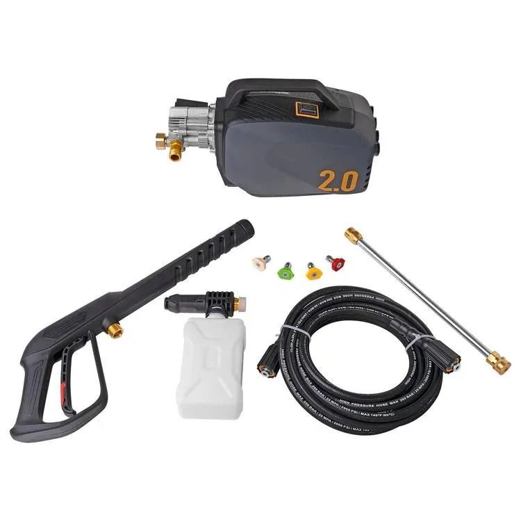

If you are willing to spend a little more, I would 100% being going for the Active 2.0. This machine was specifically designed for car washing in mind, so it flows extremely well and has a tailored pressure rating. Put it this way, the Active produces almost twice the flow of the Karcher and Greenworks, and on par with a considerably more expensive Kranzle or AR Blue. It will also last longer than the Greenworks. This is the best entry level pressure washer on the market, it costs little more than the usual suspects, but it offers a better user experience.

I'm using the Active 2.0* after a recommendation from @DFB5.0 and the results are awesome.
* = recommend you get just the pressure washer alone and not the full kit; spend the difference on a better gun, hose, foam cannons, 5.0 nozzle, blah blah blah.

I have an Active 2.0. Best value for the money for personal use, AFAIC. I did my homework, too, and @DFB5.0 was part of who/what influenced me as well.

You're not getting something under $200 that is like an Active 2.0. Use bigger orifice nozzles for less PSI and more GPM.

Looking at the specs, the Karcher Cube 1700 produces 1700psi, so probably closer to 1600 out of the nozzle.
