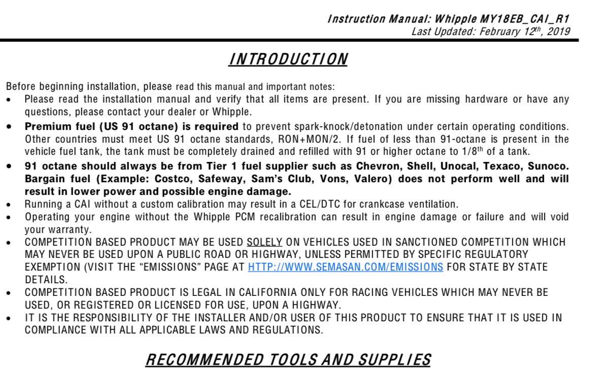

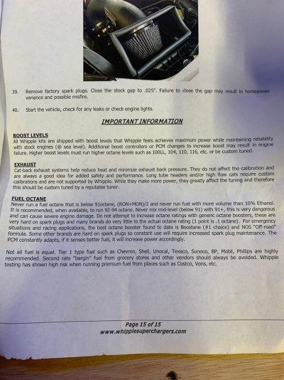

I do find that comment from Whipple very interesting. Costco is Top Tier and when tested, shown to be at its rated octane. I’ve used it for years and never had an issue.
again, "top tier" just means it has a certain detergent package
Costco has has had a bad reputation on the forums for years, especially with supercharged cars

I’m well aware of that. I was referring to the statement from Whipple.
I‘ve been on here since 2015. There have been many treads about gas quality. Overall Shell and Chevron have had the least amount of issues (but not perfect). Costco, for the most part, has always been considered excellent gas.
I found this interesting.
https://bobistheoilguy.com/forums/threads/a-question-about-costco-gas-additives.350836/page-3
