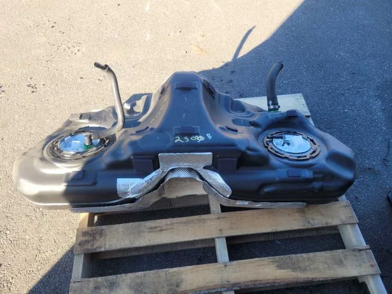

Has anybody cut open a fuel tank and looked inside? Do you know how it operates?
How did Ford design the transfer of fuel from the passenger side to the driver side, where the fuel pump is located?
Obviously, it cannot get over there all by itself. Just look:

I'm under the impression it's nothing more than gravity.
Look at the photograph. Gravity would never accomplish anything unless the car tipped over and came to rest on its driver side door.

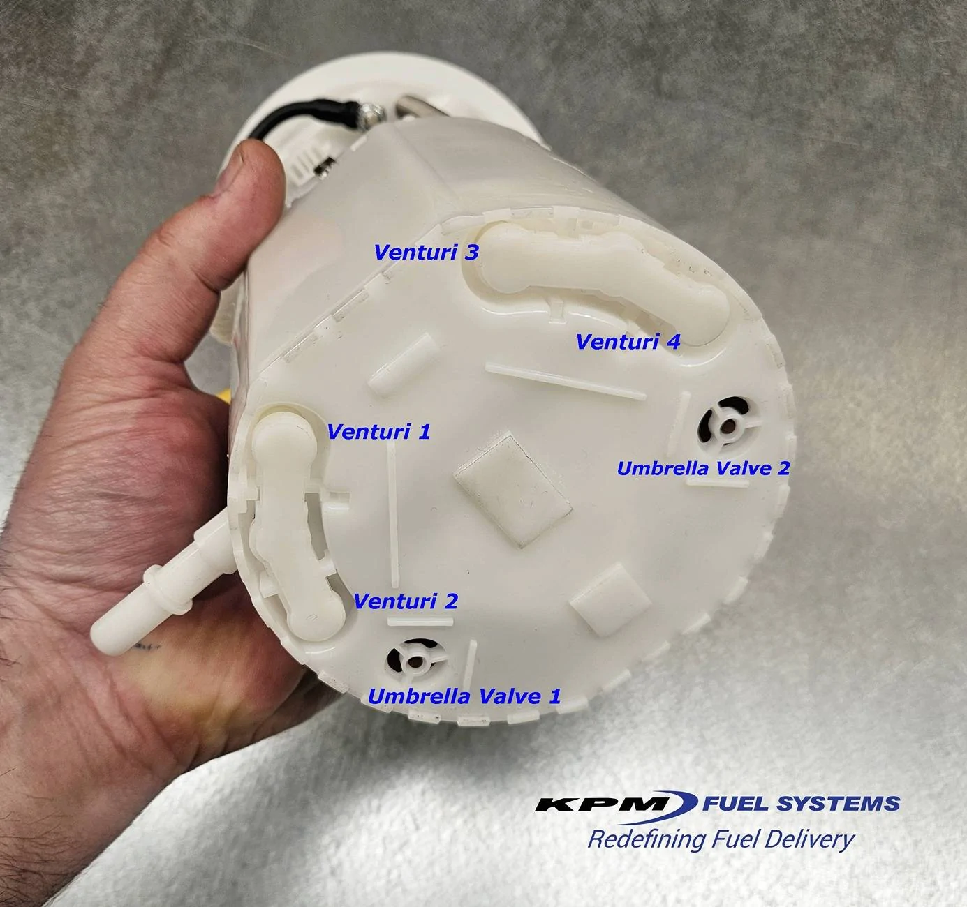

Also from page 3, by KPM:
"The KPM fuel bucket requires 10lph for each venturi jet. 4 venturis jets = 40lph total
Each venturi siphon draws 363lph from the tank into the bucket 4 venturi siphons = 1452 lph total
1452lph - 40lph = 1412 lph bucket refill rate."

So I read the whole thing, and if I am understanding what I read correctly, the problem is not that the driver's side goes dry, while all the fuel is over on the passenger side saddle (the theory I have read here on the forum) but that there are only two venturi. When cornering hard, one venturi cannot pull the fuel from the passenger side. The remaining single venturi is not sufficient to keep the pump canister full.
In the KPM system, under hard cornering, there are still multiple venturi keeping the canister full when the venturi drawing from the passenger side are unable to over come the G forces.
Do I have it right now?

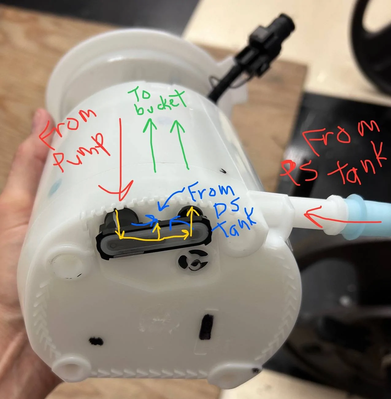

For comparison, here is the stock pump. Four venturi and two umbrella valves in the KPM photo above v. two venturi and one umbrella valve in the stock photo below.
DS = Driver side
PS = Passenger side

engineermike wrote, "Yes, kpm and oem have this figured out. Once the level falls below the hump, it does its best to keep all the fuel on the drivers side by way of the overflowing bucket. And with the way the venturi pump and vapor separation work, there is no concern about getting air sucked into the pump as would be the case with a pump on each side."
