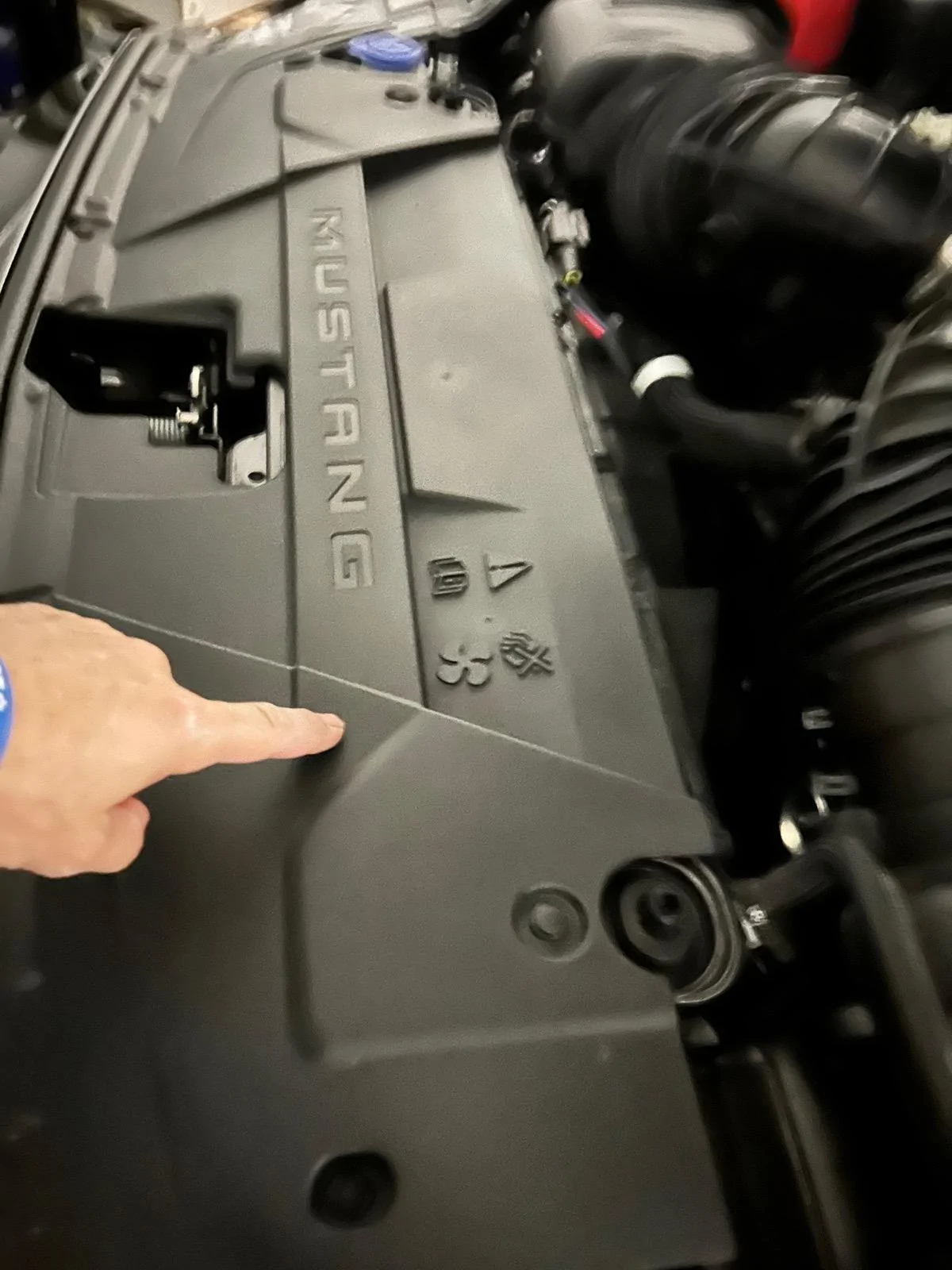

Yep. Just remove top cover and reach down. Does take a steady hand.
Wdym top cover? i havent seen a way to do it thats not removing the bumper. I have a black pony waiting to go on until i have time to drop the bumper.

I think he’s talking about the top cover over the radiator. I believe it has push pins holding it in place and goes over the hood latch opening

Yep..
S650 Mustang Pony badge on front grille IMG_3424

If you have active shutters, you will not be able to get to it this way. Performance package cars do not.
