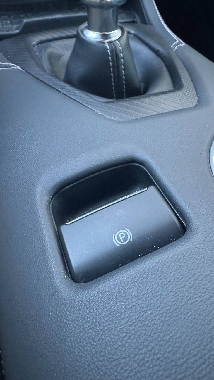

Hey everyone,
Have you ever wondered what would happen if your parking brake failed to release after you activated it? What if the mechanism stopped working, leaving you stranded?
Sure, it’s unlikely—but electronics can fail, and it could happen. So, what’s the solution if your parking brake refuses to disengage when you push the button? What steps can you take to fix it?

It's going to depend on the failure.
Many forum threads reference several "failure" events involving the Parking Brake. Most of these are the inability for the brake to engage at all, an alarm or code that will not clear. No one thing. Root causes range from a physical to logical fault.
Ford did have a recall on the F-150 involving burnt wiring, in what seems to cause a short circuit. In these examples, the brake engaged, locking the wheels. Nothing to do in these examples except to get a tow for service. If there is some type of manual release, I've not read of that.
https://www.caranddriver.com/news/a44690504/ford-f-150-parking-brake-recall/
https://static.nhtsa.gov/odi/rcl/2023/RCLRPT-23V509-7019.PDF
Edit,
https://www.fordservicecontent.com/...A&div=f&vFilteringEnabled=False&buildtype=web
Edit (again) :giggle:,
https://www.fordservicecontent.com/...N&div=f&vFilteringEnabled=False&buildtype=web
^ This is a reference to manually release. But I take it as maybe some kind of electric override. Yes, it could release the brake, but if I have a logic or electrical fault elsewhere...:question: it might be of little help.

there are 2 things i have seen:
1. if the vehicle thinks certain things are wrong, it will constantly try to apply the parking brake as a safeguard. this can be overridden by pushing and holding the parking brake lever to release, but will re-engage the moment you let off. i usually see this when a vehicle has been towed in and needs to be pushed back, so we put it in neutral or tow mode and we have to hold down the lever
2. if the parking brake suspects it has failed or something has gone wrong, you will get a message on the dash "Parking Brake Fault Service Now" or "Parking Brake Limited Functionality Service Now" and the "BRAKE" light will be on. it is still driveable with these messages and will not be in limp mode
the major thing to remember is the vehicle will always try to have it fail to a known condition: engaged. because thats the safer option
