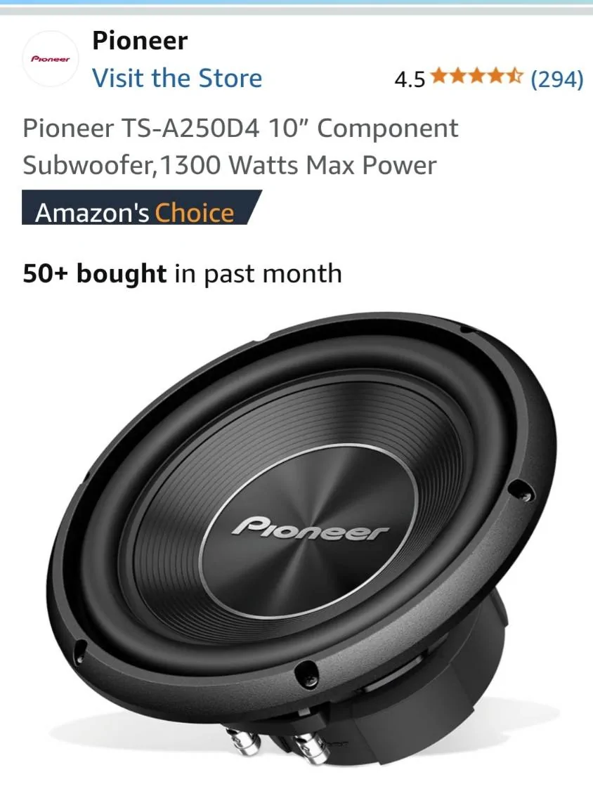

I have an extra ugraded center speaker if your interested. Easy to replace. I also replaced sub woofer woth Infinity 10 in speaker and open grill (from Amazon). About $120 total and it did improve. Obviously if you replace amp and all speakers, it would be better.

What sub did you go with?

Well, now the real work starts. My GT has the 12 speakers system, and I’m pretty underwhelmed with the SQ for what I paid for. I’ll wait a month before tinkering but that pioneer upgraded will be a minimum.

Weird that you get a substantial and comprehensive answer to your extensive OP which indicates you are striving for an audiophile update based on your background and just give thumbs up to no-text mentioning of an almost placebo recommendation of a $70 replacement sub chassis with no additional info on how to actually improve what the sub is fed with.

Sorry if your feelings got hurt, bud. This thread isn’t the only source of info, and there is a lot of feedback on the pioneer being an inexpensive plug and play to get by until a full build can be done. Not sure what you were expecting that caused you to be so mad that you removed your original post with your contribution. Relax.

The Pioneer is a good start, but it obviously won't fix the issues with all other frequencies that hurt ears of people depending on what kind of quality they are used to listen to.
