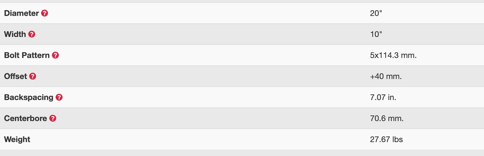

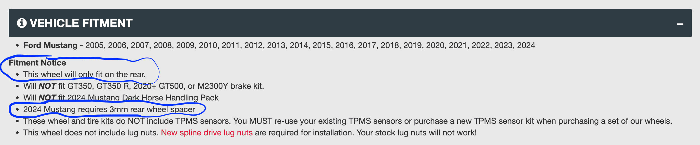

So I have a set of rims I really like. The problem is I want a square setup not staggered. They offer the rim in a front 8.5" width (too narrow for my tire choice) and a rear 10" for a staggered setup. The 10" is perfect for my tire (285/35R20) yet the distributor says it's only good for the rear...with a 3mm spacer.
So if a 3mm (1/8") slide on spacer works for the back. Could and would a 1/4" slide on spacer give me enough offset for the front? Also would the stock wheel studs have enough threads? I have a base GT model so the brake size is of no issue and I run stock suspension. I guess it all depends on the thickness of the rim mounting surface and lug counter sink depth??? I have included pics of the rim and specs. My thought is with the +40mm offset and a 1/4" slide on hub-centric spacer i should be @+33mm offset and a 6.82" backspacing. Which theoretically should work...if the studs have enough length.

Generally +40 offset in that size should fit front and rear, although+35 imo looks better being more flush. Not sure why these are rear only, unless there's something about the wheel shape that won't clear the non PP brakes.

that shape and dish won't be a problem at all. distributors are frequently wrong. Confirm their return policy and/or order just 1 to do a test fit if you're scared.
