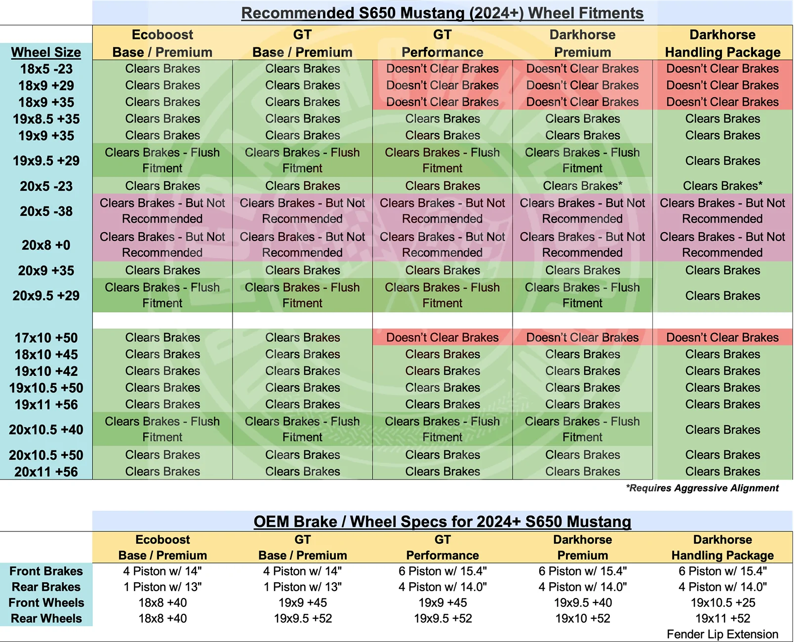

One of our sponsors, Dragracingwheels.com, created the attached; it might help in making offset decisions.
S650 Mustang What offset will work 7G wheel offset

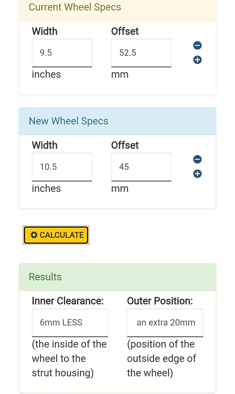

Here's the change from OEM. It's not more than an inch. It's a 20mm difference which is ideal.

Fronts:
9.5/40 to 10.5/25 -> 28 mm
Rears:
10.0/52.5 to 10.5/45 -> 13 mm
that’s my calculation

I agree with that. But you said it would push the rear out more than an inch and "poke." 13 mm won't poke.
(In what I posted before I used OEM PP wheel size of 9.5. Apparently the OP has the base Dark Horse wheels 10 inches wide on his GT.)
