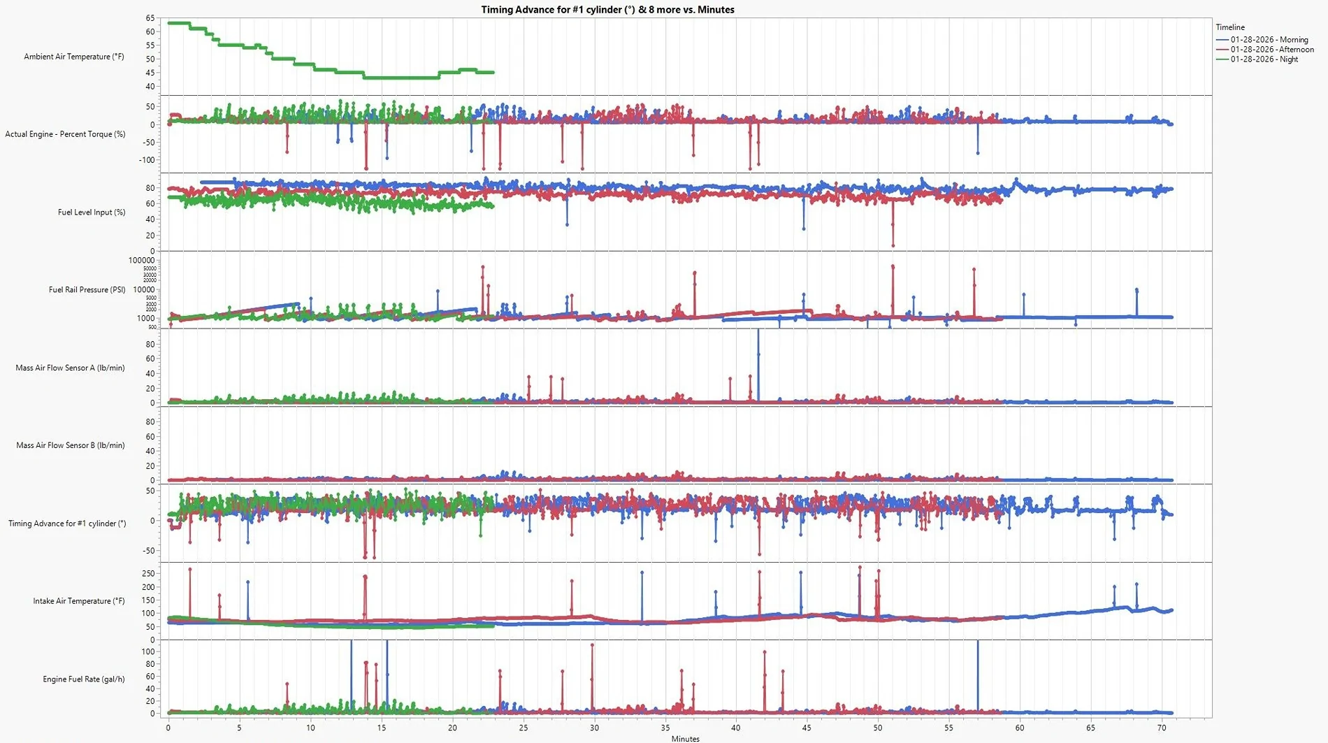

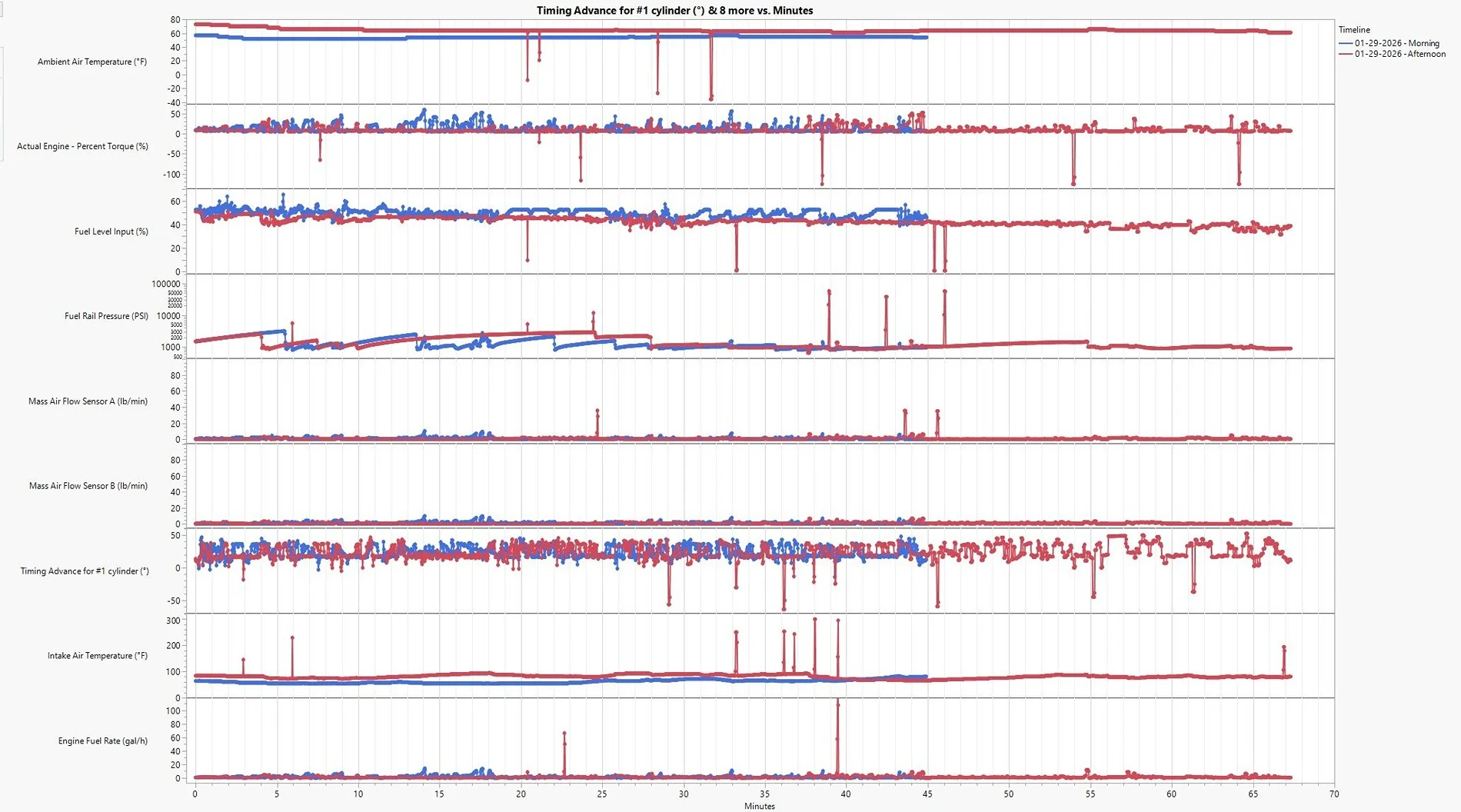

My second concern here is that I see some weird behavior in the live data, like spikes in the inlet and ambient temperatures , torque level, timing advance in cylinder #1 , fuel rate etc. Here are the plots from yesterday and today where I overlay the data with respect to when the ride happened. As you can see the only time I did not observe any of these spikes was last night (green data in the first plot and blue data in the second plot )... So my question is what are those spikes and are they "normal" or is there something wrong going on? It cannot suddenly measure -50C ambient temperature or 250F inlet temperature...

When an engine is in open loop, just about every measured electronic parameter continually changes. It is not uncommon to see spikes, dips, and blanks in the viewed data. And I'd bet, it would be a rare mechanic who could interpret the data just by looking!

The spikes are likely due to your device
