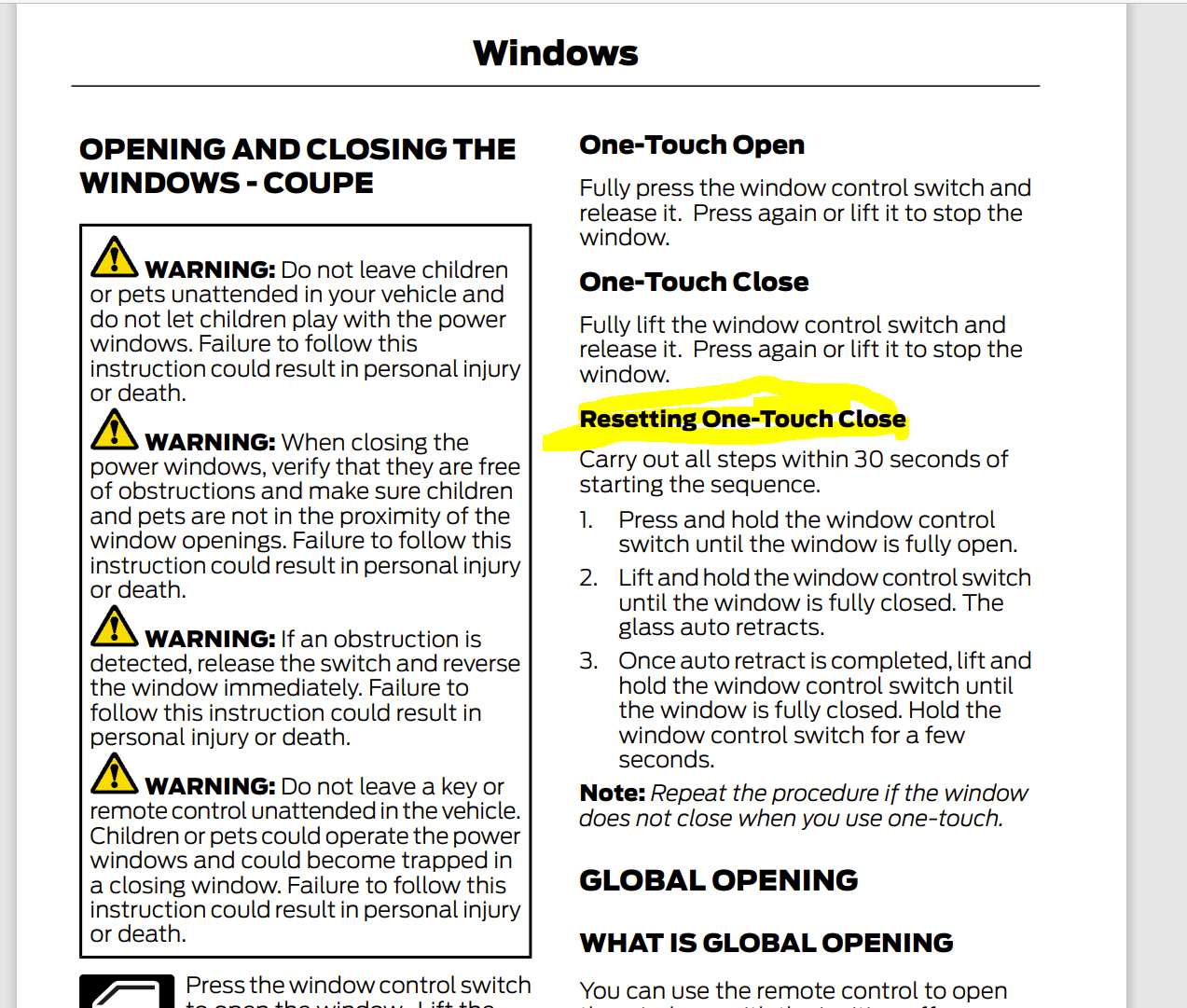

This has happened to me several times now but I initially thought maybe I had bumped the switch until yesterday when it happened multiple times in a row…
Had window down, flipped the switch for it to roll up. It starts coming up and then goes back down. Took me 3 tries to get the window to roll up yesterday.
Have had this happen on both driver and passenger windows.
Thoughts?

Search for Windows Bounce Back. There is a way to reteach the car not do do this. Had this in my F150 and a Bronco I had.
