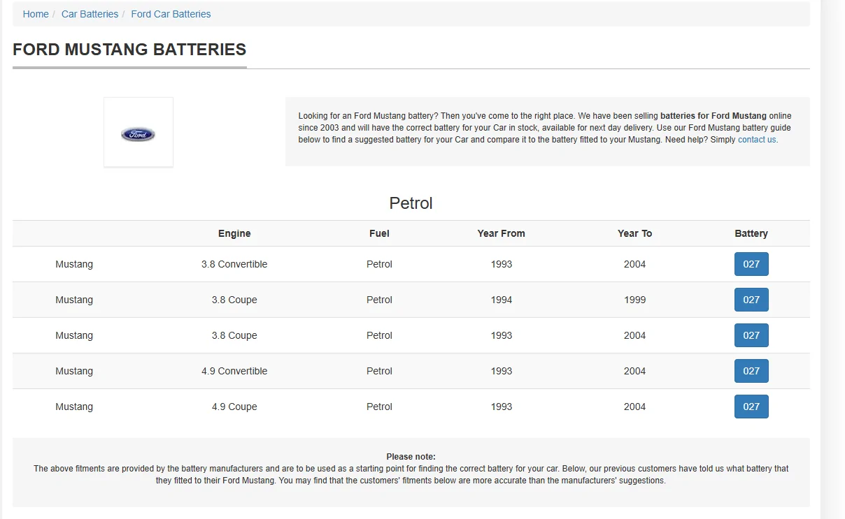

There will be when you know the exact type of battery - it seems the S650 hasn't made it on to many databases yet in the UK
It is an H6 (group 48) AGM... should be able to find one about anywhere as lots of cars use that size.

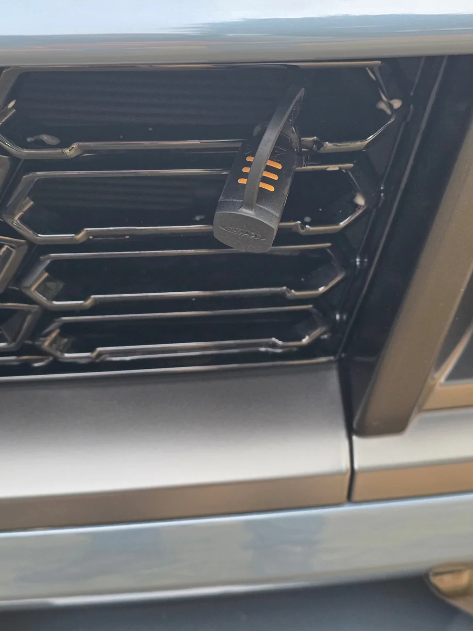

Finally got around to buying a CTEK MXS 5.0 charger to keep my battery topped up. I've hard-wired a CTEK extension to make connecting it up easier (adding a fuse along the way). Done the same with my SLK - too many cars and not enough time driving them!
