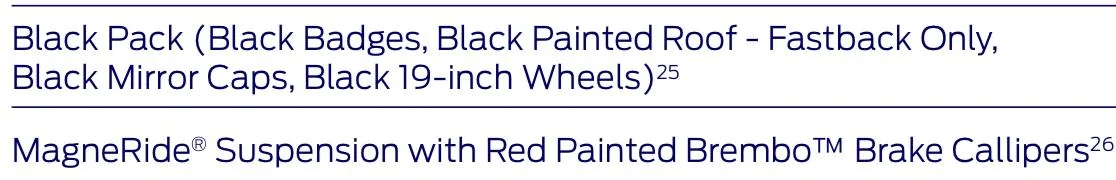

I’m not sure the black bezel headlights are part of the Aussie Black Pack. I would be happy to be corrected though, as this is on my order. Screenshot from FoA brochure:
S650 Mustang MY24 AU GT Differences IMG_2076
Race Red GT
Apr 1, 2015
Glenbrook NSW Australia
1967 coupe, 2015 GT Racered, 2024.5 GT Racered
I agree this was the case but when I recently built the aussie car on FoA build site and looked at info drop down box on Black pack option it said we get black bezels. ( I checked again now ,it is still there ) May be we have a small win .

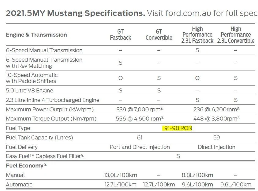

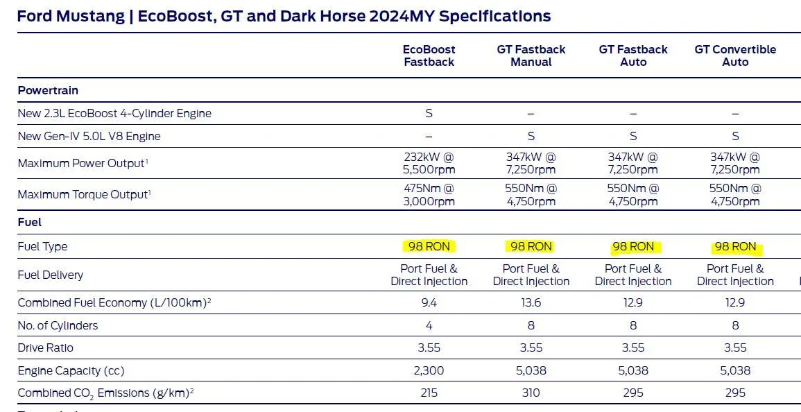

Compared to the MY21.5, another difference is the S650 strictly specifies 98 fuel only.
S650 Mustang MY24 AU GT Differences FN
S650 Mustang MY24 AU GT Differences FO
Anyone recall what their FN CO2 emissions were specified at?
Not mentioned in the old brochure.

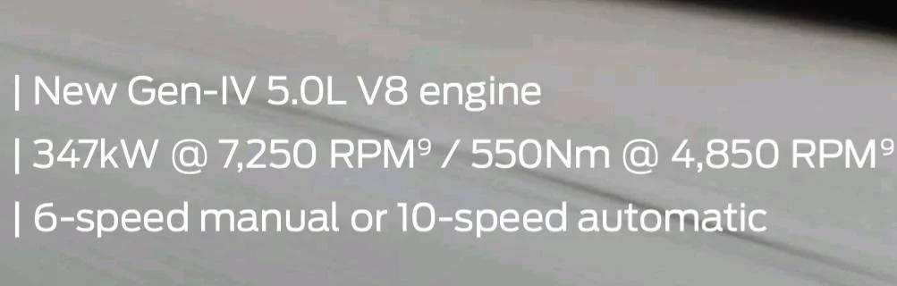

How does 556-500 = 6? Wouldn't that be down 56 ? Maybe my maths ain't mathing....
Typo.
Should be 550Nm, still 6Nm down.
From the Aussie brochure:

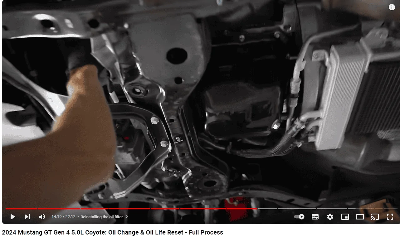

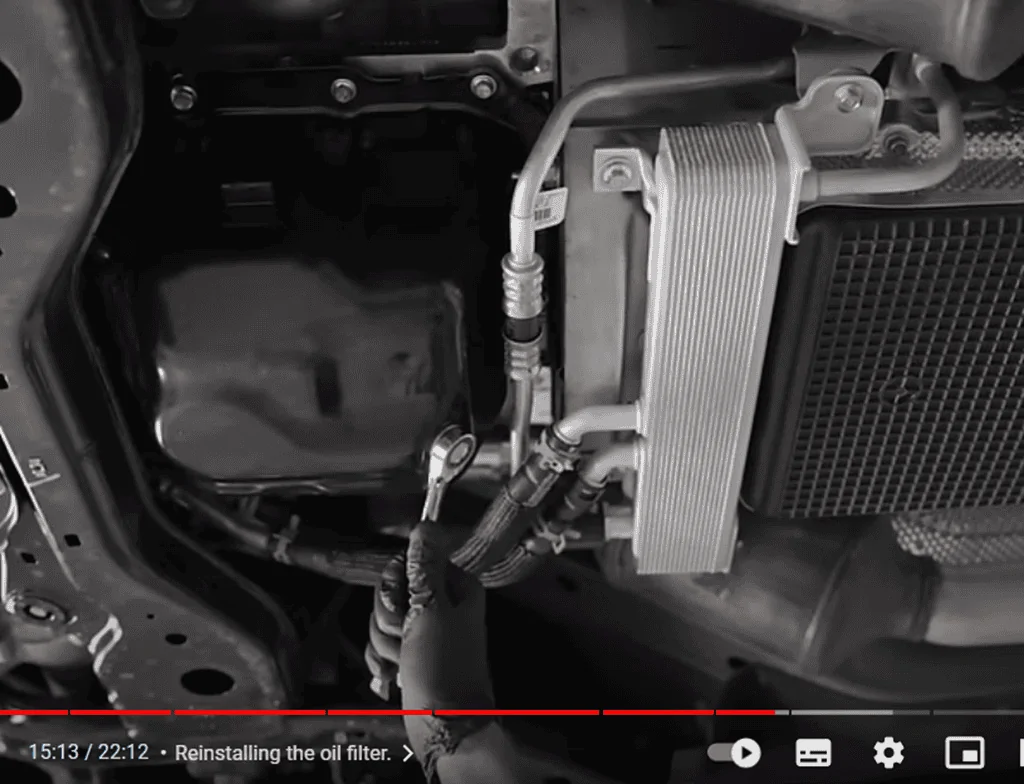

Larger MY24 GT Engine Oil Cooler - transversely mounted behind new metal Sump. It is also near the hot Cats, although it is now placed to catch cold air flow under the car.
This should be a big improvement over the hot engine-mounted set-up on all previous models (FM/FN).
S650 Mustang MY24 AU GT Differences 1704667300453-png
S650 Mustang MY24 AU GT Differences 1704704167795
