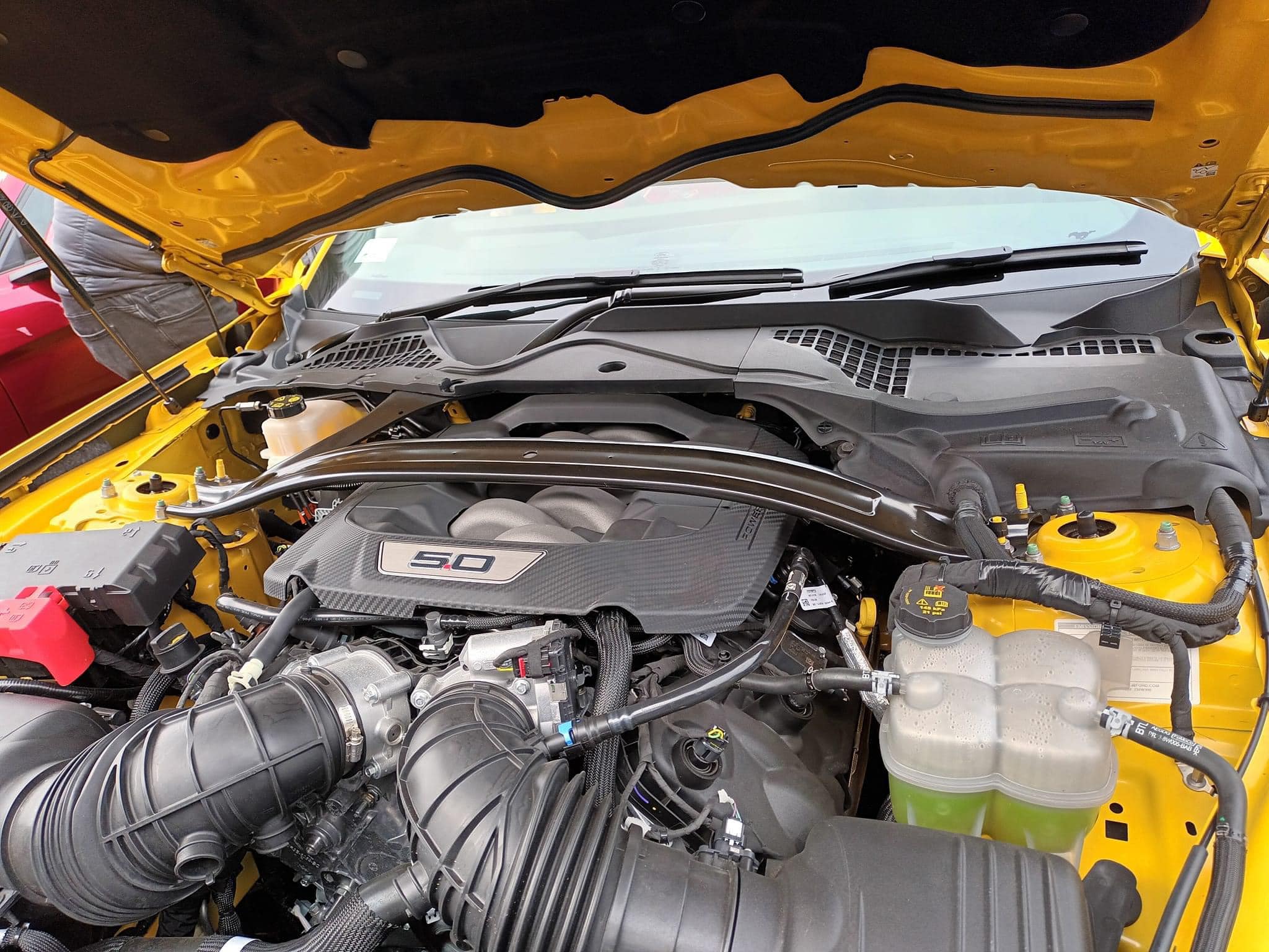

You may remember there was a RHD GT in Yellow Splash on display in Melbourne back in August.
S650 Mustang MY24 AU GT Differences YS-RHD-50
My eyes immediately went to the strut tower brace, but it looks like this never made the cut for the AU specification.
Not surprised, just disappointed, considering the extortionate MLP (Manufacturer's List Price).

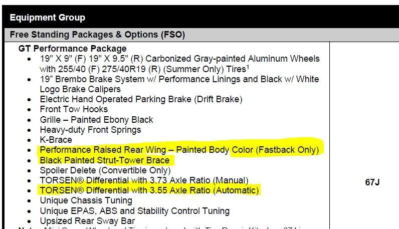

And, as a bonus slap in the MLP face, AU also gets the mandatory Torsen diff and rear wing spoiler "delete". :frown:
S650 Mustang MY24 AU GT Differences Capture3
I'm not sure about the K-Brace, upsized sway bar, or front springs.

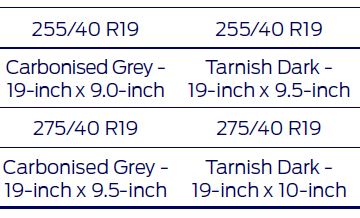

Wheels - weren't the standard S550 GT wheels black?
GT gets Carbonised grey (notice they changed the 'Merican Z to S and A to an E!)
