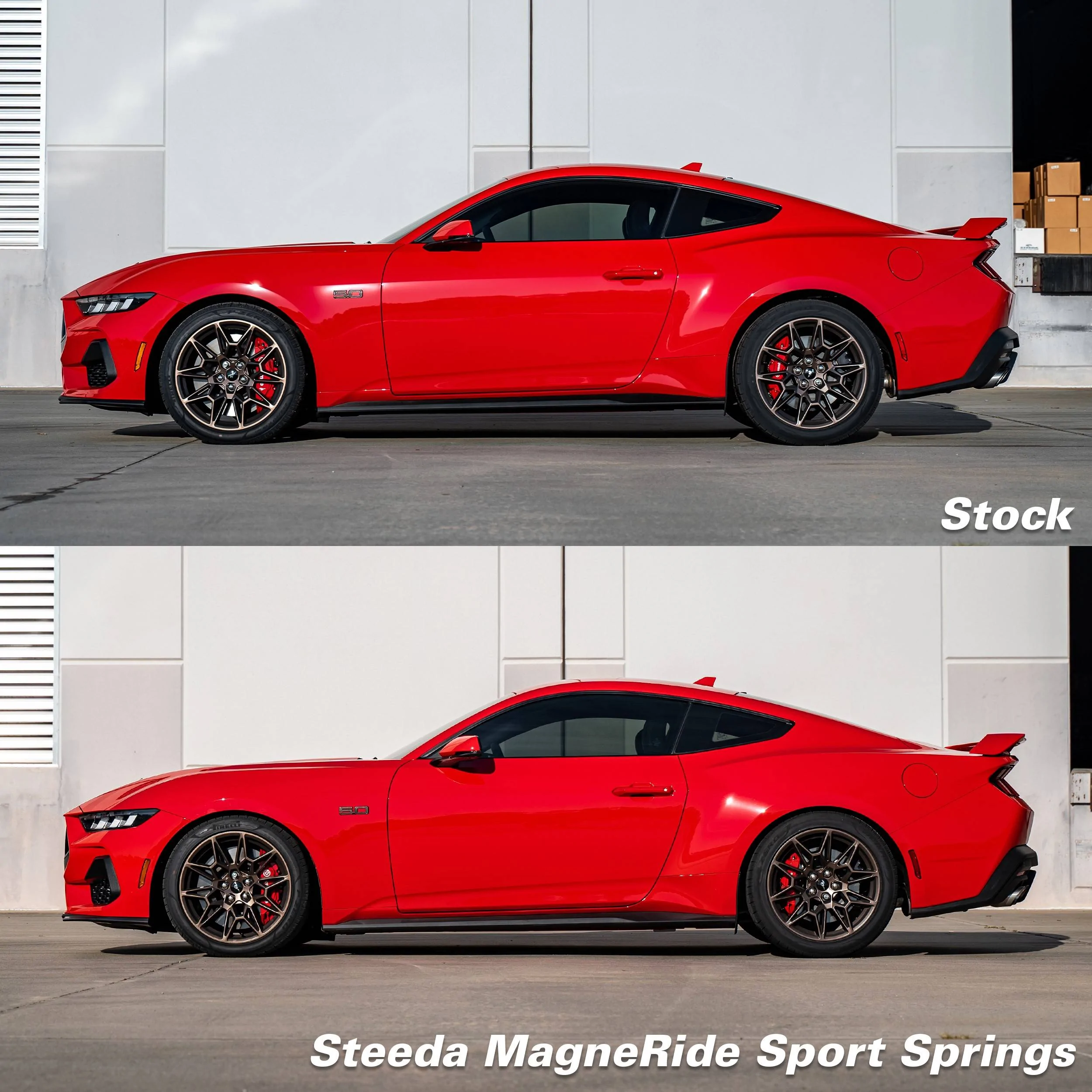

We need:
A proper side view picture:
Taken from far away as to not have a fish eye look and from approx the vertical height of the head when you are sitting inside the car.
By that, the stance can be seen best.
And always steering straight.
Like so:
S650 Mustang Mustang GT - Lowered with Velgens 555-8242-2
You need:
Have your dealer reset the MagneRide to the new "base level".
Right now the software might have the dampers actively unnecessarily too stiff.
