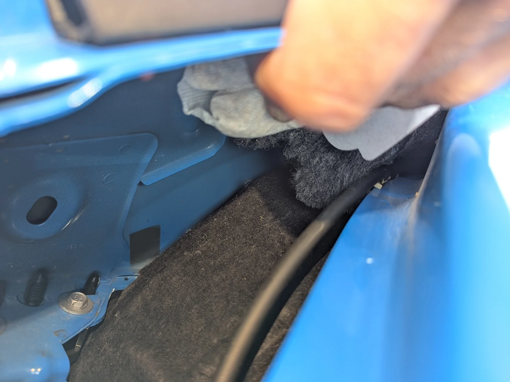

thank you guys for the info. you'd be surprised. Google searching and YouTube there's not a lot out there as far as the duct work path for the at s550 s650. I was trying to snake a vacuum hose in there from the air inlet before pulling the cabin air filter, just in case they were on top of it. anyway I don't think that they made it into the car as of yet. pulled the cabin air filter and put a small mechanics mirror and light inside. looks pretty clear and no signs of damage in there. picture attached of the stuffing / dampening material over fender liner. looks like they're climbing from the front up over the fender liner so I might pull that liner the next time I've got it up on stands just to put it to rest. picked up a tub of mouse and rat repellent at tractor supply along with four packs of cab fresh. coated the entire floor of the shed with pellets which smell like cinnamon nutmeg and used the cab fresh, two in the engine bay (you can see me holding that up out of the way in the picture) and two in the kick panels of the car. cab fresh is kind of cedar pine. so it's like Christmas all the time now and the new car smell I was trying to hang on to... gone😁
S650 Mustang mice in hvac??? 1000002620
