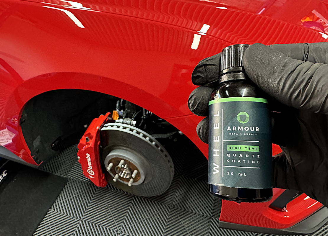

Matte finishes are a nightmare. Because they lack a traditional clearcoat, which acts as barrier to brake dust and grime, the finish is somewhat porous. That means its extremely difficult to remove contamination, even with strong wheel cleaners and brushes.
A ceramic coating is a must, but not the complete solution you'd hope for. Again, the porous nature causes the finish to inhale the coating rather than being a full barrier to dirt, brake dust and road grime. So, most certainly apply a coating, but be aware of what you'll achieve.
On my matte Ford Performance wheels, I have them ceramic coated with Armour Detail Supply Wheel Coating. Don't mess with alternatives, this is THE wheel coating to use for longevity, slickness and water behavior. Most wheel coatings lack slickness and extreme water beading, the tradeoff for heat and abrasion resistance, which with the durability is the reason why I like this coating so much.
Armour Wheel Coating – Armour Detail Supply
Armour Detail - Wheel Coating | The Rag Company
On used wheels, you'll want to remove them from the car, then clean with an iron remover wheel cleaner. Do the calipers at the same time. On the wheels, you'll want to clay them, but be careful on the calipers, especially around the Brembo decals. Fully dry, then wipe down with a panel prep (I do that twice to be thorough).
Armour Detail - Panel Prep | The Rag Company
Applying the coating, it'll go on a little sticky but will transform to a slick surface on the wipe off. You'll find the wheels will soak up a lot of coating, which is why its highly recommended to apply a second layer on matte finishes. The second layer can go on 1 hour after the first.
On mine, I did two layers on the wheels and one on the calipers, using every last drop of the 30ml bottle.
S650 Mustang Matte Wheel and Painted Caliper Cleaning IMG-2464
I know that coating is more expensive than alternatives, but its slicker, sheds contamination easier, and lasts longer.
