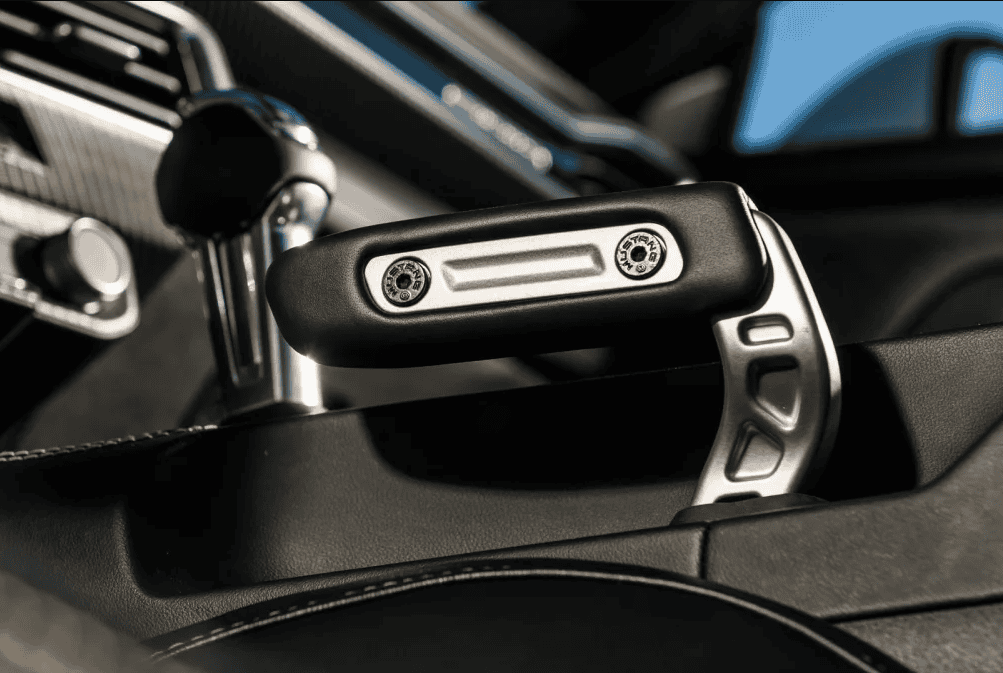

I believe many ordered a GT without the PP as I did.
OEM PP - $4995
  • Brakes: The Brembo brake upgrade is good value for money, but I wasn't sure of the rest. I am certain I'll never need a "drift" brake.
