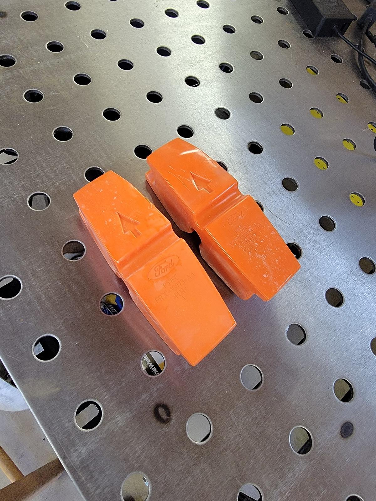

Look what I found!
Sf22giants
Oct 25, 2023
194
254
I looked and was only able to identify front suspension blocks. I did not see any rear blocks on my car.

So when removed, does this affect the ride height or ride in general? Just asking even though they are made of plastic. I already had the 1st Oil Change but did not know about these spacers. Will look this evening when I get off.

I noticed the car settled down slightly, since the springs were allowed to compress as intended. The ride was less stiff, as well. I suppose some people might enjoy the stiffer ride but you have to consider the springs aren't compressing completely as they go up and down. As you're driving, the car basically forces the spring to squish down until the spring hits the blocks... and then stops everything. When hitting bumps, potholes, or just driving hard, those blocks become a significant hazard.
It's a shame so many of us had to "find" them and remove them ourselves. I'm not surprised, just disappointed, really.

Are only folks with DH's finding these on their cars? Anyone with a GT or a GT w/PP find them at all? I'm not seeing them (at least in the front) on my non PP GT.

Good question. I just checked the Profile(s) of the members who commented and most are DH Owners. The few GT/GT PP comments were asking questions. I'm gonna be able to check here in about an hour.

When I took delivery of my GT that was the first thing I looked for. Didn't see them and I've checked again and every thing looks good. It does appear they didn't install my tow hooks, or at least that's what I think they are, I'll post a pic when i feel like it. I'm not really worried about that. They did leave my front bumper unmolested and didn't put a dealership sticker on my trunk so I'm golden.

Finally got off my butt and removed thr shipping spacers from the front coils springs. Can confirm none are installed on the rears.
Sincere thanks to my dealership for removing these before delivery ... NOT!
S650 Mustang Look what I found! 20240430_185150
