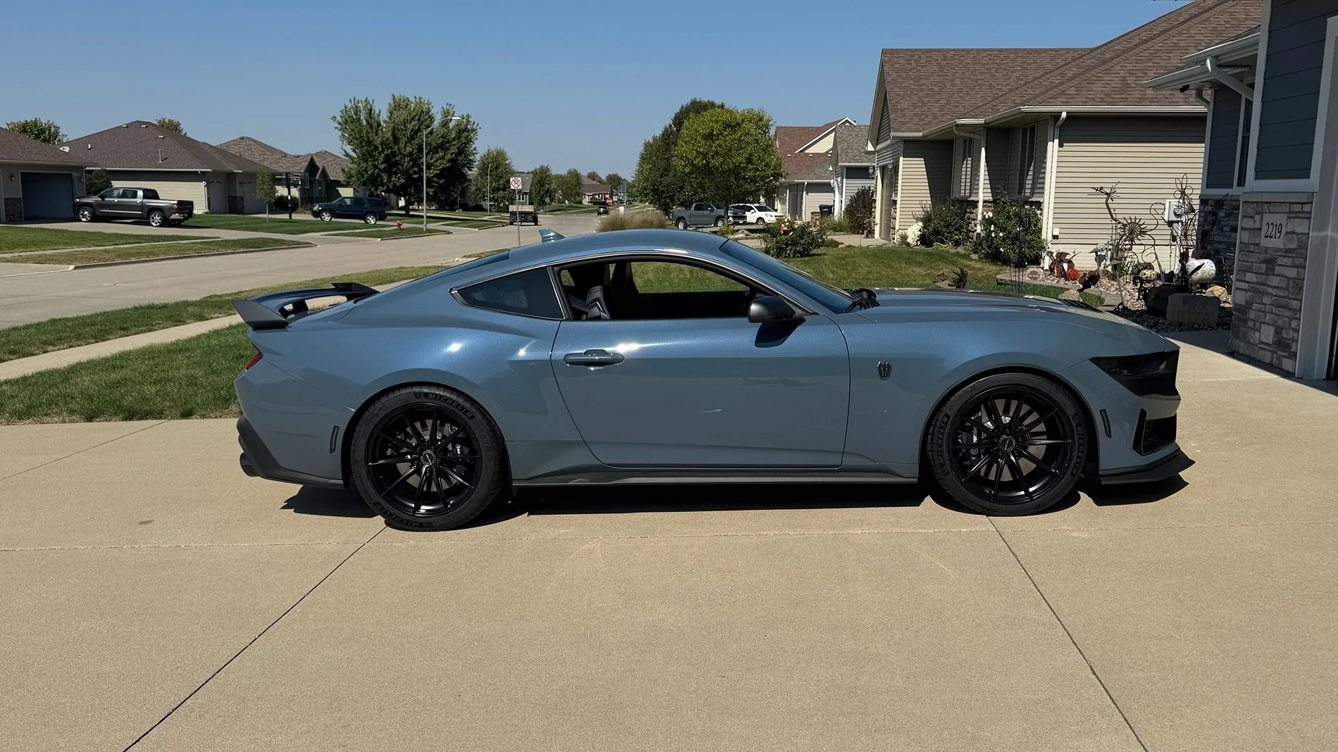

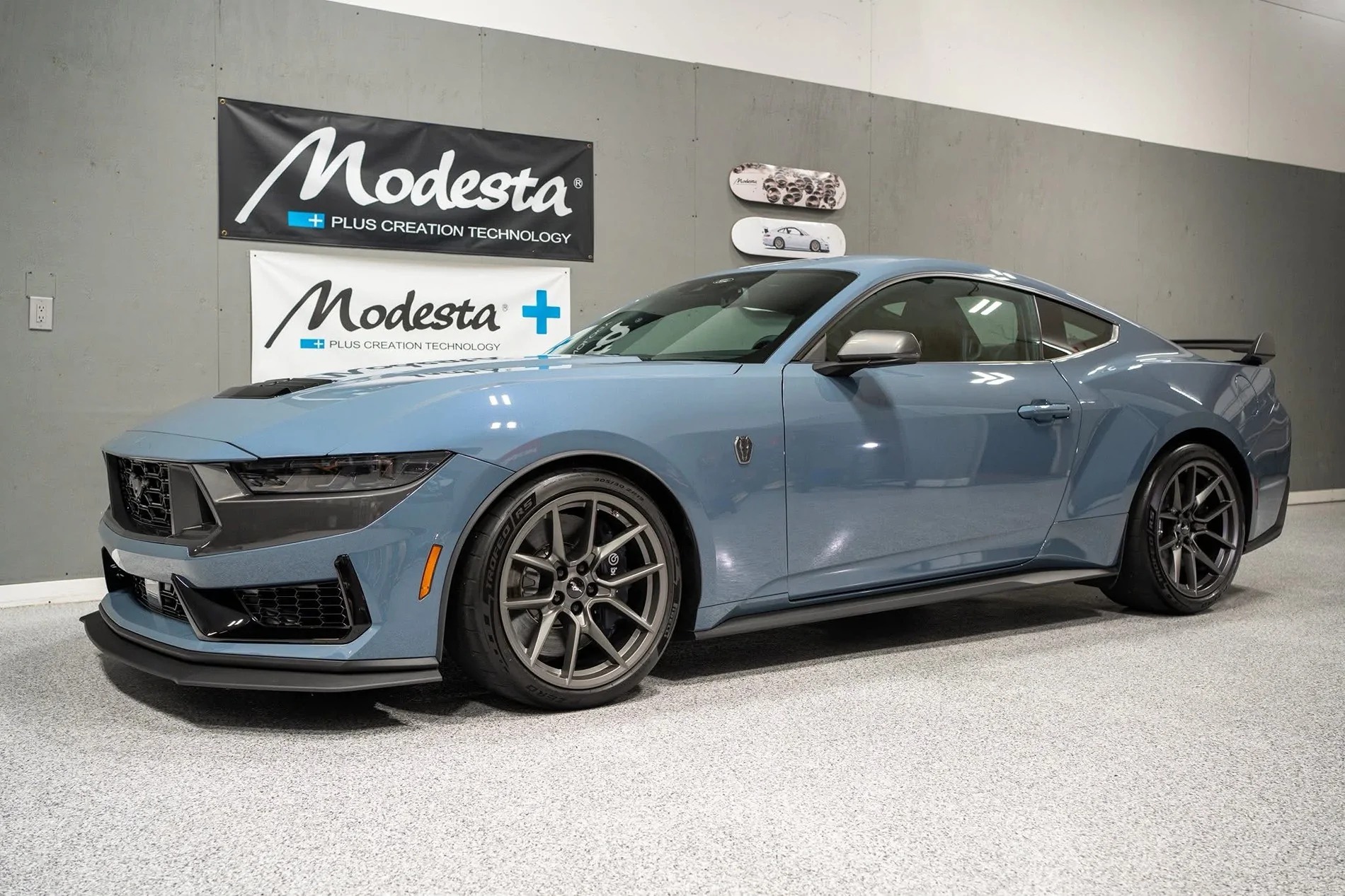

Looking at doing my Whipple Stage 2 install in the next couple of weeks. A few people I have been talking to are recommending going with LTH's and cats. I definitely will probably do cats. My question is around recommedation. Kooks, ARH, Stainless Works, and LTH. I am doing the Boundary Gears, KPM1000, ID1050-XDS, and UPR Catch cans. This is Manual DH so probably won't be doing much Drag Strip, but definitely a little road courses and some hard driving. I will also be doing a tune probably both E85 and 93.
Thanks

beautiful car btw đź‘€
