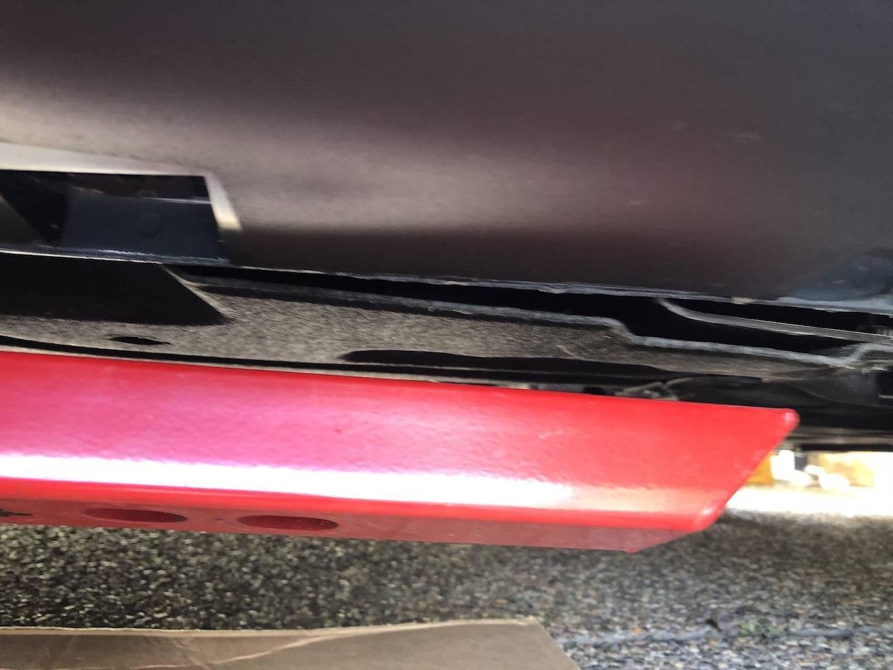

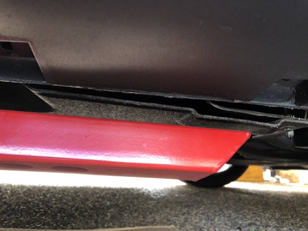

I didn’t cut anything. I put the jacking rails over the felt and it compressed it, only cutting out holes for the bolts. Also, the Steeda ones cleared the little screws, so I didn’t remove any of those.

I installed a set of BMR that came off my ‘19 and trimmed a small amount of the felt ..no issues and work perfectly

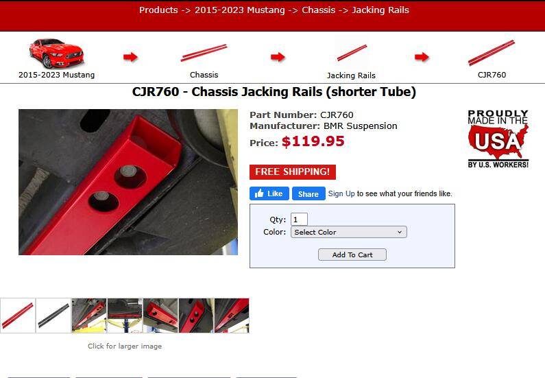

It appears the BMR ones I have are long chassis so I can’t install them on Dark Horse as they extend further than the install holes at front and in S650 or say Dark horse the front part is a bit elevated.
So I may have look into BMR short chassis or Steeda

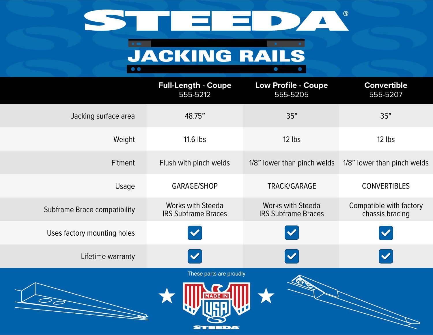

What are the differences between the 2 jacking rails you offer? I saw the video but couldn't really understand besides the weight and lenght.

Here are the differences:

So what are the pros and cons between full lenght and low profile?
I want a jacking rail but I can't choose.

If you are trying to make quick pit stops at the track, the 1/8’ lower that the 555-5205 sits might make your pit stops a couple of seconds quicker.
But the additional area for a jack stand that the 555-5212 has makes it more popular for most Mustang owners.
You can't go wrong with either one.

So, I ended up ordering BMR CJR760 short Chassis box jacking rails. I made sure the longer one as mentioned in the videos goes to Driver Side (Passenger side in AU) and shorter one to Passenger side (Driver side AU). I managed to install (Driver Side AU) but having trouble installing the (Passenger side AU) as it doesn't seem to be lining up properly for the rear bolt and has done a slight damage to the threads, not something serious. So i thought i should check BMR website and found that they are asking to remove and discard the Wheel Well Liner brackets as shown in the images.
