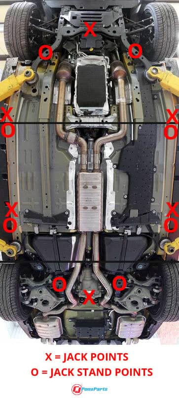

Jack it by the pumpkin or front subframe, and put the pucks/jacks on the pinch welds
So, I tried jacking up where the points are so that I could install the under-air passage fins that come with the performance pack. My issue is with the huge new cover under the engine at the front of the car, I could not see the jacking points. Furthermore, the jack stand areas, seemed to be right where you installed the under-air passage fins. Has anyone else come across this?

https://www.steeda.com/mustang-jacking-rails
Jacking rails can be a welcome addition to the car. I installed a set a few days after receiving my '22. The rails allow for jack and jack stand placement along the length of the rail.
