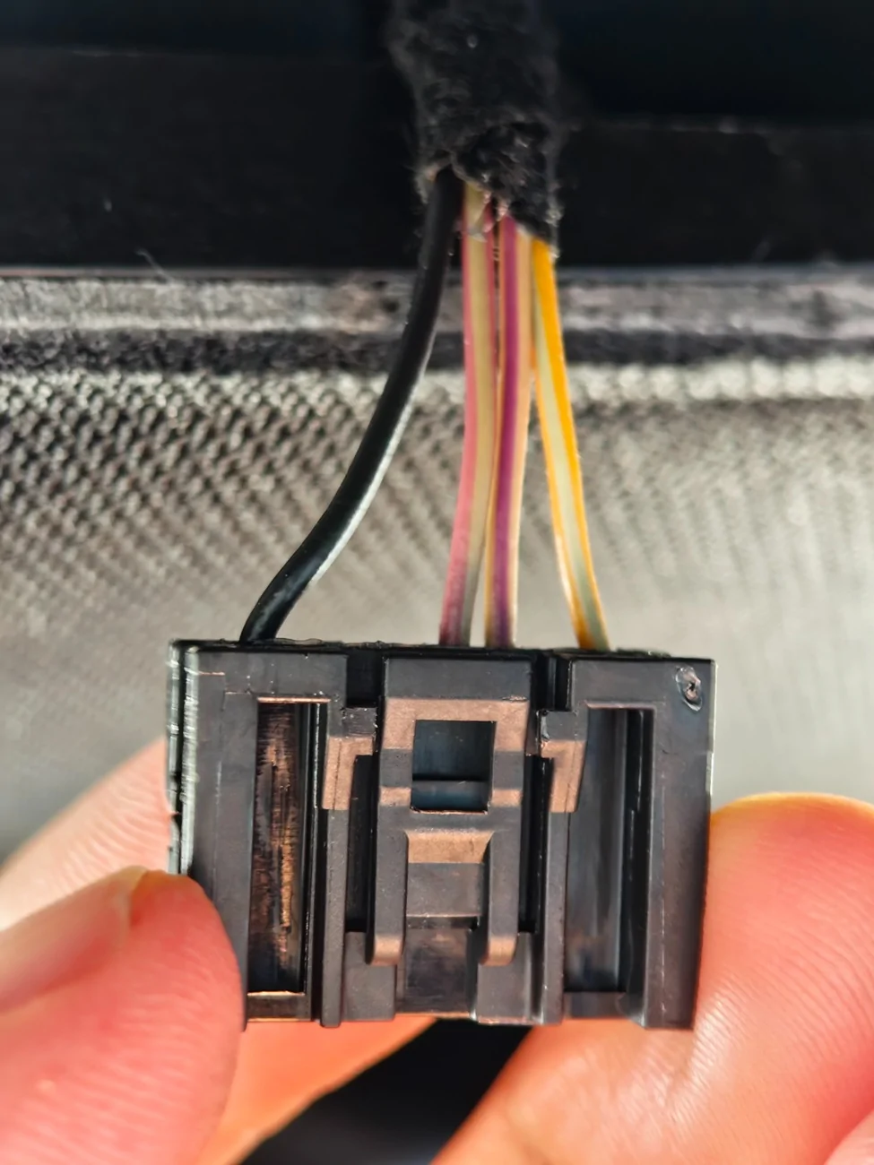

I took out the overhead console. Photo of the wiring attached. Didn't look damaged or anything.
It would be great to know on which wire the signal should come when the door is open.
I found a video that suggested to put a fuse on #1 on the passenger side. Did that too but it did no help.
