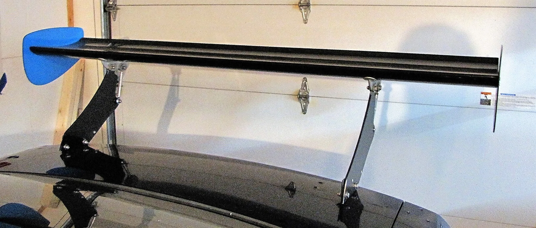

His most expensive rear wing is putting down between 500 and 1000 pounds of downforce at only 100 miles per hour. He recommends mounting it to the chassis, not a body panel or trunk lid.
It appears to be sucking up 30-60 horsepower at 100mph, too, though.
His splitters can come with custom tunnels increasing downforce, too.
And he tracks and competes with 2 (I think) S550 Mustangs (including a GT350).
